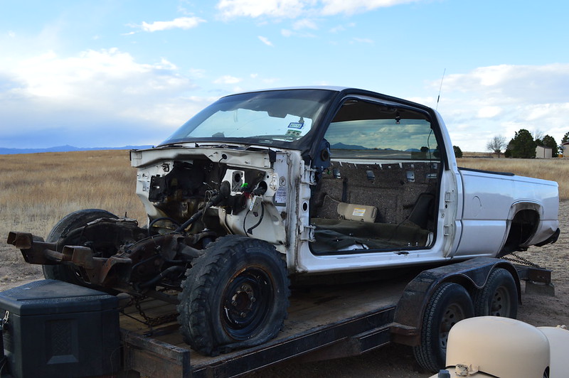

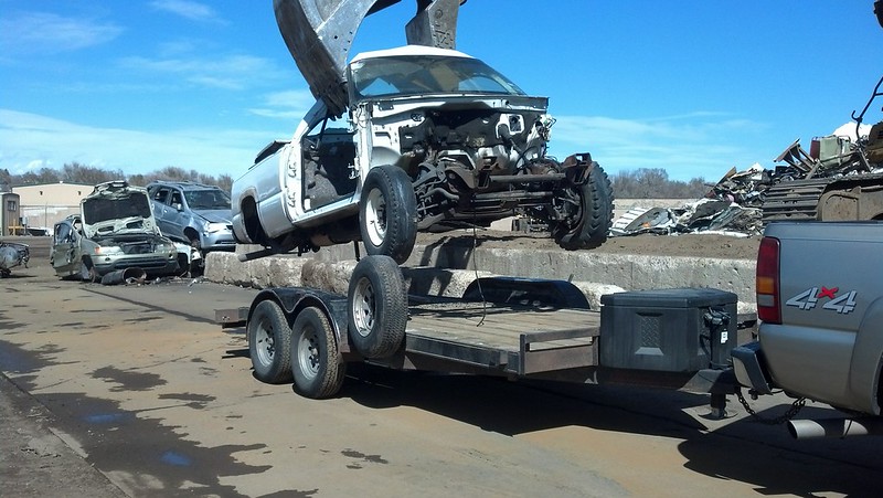

    That is a lot of miles, but I think I mentioned my company sold 1,242 2007 Model Year Workhorse chassis to UPS with 8.1L’s. Many of those now have well over 200K and 300K and still going strong.
    $2500 would be way too much for the engine but for the whole truck that isn’t too bad although I would try to do a little better on the price. For reference, a buddy and I scored this one last year for $1000 albeit it was 2wd with a 6.0L. We made a ton of money parting this thing out. This one had 368K on it. The 6.0L had a plugged up PCV and was blowing oil out of the dip stick. Planned on using the engine for a 4x4 Van project but my buddy abandon that project and sold the engine/4L80E (he has a difficult time staying focused on pretty much anything). The profit from this truck would have more than paid for the 6.0L swap and most of the van build costs. Ah, well. It was his build, not mine
    [​IMG]
    [​IMG]
    Wasn’t much left when we were done. Between selling every bit and piece I bet we quadrupled our money.

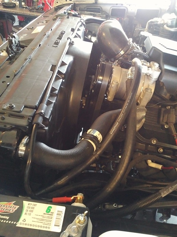

    I used a radiator from a mid 80's suburban with a 6.2 diesel (radiator and shroud). Used the same brackets that attach to the core support as what my TBI350 radiator was using, and just bolted it in. It's much larger than a 350 radiator, but is meant to fit in a square body. Just an FYI really
    I purchased the radiator and shroud together off ebay for a good price

    I would think so. What's nice about the square bodies core support is it has the "mounting" threaded wholes for both the small block radiators, or the big block/6.2 larger radiators. So you should be able to just pull out your small block radiator, drop in the larger one, and then use the exact same mounting brackets, just bolted into the other holes....at least that's what I did, worked just fine :waytogo:

    I then just went to the local parts store and purchased some "universal" radiator hoses that can be shaped and molded how you want, and hooked up the upper and lower hoses as I needed...that was easy peasy

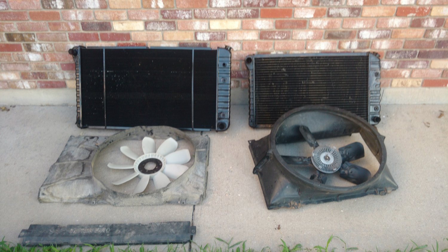

    Yep, exactly what I did. It’s all pretty well documented in my Polar Bear thread. The 8.1L swap starts on page 16 with the radiator details further down.
    The whole big diesel radiator has been talked about in many threads here over the past few months. Regarding an 8.1L swap, I honestly can’t remember what I used for an upper hose on my Polar Bear Suburban, but my spreadsheet says a Gates 20416 for a Silverado 8.1L application. I swore I changed it again a while after the 8.1L swap with a better fitting hose by just walking the isle at Napa to find one formed with the right bends then cut it to fit but that could have been the K10. I get the two confused. The lower hose is just a period correct BBC hose where I list I used a Napa 70752 for a 1990 R2500 Suburban 7.4L for the lower hose position.
    This is what a CU774 (81-91 Diesel radiator) radiator and shrouds look like. I have seen this in every 6.2L diesel truck I’ve ever laid eyes on including little 2wd half tons with diesels. In fact, my shroud, brackets and upper radiator cover came from a mid-80’s 2wd half-ton 6.2L diesel. I have also seen this big honking radiator in big block chassis cabs and a few crew cabs but not all big block squares came with this big radiator. The radiator is not equally proportioned as it is positioned further to the driver’s side than passenger’s side. The passenger’s side uses the same bracket holes as smaller radiators while the driver’s side uses the set that is closer to the fender.
    [​IMG]
    [​IMG]
    Zoomad also just had some pictures up in a radiator thread last week with comparo pictures of the big diesel radiator (CU774) pieces vs. the typical small block radiator and bits. You can see how the shroud is offset.
    [​IMG]
