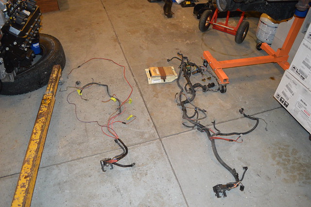

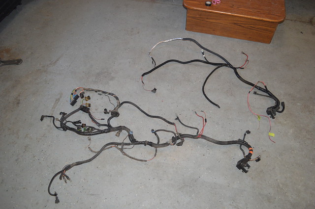

If your trucks had Feedback carburetors or TBI, the wiring that goes through the big round hole in the firewall towards the middle of the passenger’s side can all be removed. The main circuits you will need all come from the driver’s side pass through connector.
The picture below gives you an idea of how much BS can be cut out of a feedback carburetor or TBI harness to keep only what you need. Luckily, on my Suburban swap I had an extra 1989 Suburban harness to chop up and still keep my OEM harness to sell with the TBI 5.7L that came out. This is a comparo between a stock TBI harness and a reworked/pruned harness. Word of advise, spend some money on a good factory GM wiring diagram for the year of your truck. Makes harness clean up so much easier knowing what you can safely cut out
After relooming
