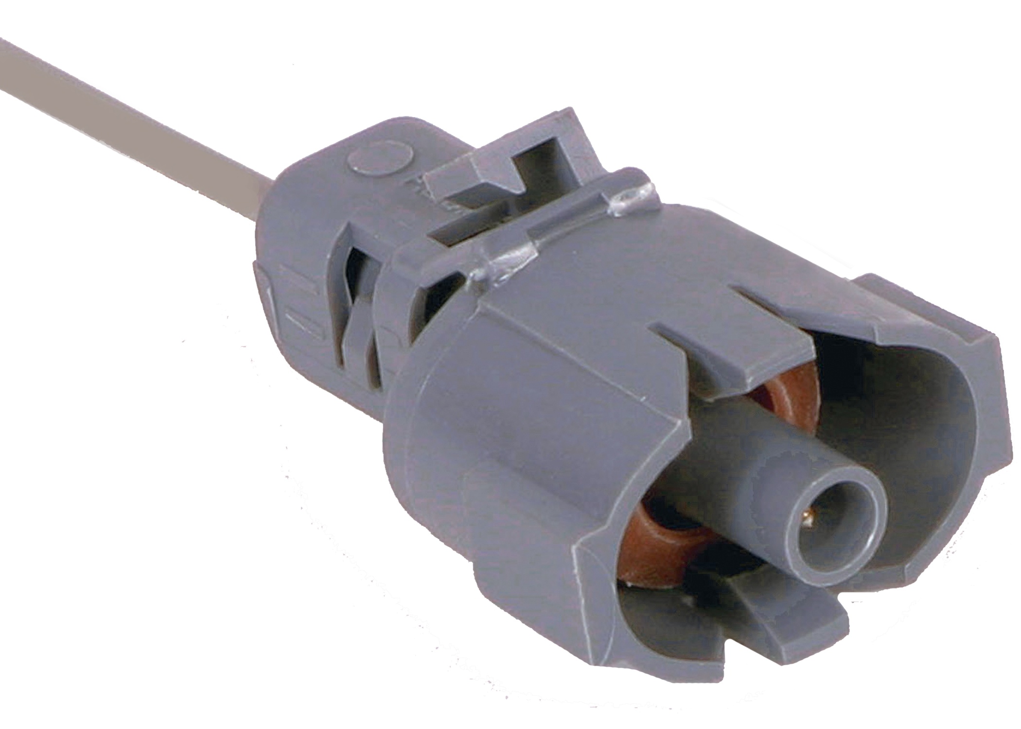

So i got the howell harness for my build and the only issues other than some odd lengths are the knock sensor plugs. Im usingvthe knock semsors you have listed but i cant locate a pigtail to fit them. Thr connections on the harness are a small two pin utilized only one pin. The semsotd are somewhat round but with a clip spuke to pne side. Noy the typical round style. Any ideas?
Picture of the connector on the harness or of the knock sensor?
This is the connector that is usually used:
https://www.rockauto.com/en/parts/acdelco,PT1428,knock+/+detonation+sensor+connector,13326
But it can be this one:
https://www.oreillyauto.com/detail/...l-a-c-compressor-connector/s550/5820198?pos=9
Took me a couple days to remember to take a pic with the rest of the tasks goin but here's the plug that came for my knock sensors @Larry @bigblock72
Yep, they gave you the wrong connector for the knock part numbers in this thread, or mislabed that truck of harness. Are you sure that is the knock sensor? Either you have to research what knock sensors fit that and hope they thread in the block, call them and tell them you need the round Knock sensor connector and they send it to you or cut them off and add a pair of PT308 connectors to match the 213-2829 (Pass) and 213-298 (Drivers) knock sensors, which is what I would do as I always felt their knock sensor leads were too short anyway. I routed the knock sensor wires over the front of the block on the Suburban to keep them out of the heat of the exhaust manifolds. On the K10, they route on the back side of the engine where they make me nervous how close to the exhaust manifolds they run.

If you are running the sensors Larry recommended then you will need the PT308 pigtails, which is the second pigtail that I linked and should be super easy to find.
The connector on your harness fits 08ish and newer LS motors, I have no idea why they would put them on a 8.1 harness.:dunno:
