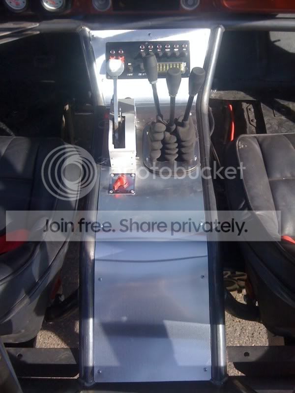

th400 round 6 style 205 with twin stick kit and i custom flush mounted plate in floor pan.
4l80-e with 241 adaptor on redrilled 203 range box and ord doubler kit and 205 twin sticker and shift rail mods. had to open up pass side floor hole a bit to fit up threw .

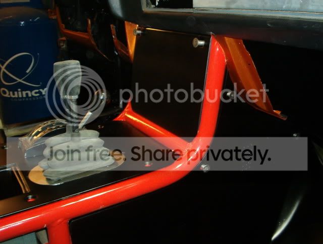

ORD triple stick ... Gen2 Doubler, rotated 1" or so IIRC, so the tranny tunnel is a custom job.
