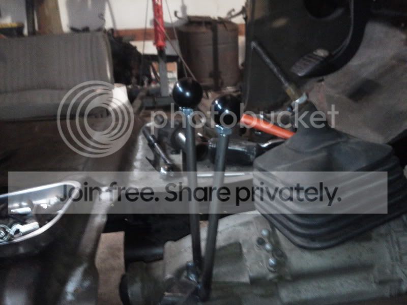

Another ORD setup...
...in a little different application.
http://i141.photobucket.com/albums/r48/K5Cruz/GMCshiftersclose.jpg
I ordered these twin sticks, I liked the stainless shafts with rod end linkages attaching to the factory pivot point on the adaptor, no one else has all those features. Made by JB fab, although most other stuff on my truck is either custom, ORD, or DIY4X.
I specifically asked for the 2nd bend in the lever because I like the tops of the knobs level. Also, they custom bent it to my dimensions so it would fit through the factory opening. Works very well, solid engagement and no rattle.

Those look great, I wish mine had a spread like that. I wanted hand grenade shifters, but there isnt any room with ORD's design.
Thanks, you could probably bend your levers to do the same if you heat them up or something.
That's the plan. Should have done it before I put them in the truck though.
