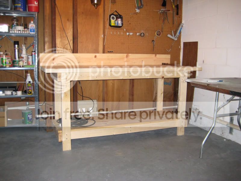

I got some wood today, gonna build a workbench soon. What do you guys have/use?
Right now I have two solid-core doors for the top. I'm gonna cut them to 26" wide and use the rest for shelving. I have some leftover weather treated structural 4x4 posts to use for the front legs... a 2x4 will run along the wall to support the back of the table top while a 2x6 will link the 4x4s together in the front. Toss in some 2x4s to box things in / triangulate and a sheet of steel for the top and I oughta be set. 13'+ of work space will be niiiiiice!
I'll add a nice storage shelf below the bench too. I was going to make the thing tall enough that a standard roll-away would fit under it... but I didn't want a work surface that was 44-ish inches tall. lol!
anyway, whatchu guys have in your man-space?
