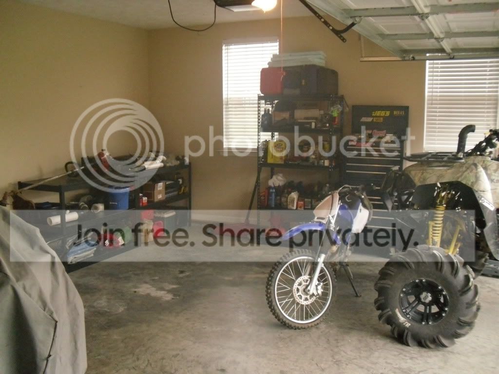

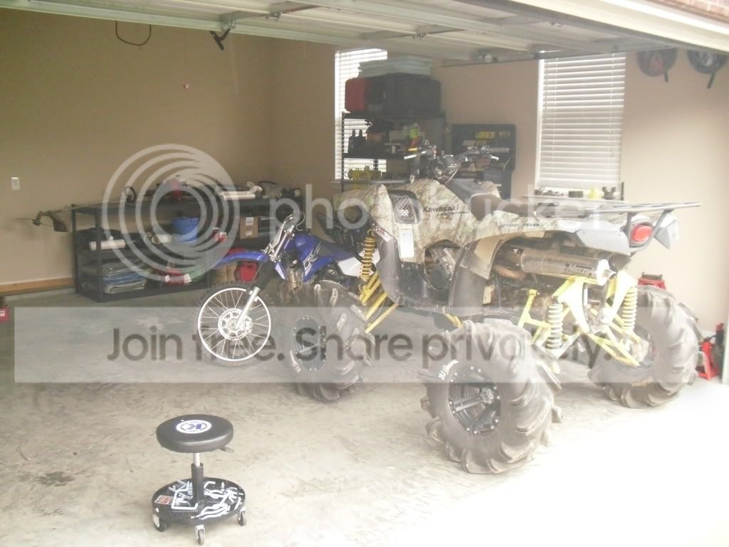

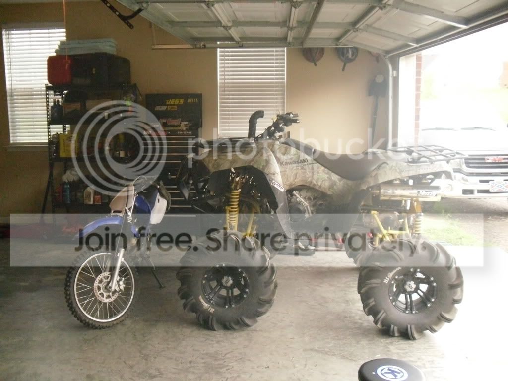

Bringing this back up to the top. I finally got back into a house and have talked the lil lady into me using half for my stuff! I picked up some shelfs from lowes...so here they are!

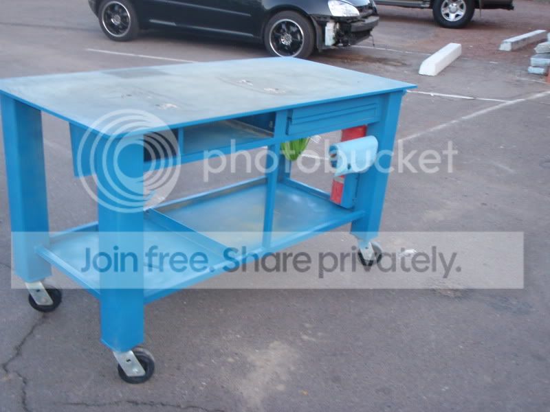

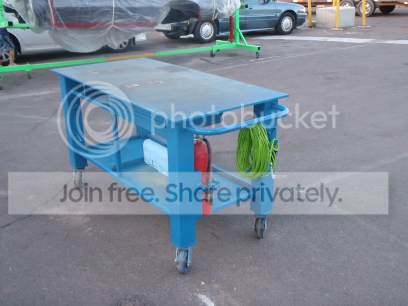

Been using mine for a while now.
1/2 inch top
4"x4" legs
spot for the welder and a plasma
angled slot to slide the grinder into
two drawers from a tool box
another slot for misc
10 lb fire exinguisher and hd mount:pimp:
hanger for helmet and shields
the drawers hold all my grinder disk, wheels, flap disk , glasses, drill bits, markers strait edges and gloves.
