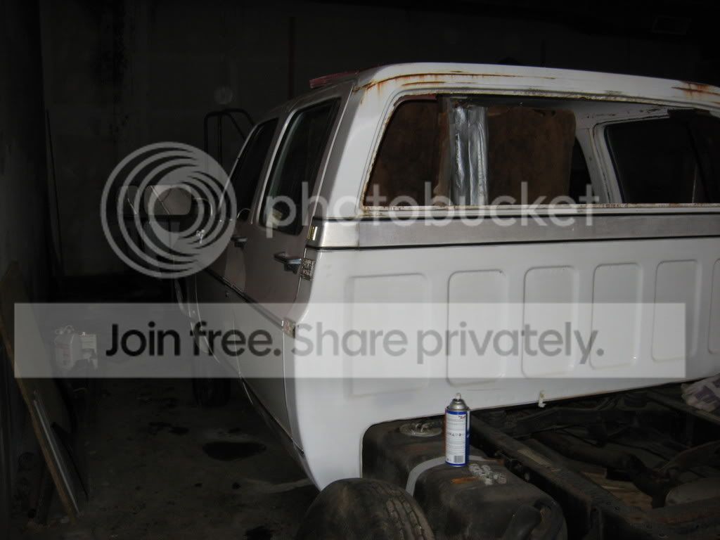

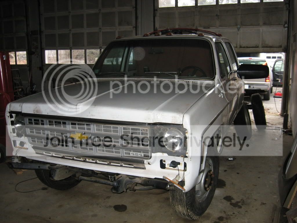

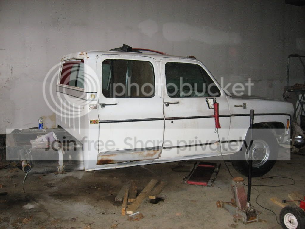

hung the doors, fenders and popped the hood on today.
ya, its in the back of the 2nd pic. Things mint, just a little surface rust from sittin for 8 years.

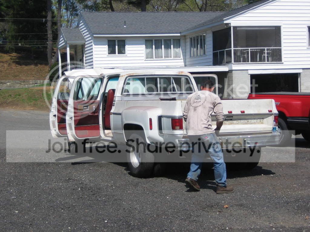

Damn just what I am looking for!!! I need that! Seriously if you change your plans shoot me a pm! I need a body for my 85 4wd crew cab dually and I love the round eye,i mean headlight.:D

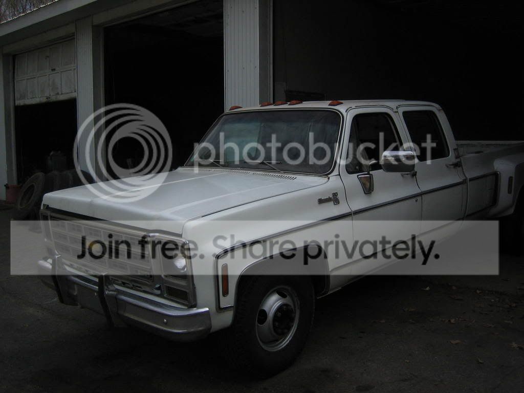

nice truck but 77s had the mustard colored trim pieces not the black ones.
Yup, the 1977 *model year* trucks had the yellow stripe on the trim. Assuming this trim is original.
I'm thinking this truck is a 1978 *model year* -- many states register older vehicles by date of manufacture, which for this one could easily have been *calendar year* 1977.
The kicker would be to decode the VIN ... but in the end, it's not all that important :deal:

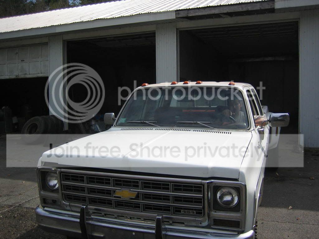

AND KEEP THE ROUND HEADLIGHTS! I do so love the 73-80 front clips and 73-77 grilles, particularly. Stock, the headlights suck, so you should prolly do the relay/heavy wiring thing and maybe put in some H3 or whatever conversions, but yeah, keep it as is...

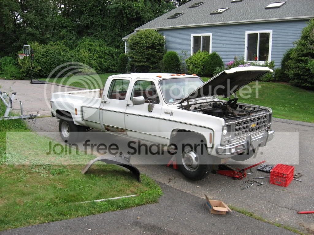

Got some more work done on the crew cab today.
Still have to fix a fuel delivery issue before I can drive it home.

Since the last post i have swapped in a new cam and popped on an edelbrock performer 750. Thing screams!

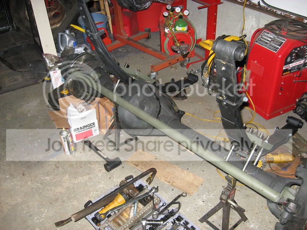

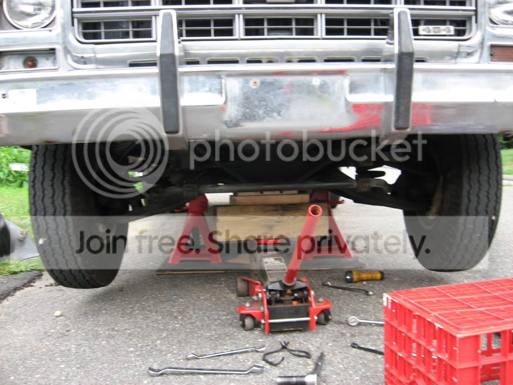

I have also been collecting parts for phase 1 of the 4WD swap...got some hangers from Kert, rebuilt a D60. So anyway...I ripped into the front end after work today. Almost got the whole 2WD assembly out before it got dark and started to rain. I'm gonna try and get this done all this weekend so I'll try and take a lot of pics.
