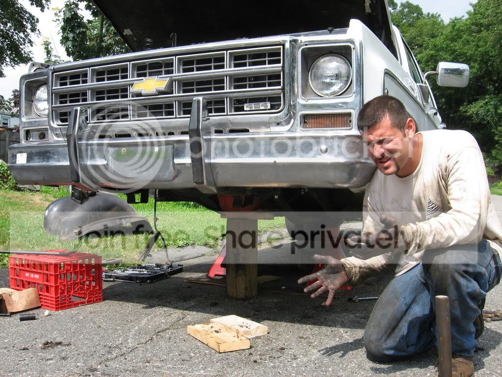

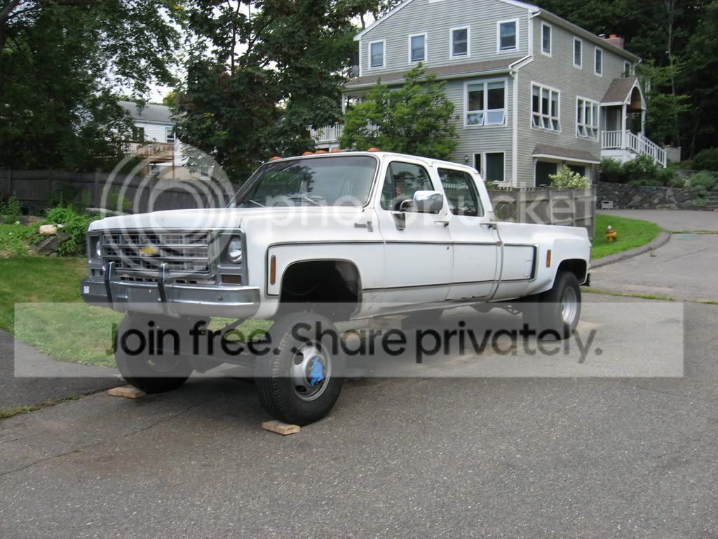

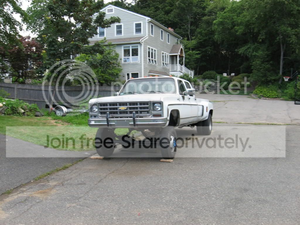

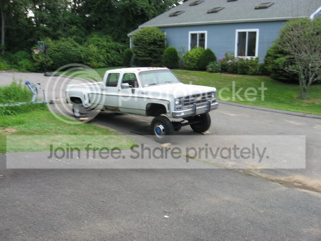

Lifted crew cab dually. C to K conversion.
your just gonna use a ford tcase right?
ps thats totally badass... love crew cabs
Your 1st pic made me wonder what a 6pak dullie w/a chopped pretty short bed would be like.. I love 2 door dullies but love the room in a 4door..That would be the best of both worlds for me.

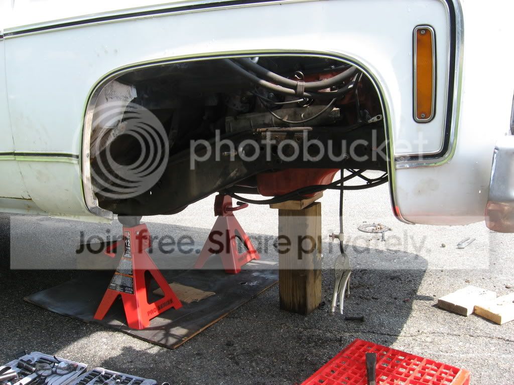

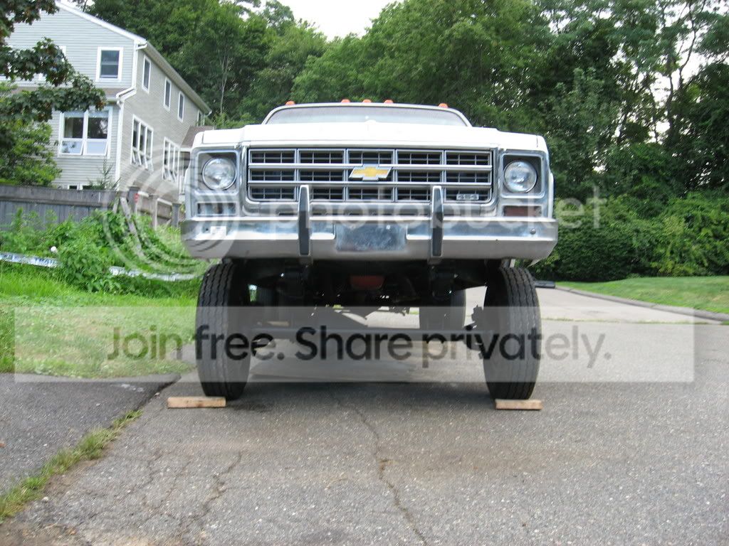

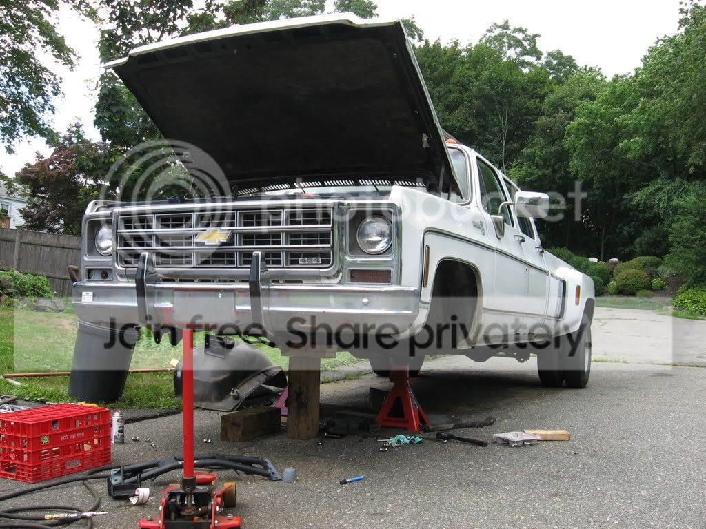

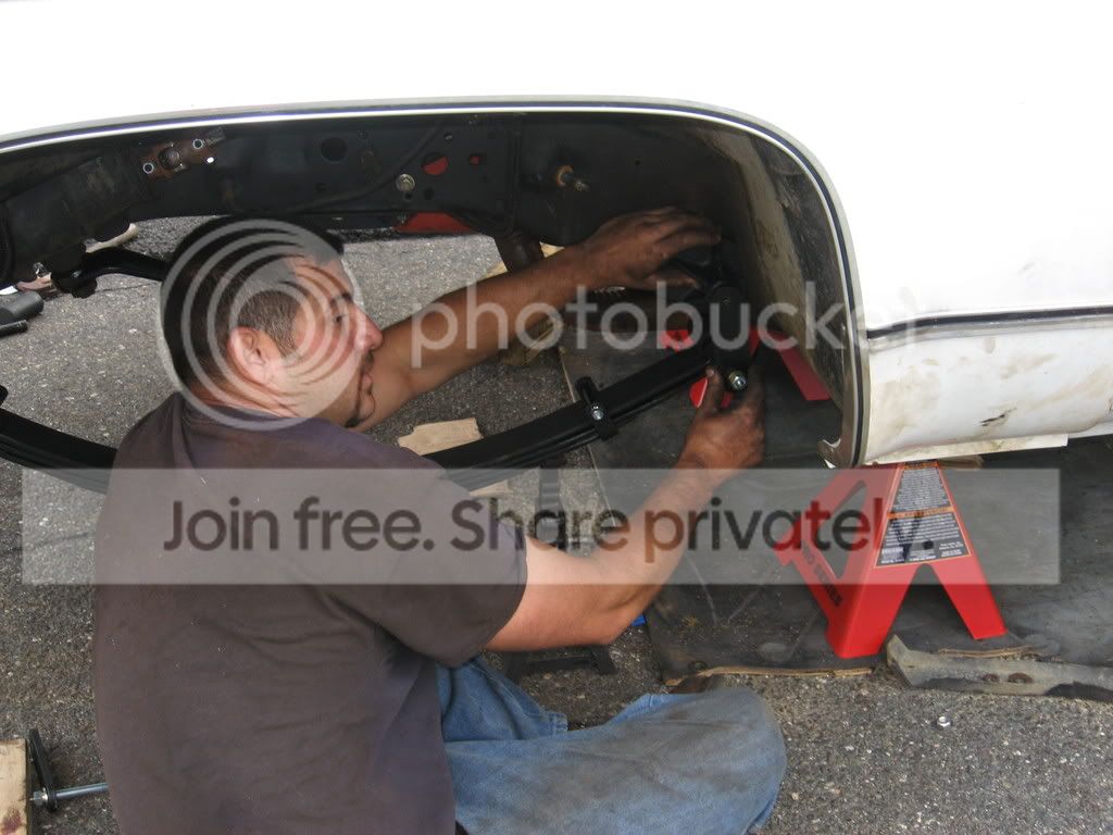

Today (saturday) I got the motor x-member in. Biggest PITA. Had to work my new intermediate mounts cause of framerail clearance...the usually this and that.
Gotta get that axle in tomorrow.

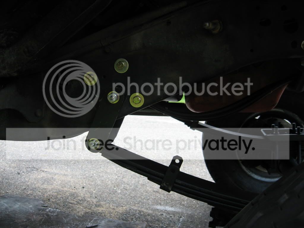

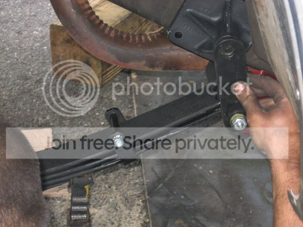

Tell me waht you guys think about the shackle angle in the last pics. The reason I am holding it there is because it lined up with a hole that is on both framerails...good reference if the shackle angle will work when weight is applied.
gotta love the low angle pics
Lookin' good Brian. Front pinion angles looks like it will work....
on to the rear

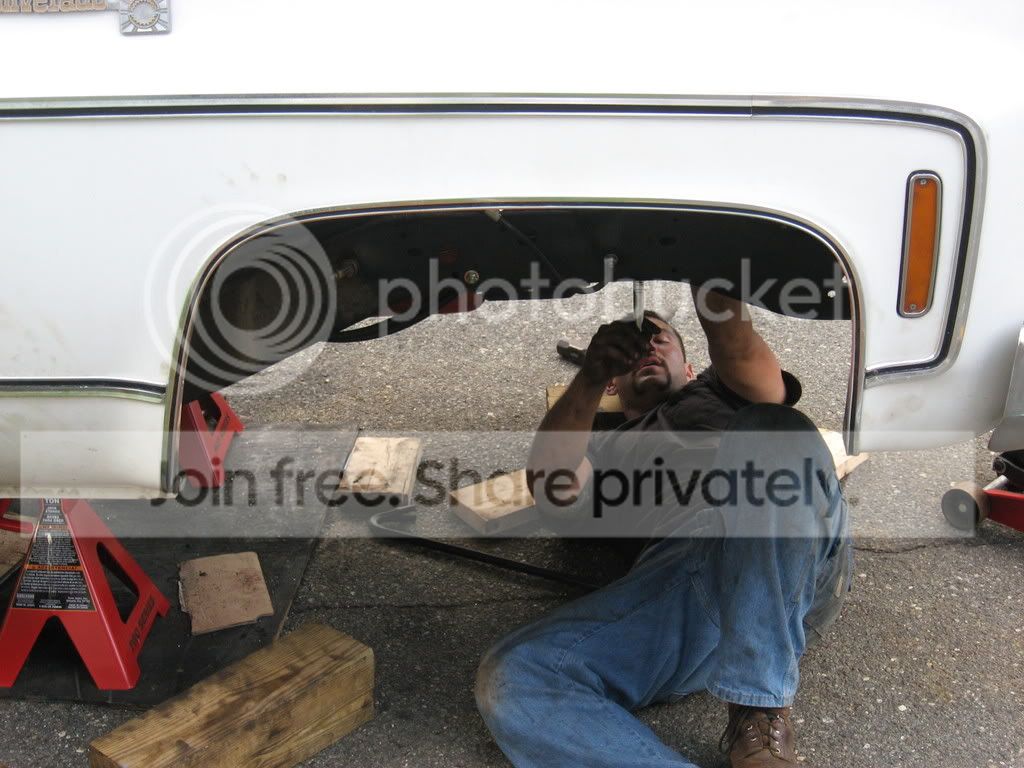

Got the axle in.
Shackle angles look goo with the weight on em. Only problem is that the spring wrap is making contact with the frame. I'm thinking when the back goes up and the truck levels off it will clear better.
