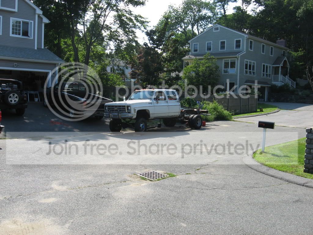

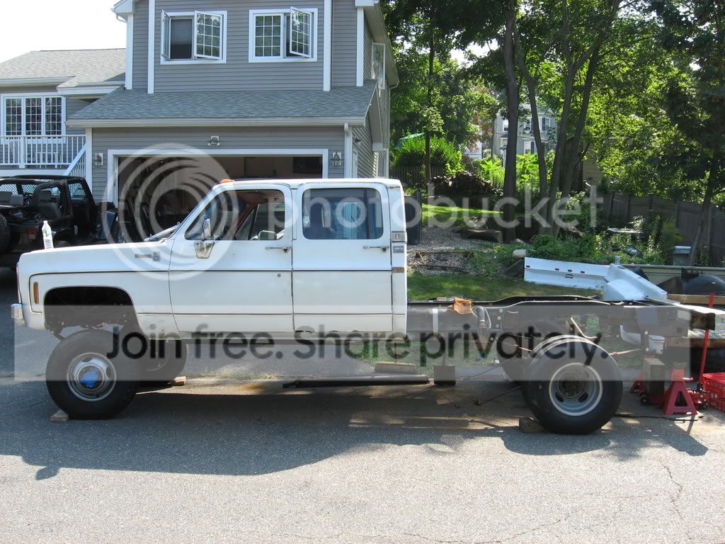

Lifted crew cab dually. C to K conversion.

Awesome!!!!! I freakin' love this build. Keep up the good work, man, and keep the pics flyin'.
your just gonna use a ford tcase right?
ps thats totally badass... love crew cabs

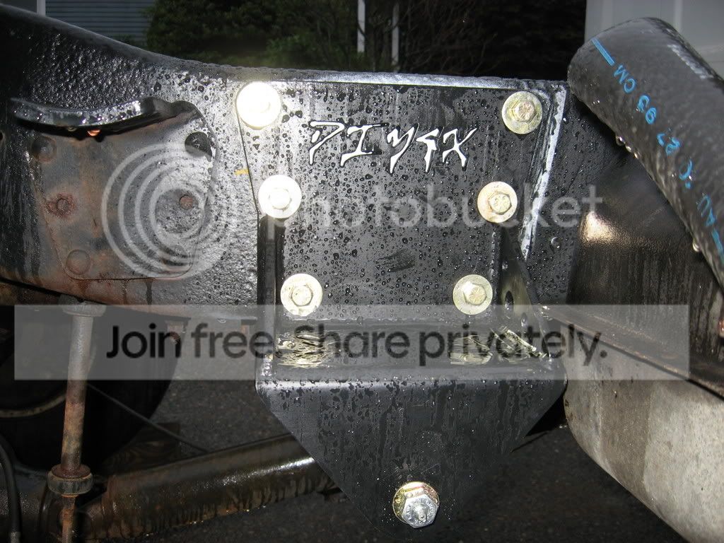

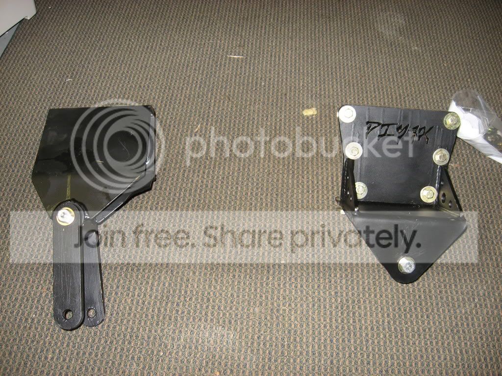

I'm glad you thought the shackle should have moved back a tad because I did move it back a bit from that picture.
I had KERT make me up some hangers just for that reason.

here are those hangers. gonna get em in this weekend

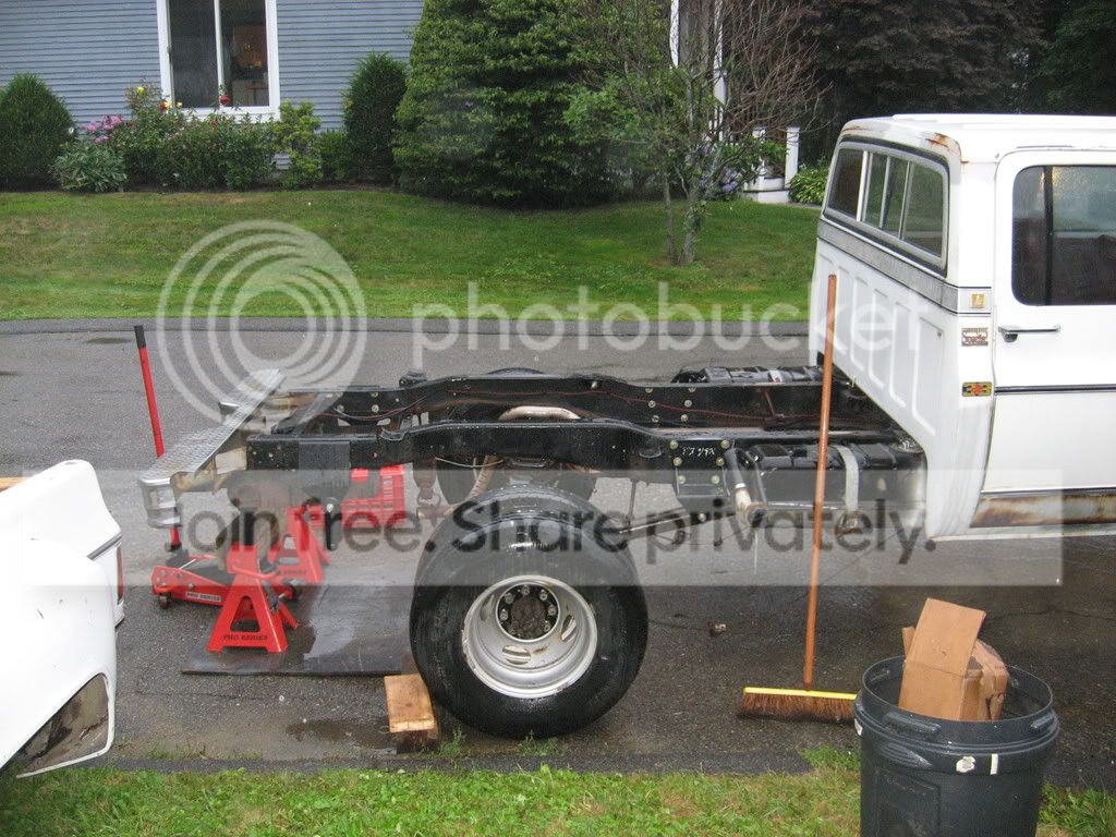

Bed off. Rear hangers in. Goddam Rain. I tried to paint white behind the forward rear hanger so KERTs logo would pop. Good idea, dont know how well it worked though.
D-shaft
Anyone got any idea what I am going to have to do with the d-shaft? REmember its still basically a lifted 2wd. I'm want to drive it around for a while until I do start phase II. I'm thinkin I may be able to get away with droppin the bearing support.??

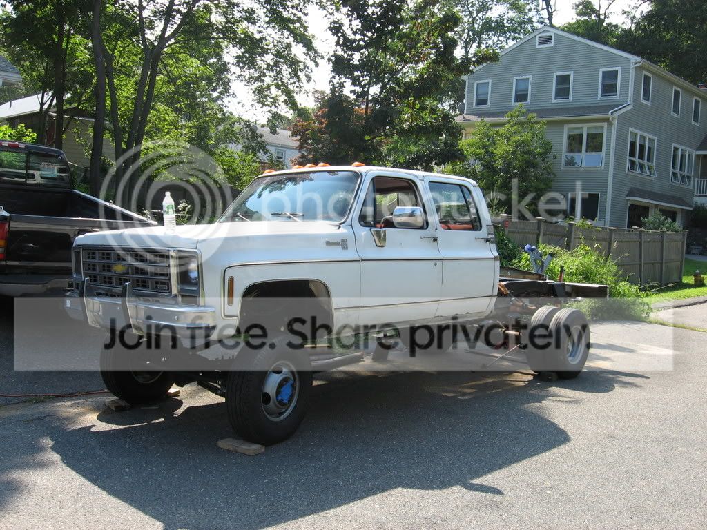

i think thats a 79 model grille, iirc it & 80(non silverado) are the only round lites that had the chrome grille around the turn signal
was 77 the only yr w/yellow trim, i thought they did that 2 yrs?
anyway ya put it, nice build..subscribed!

77 was the only year for yellow trim. and for the dshaft, why not just one long ass driveshaft?
