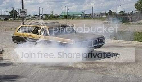

i had a 72 town&country wagon with a 440,stock 6pak cam, ported iron heads,torker intake,750 speed demon carb,1 3/4" primary tube headers, 2.5" exhaust with 2 chambers flowmasters,stock converter, 2.76 open diff and 295/50 radials that waxed my buddies 02 mustang regularly when it ran 14.1's at the track. im not concerned about the weight of my burban.
