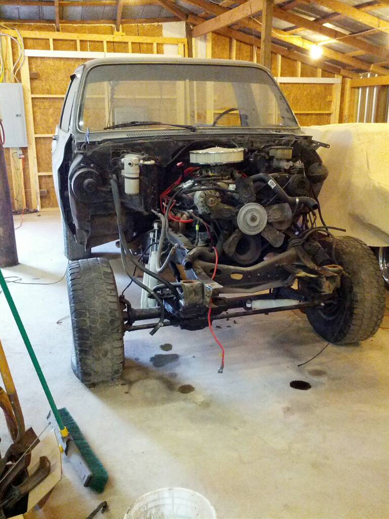

On another note I took the K5 to my body guy to start working on the metal and a few other things I need done, it looks like i'm bringing the frame back to my house later so I guess it's going to officially be a frame off build.

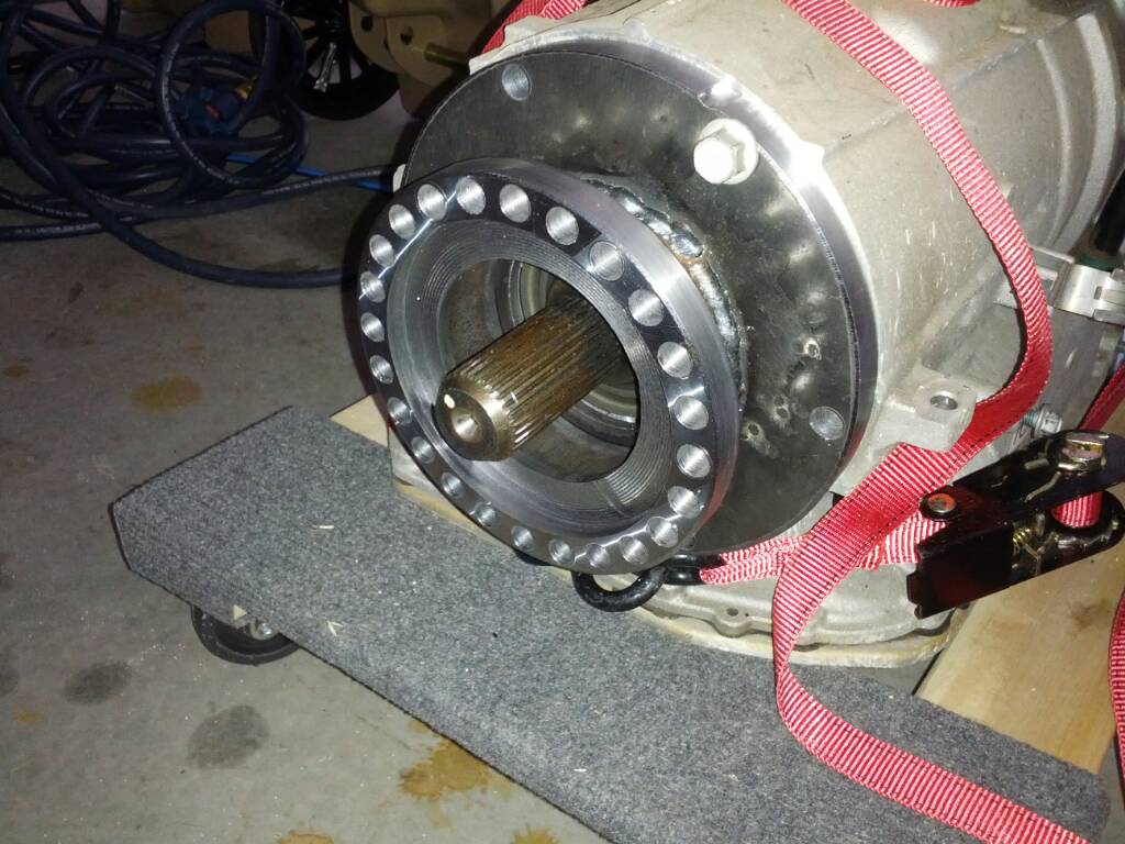

Also, my machine shop should have my 6L80E to NP205 adapter done this week. Pretty excited to see how that turns out.

I got the first prototype for my transmission to tcase adapter. It's fully clock able and allows for proper engagement.
After a few changes I'll have it done in aluminum.

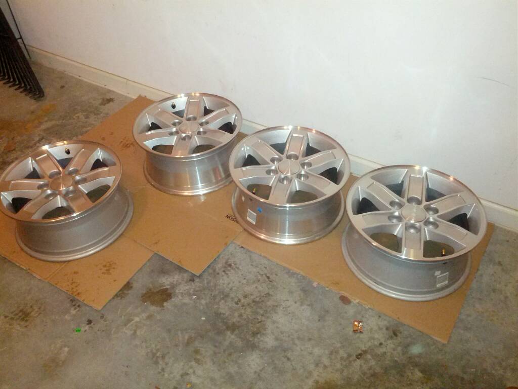

I'm still working on the stupid adapter but here are some new wheels I bought today.
They came off a 2013 Sierra after 20 miles. Dealership sold them to me for 400. I'm a happy camper. Looks like I'll be going 35x12.5 or possibly 37s
That for the K5?
How will you fit them over the front hubs?
Meanwhile they have a lot more backspacing than the stock rims.
I was planning on the wheel spacers. I'm having my hubs measured at the body shop I should know something soon.
3.5" hub diameter... 3.25" wheel inner hub diameter.
Doh!! $%&$%&
Anyone want to buy some nice wheels?
Interesting. I just figured since they make alum wheels that fit over our hubs with that same bolt pattern, it would be the same.
Why don't you get some nice rallies or something? Idk, the newer wheels just seem so wrong

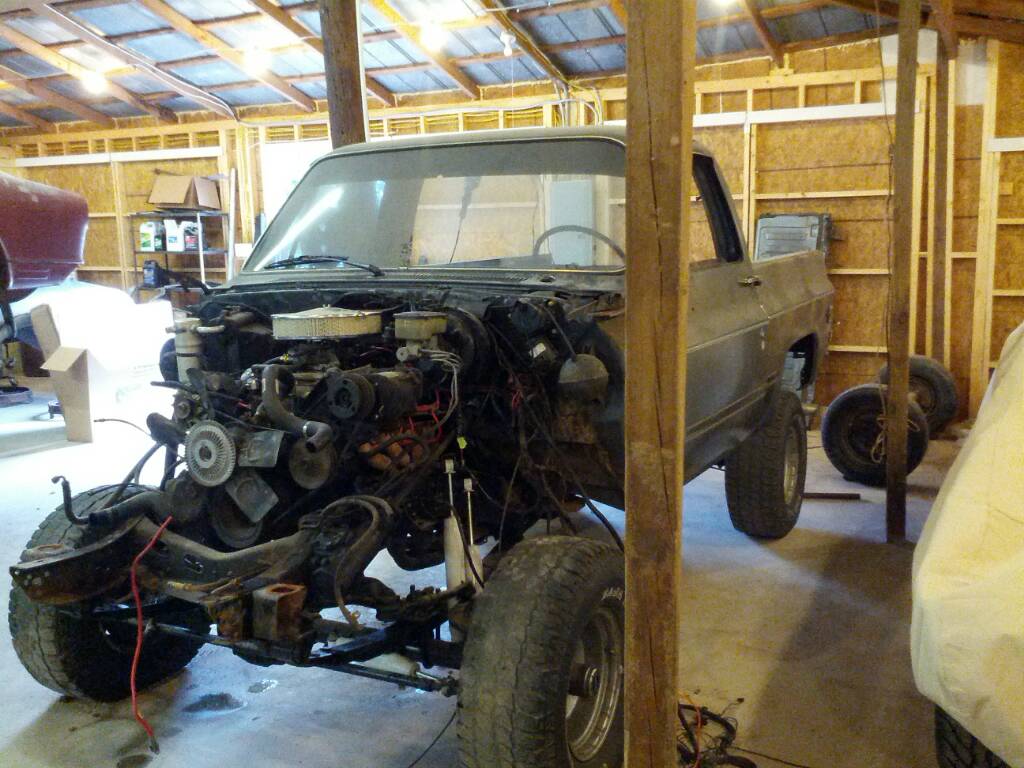

I stopped by the body shop today. They've got it torn down pretty good. Body comes off the frame tomorrow and off to the powder coater after some additions from ord.
Oh and I sold the big block/turbo400/np208 to a guy at the shop so they'll take it out tomorrow as well.
