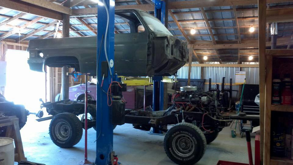

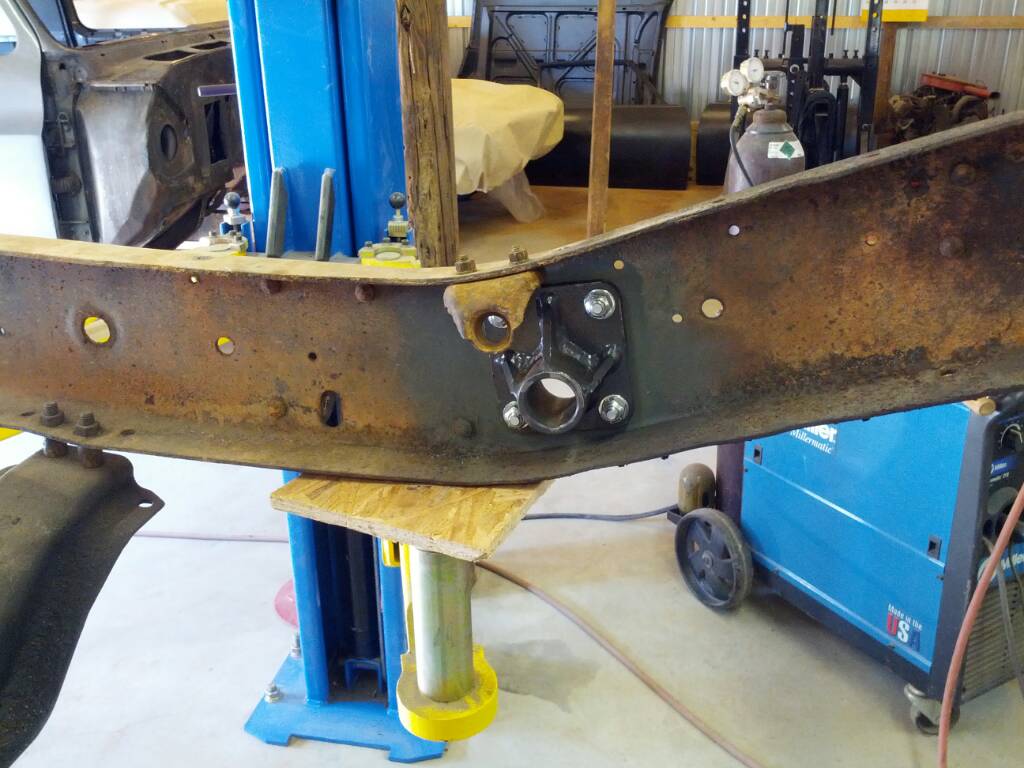

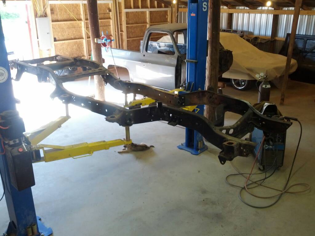

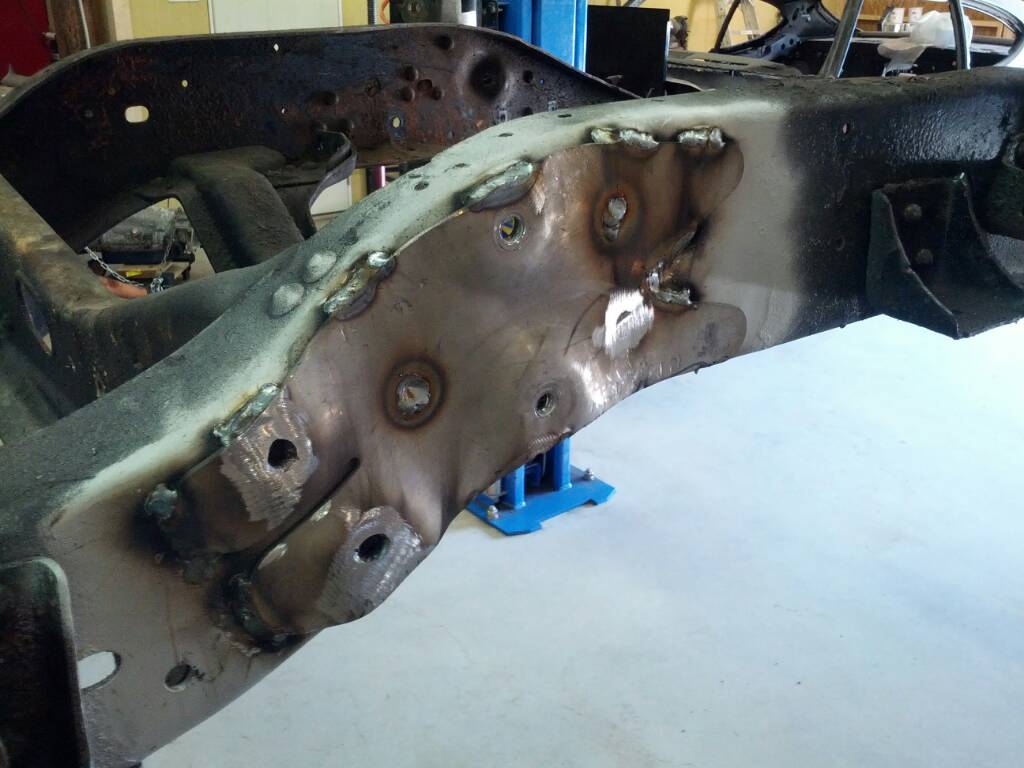

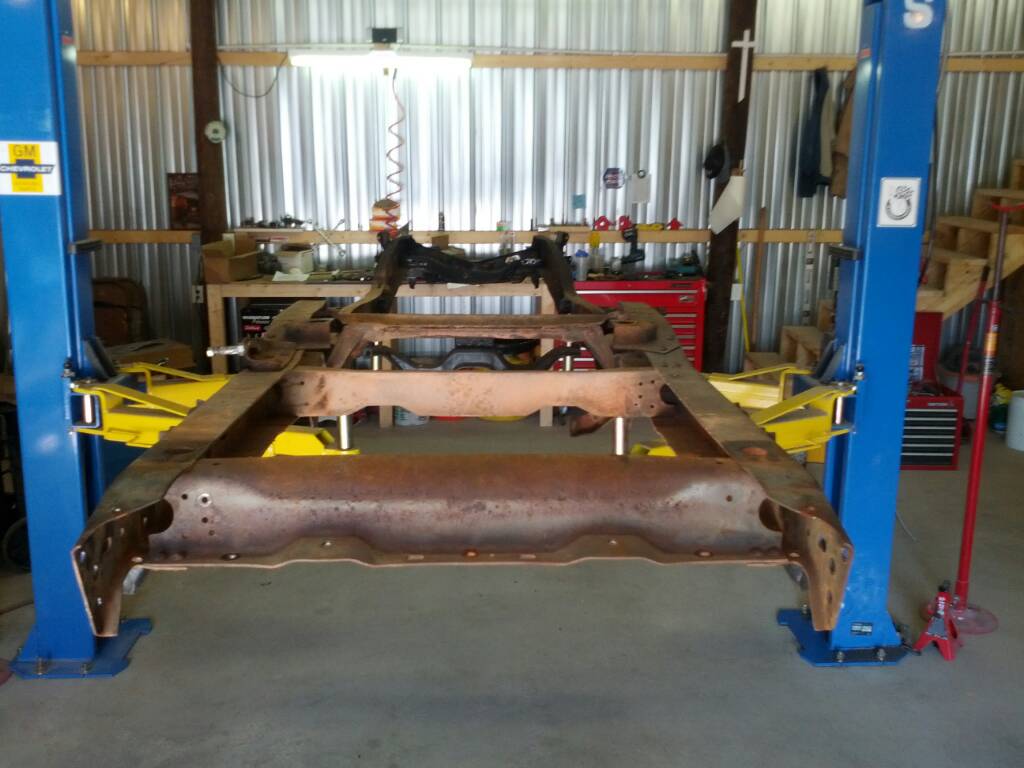

Went back to the shop and they have the frame completely stripped now. They also installed the ord front shackle bushing kit, steering support bracket and steering box reinforcement.
I called ORD and ordered a full set of their custom springs, HD front and rear shackles and the front knuckles for the cross over steering.
I went with 6" full springs front and rear with no extra shackle length. What are you thought on using no shackle?
Sorry I meant no Shackle flip. Instead of doing a 4" Shackle Flip and 2" spring I did a straight 6" spring with factory shackle.

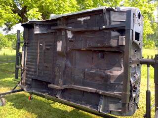

My body guy didn't feel comfortable reusing the 28 year old undercoating so we stuck it on a rotisserie. Once the undercoating is off I'll have the underside coated in polyurea.
