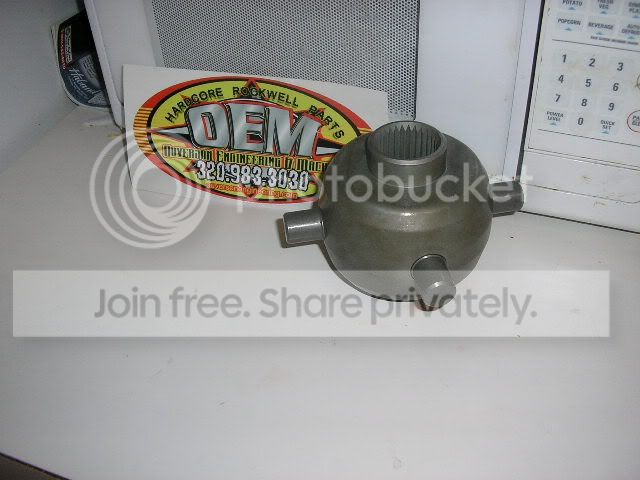

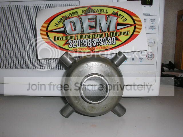

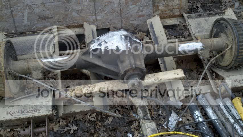

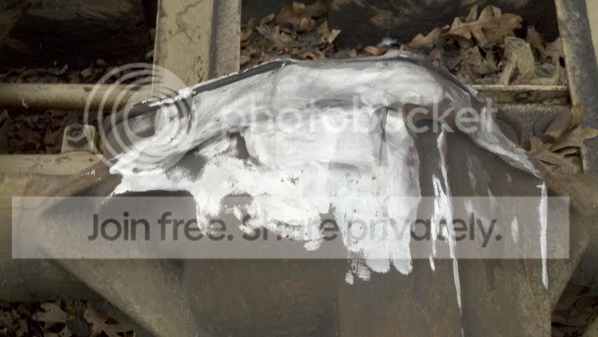

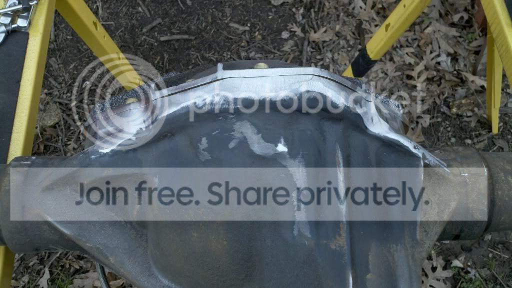

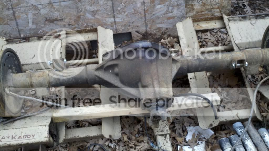

I've been majorly busy with work but over the last 2 months or so I have made some progress. I rebuilt my spare 14 bolt with an overson mini-spool, solid diff cover, diy gaurdsman off my old 14b and shaved and smoothed it.

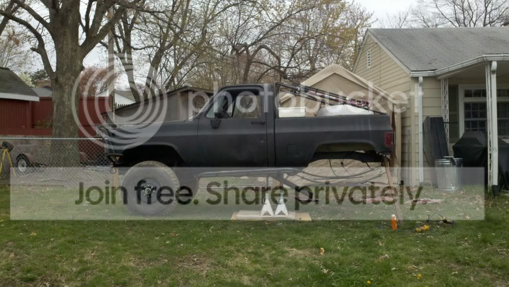

I also rebuilt all my leaf packs. In the front I installed new poly bushings redrilled the perches an inch forward and added a couple leaves from a 56" pack and pulled a few of the lift leaves out. In the rear leaf packs I added an add-a-leaf and zero rate to level me out and give me a little more stability.

Before:
After:
Close Up with stock cover
here's what I did to the solid cover

Nice shave job! I need to do that bad! How long did it take? What tool did you use. Thats on my to do list! Looking good!!!
Thanks Guys! it's coming along slowly
Munepit: I used a recip to cut the top lip off and then went to town with my 7" angle grider for a bit then cleaned and smoothed everything over with a 60 grit flap wheel... all in all i'm very please with the way the new 14b went together. plus these overson spools bring the beef :thumb:
These aren't my pics cause I forgot to take any :whistle: but these are a few of the spool I found online. This thing is sick

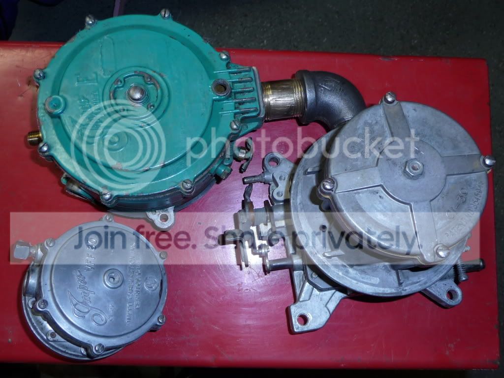

I just just won this setup off ebay for 225:thumb:
Also my F350 is for sale so check out the link to the ad in my sig. Give me a call to talk about the CK5 discount :D
A buddy of mine works on forklifts and dropped off two aluminum 10 gallon tanks yesterday, and both of them are partially full too :D
The ebay item has shipped and should be here later this week. I'm, hoping that by this weekend i'll most everything I need to install propane on the truck! I can't wait to ditch this carb :thumb:

Awesome, I can't wait to get it on there and going... What shut off are you using?
BTW your truck is looking sick on the 44's
I'm using the same VFF30 that's in your pic... Just plumb it from the tank to the VFF30 then to the Model E... Run a vacuum hose off the intake to the VFF30... I'm running my vacuum off the Q-jet base that my 425 is bolted to... Your base looks the same...
It's slower to start if it's been sitting than an electric shut off... You'll need to crank the engine over to open the diaphragm on the VFF30 until the propane makes it up threw the vaporize(Model E) and then the mixer(425)... After that it starts with just a bump...
I had an electric shut off and it has to be wired to a switch or ign on... I like the vacuum because if the engine is not running, there's no propane going to the system...
It may take some time to dial it in for the best performance and mpg, but it will run no matter what...

Gotcha... What do you do to dial these systems in?

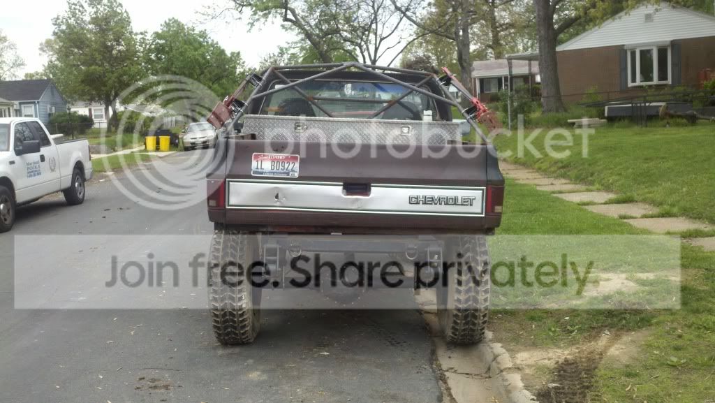

A few new ones of the truck, I had to move it to get some stuff out of the car port... It needs some love in the trans department. I don't think the clutch is disengaging completely and also my throttle cable is sticking bad causing it to idle high and makes it a pain to move it around... anyway here's a few shots... all leveled out it with the new aal and zero rate it looks to tall for the tires :dunno:, the stance doesn't look quite right to me for some reason... idk i'm burnt out it's been a hell of a few weeks...
