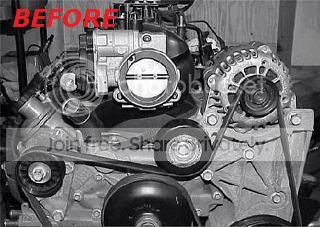

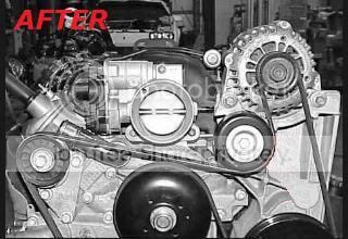

all the intakes are interchangable. The problem you run into is clearance with the waterpump (i think its the waterpump) on the truck motors vs the car motors. Don't bother with an ls1 intake, there are much better options out there that can be had just as cheap. And don't buy the crap that the truck intake makes more low end torque either.

The waterpump and the idler pulley on the truck are in the way when you do the swap you might as well replace the water pump for insurance. Just buy a waterpump for a car and dirty dingo makes a relocation braket for the idler might as well get the motor mounts from them also they offer the most adjustabillty of any conversion mount I have seen so far. I used them and did not have to cut my engine crossmember or move the trans crossmember.
