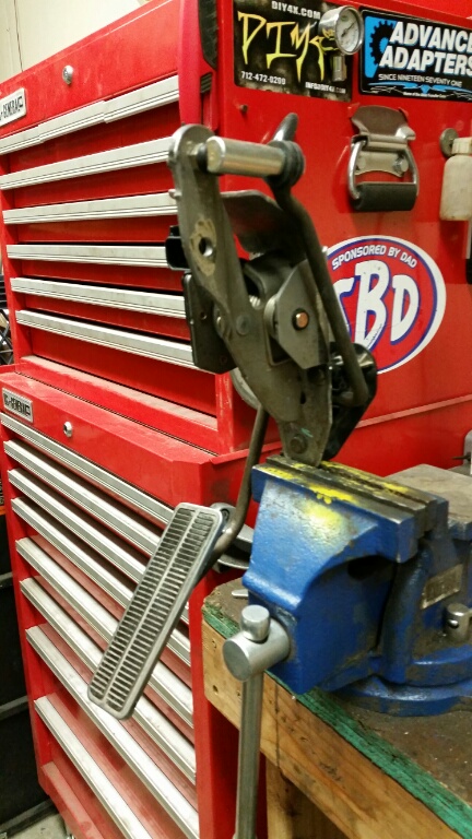

One other issue that I have that may, or may not be related to the tune is how sensitive the throttle response is. Right now, going over bumps at low speed sometimes makes the truck damn near undrivable. My foot bounces on the throttle causing me to blip the engine, making me bounce more, blip the throttle harder, rinse, lather, repeat, etc, until I pull my foot back and wait for it to settle down.
I figure this could be caused by several things. The tune could have the throttle too sensitive. The throw on my pedal might not be long enough. The return springs on the pedal could be too soft (or too stiff). My suspension is about as soft as a dump truck so maybe it's just that. Or, all of those things combined.![]()
That was going to be my next step in trying to get better feel.I bent the pedal down so it was full throttle on the scanner right before touching the floor. Now there is a much better pedal feel as to where you really are.
