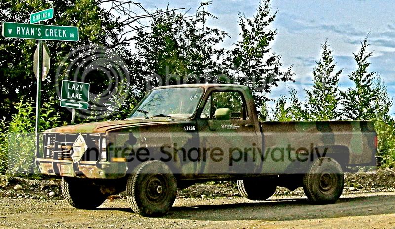

Yep we got it. That thing does run pretty loud lol. I drove it home from NJ. and it seems to run good no leaks and if there are squeeks or viberations you wouldnt be able to notice them lol. The truck runs strong and will probly tow my jimmy behind it just not real fast. It does have a locker in back and limited slip up front which will make for an awesome recovery truck plus it has alot of space for a generator air compressor and alot of tools and spare parts. All I need now is a set of goodyear hi-miler custom Xtra grips or CXGs. About the top speed,me personally I dont know if I would run that thing past 60,it just feels chancy. Also I will post some pics soon.
