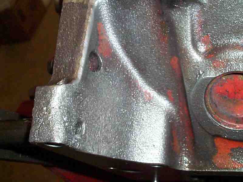

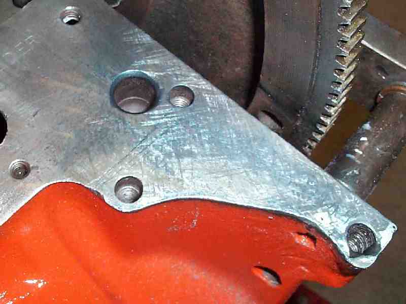

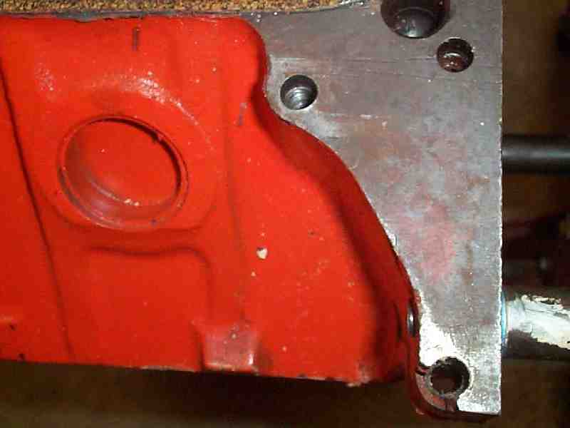

This is the f-kin reason... outside STARTER MOUNT is limp as obama's sissy wrist!
starter has no back brace to engine block (ordered the starter brace lastnight) and nose cone is twisting because of this catastrophy.
Don know what th hell to do....?
Good picture. Wow, that's not good tho.
There are a few options before we Deicide to scrap the block.
In the past I've dealt with this issue and had some success and also no luck.
Here are options.
We can try and put a stud in that side of the exhaust won't interfere.
I've had hood luck going to a newer style modern starter, which is much lighter and doesn't stress the bolts/block as bad.
Will just have to see
I found this online....
"Install a phosphor bronze bolt in what's left of the hole. Clean the casting of all paint, oil, and residue.
Preheat the area surrounding the broken ear (brush the area after heating to give it a final cleaning). Weld the area surrounding the bolt with high nickel filler rod. Allow it to cool without quenching, keeping it warm with a torch for a a while to prevent embrittlement. Once cooled, shot pein the area and remove the bronze bolt.
Scrape the mounting pad flat, tap the thread clean and go back to assembly.
Can this be done without pulling engine?
