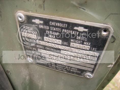

this is the tag that is in the blazer. when the sixth placement is 3 its one ton from what the book says i honestly dont think it has a 60 and 14 but i just find it strange that the vin is incorrect
7th digit is a 4 though...which indicates 2 door cab. The K5 is identified as a utility body. That VIN is from a M1008, 1010, 1028, 1031.

maybe someone swapped the door and didnt move the plate. Yeah, thought the 09s had 308s. I would look for a 1028 for the locked rear and limited slip up front. Though if you want the 205 i know the 31s have em with pto capability. I was going to get a 28 but i heard the limited slip wears out with alot of use and having it in the front blows in the snow.

yea thats probobly the wrong tag and im looking into a m1008 regular pickup or a utility truck thats a k30
