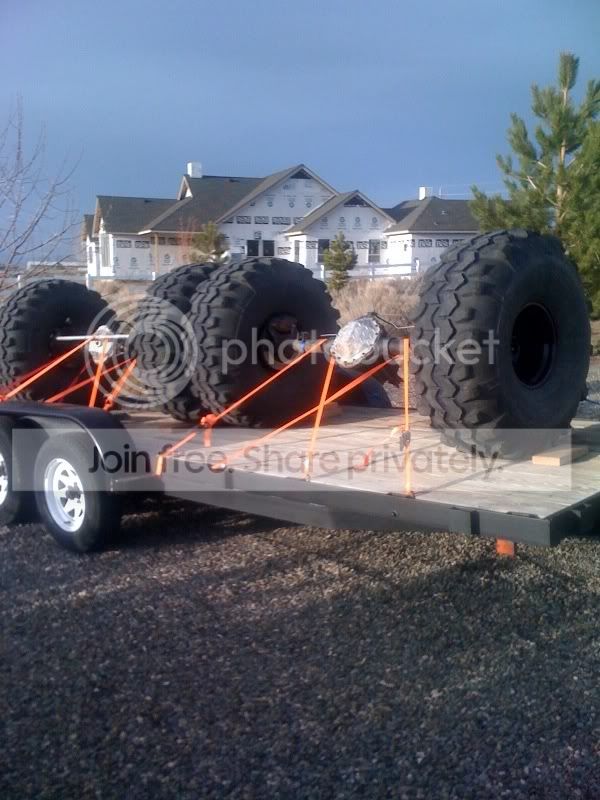

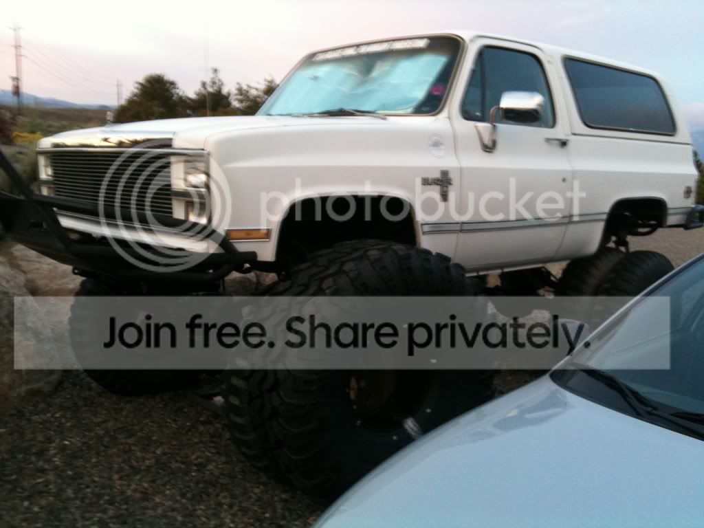

not much tech, but i finally threw the 2.5's under the k5. Here is what came out, and here is how she sits now... in all her redneck glory, ha.

lol, yea it wont be a dually for long... i will be tearing apart the hubs and flipping them. There are no dshafts, brakes, or steering yet, but it is all in the works.
I will be taking the front hubs off this upcoming week and dropping them off with the bus rotors at the local machine shop so they can be put together. For now i will be running a DIY pinion brake out back until i can afford another set of bus rotors.
I have to fix my pinion angle up front. I'm running lifted 52's with the DIY b52 kit, and even with the dana 60 my angles were all jacked up. So i will be contacting kert to see what we can do for creating something similar with more of a drop down effect in the front and a shorter shackle in the rear to help cure my jacked up angles.

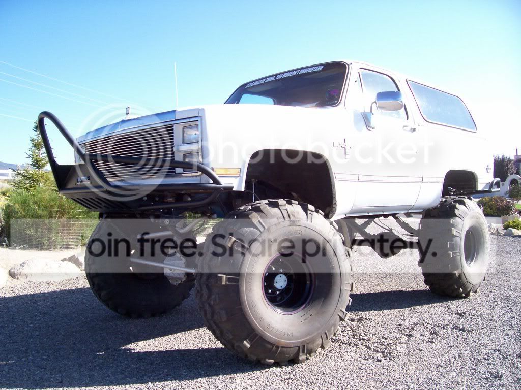

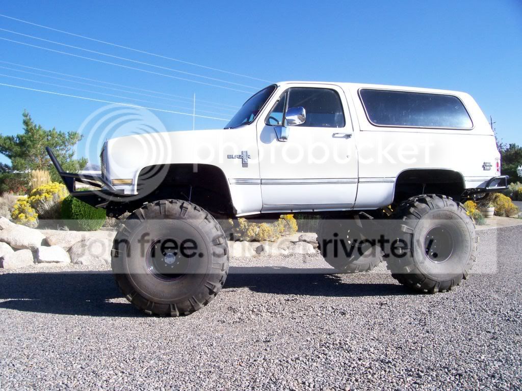

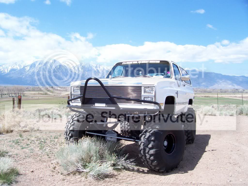

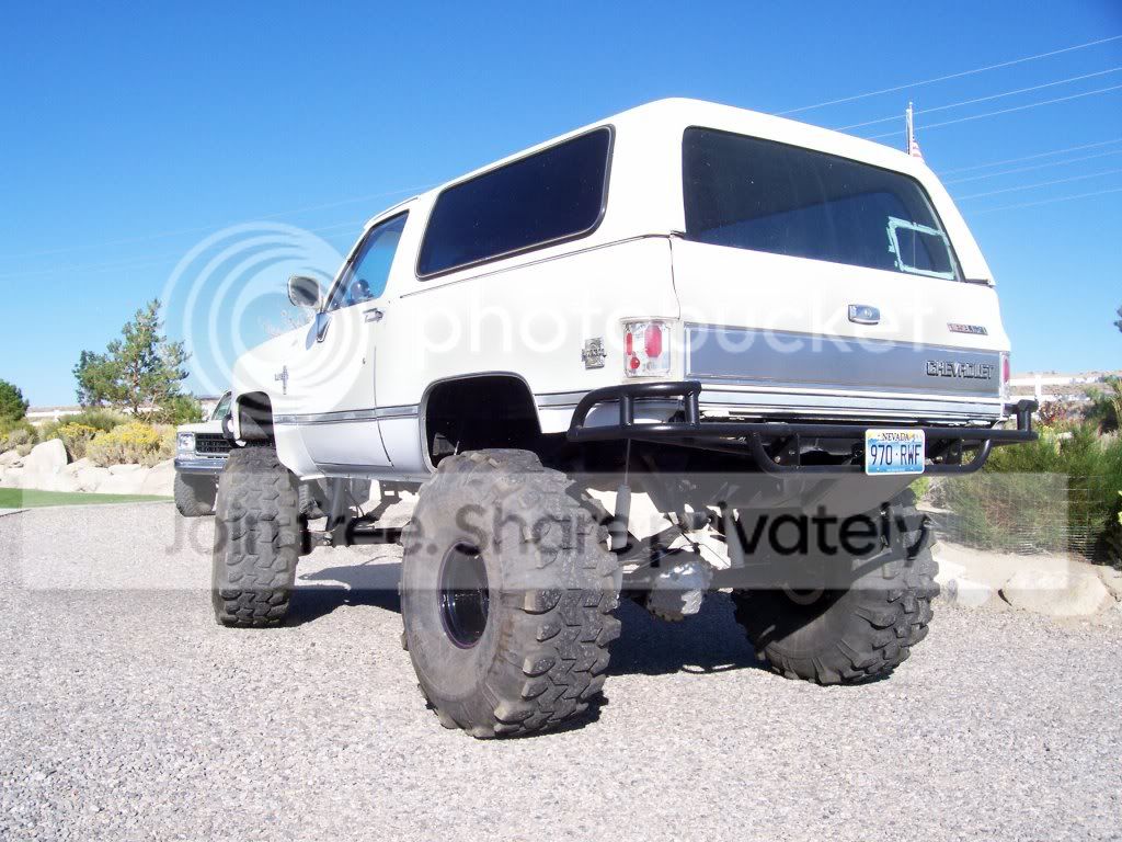

This post isnt really an update, but another member asked my in another thread if i could post up some pictures of the k5 prior to the 2.5 ton swap. So here are just a couple pictures of what it use to look like.

I liked the way your truck looked before. Seemed to flex well too, even with 8" lift 52/56's. :D But I'm "old school".
How did it all handle on and off road with the way you had it before?
Everything about the truck is still the same. the only thing that changed was axles, tire choices, and finally getting a front driveshaft.. I'm torn between 49" iroks, or 47" growlers, (and if pitbull ever comes out with a 47" rocker in a 20" wheel then i will get those for sure)
It handled suprisingly decent for the way it was designed. It would drive fine on the road and it would see speeds around 65-70 mph. Everyone who ever rode with me was completely shocked that it handled the way it did on the road. I never really took it off road due to the lack of a front drive shaft, but from countless times taking it out and doing poser shots with it, it seemed to flex well.
on the bottomn picture are those tires the 47 ltb or "just" lol the tsl 44
Like obijuan said thems the tiny 44's, lol

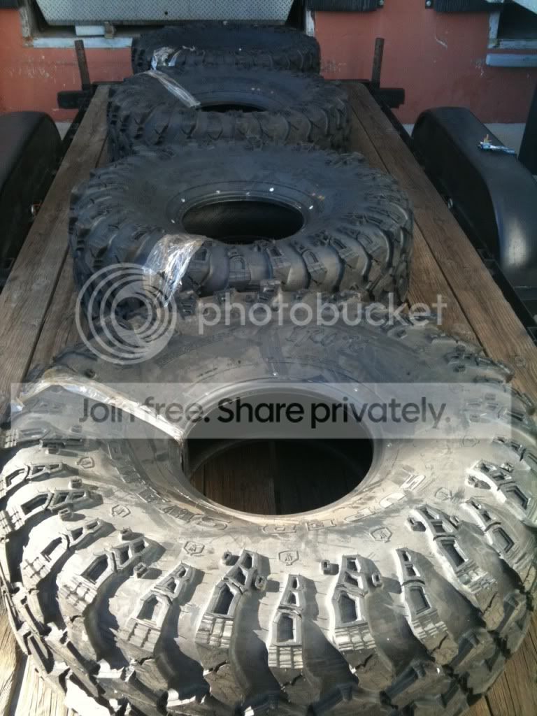

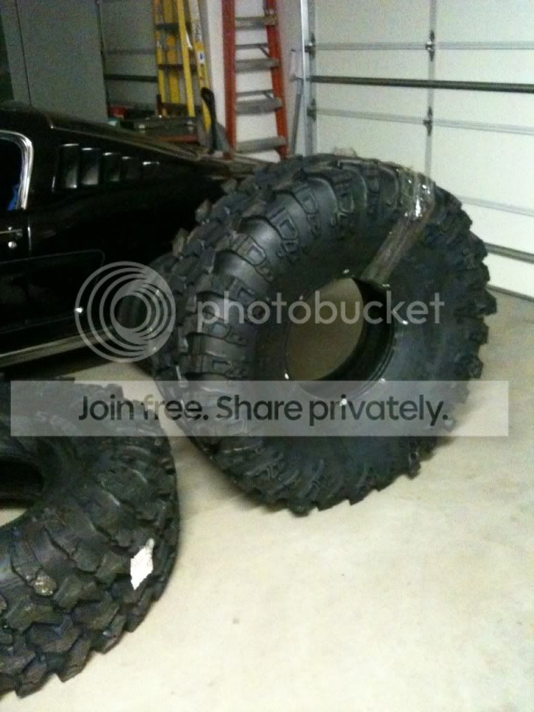

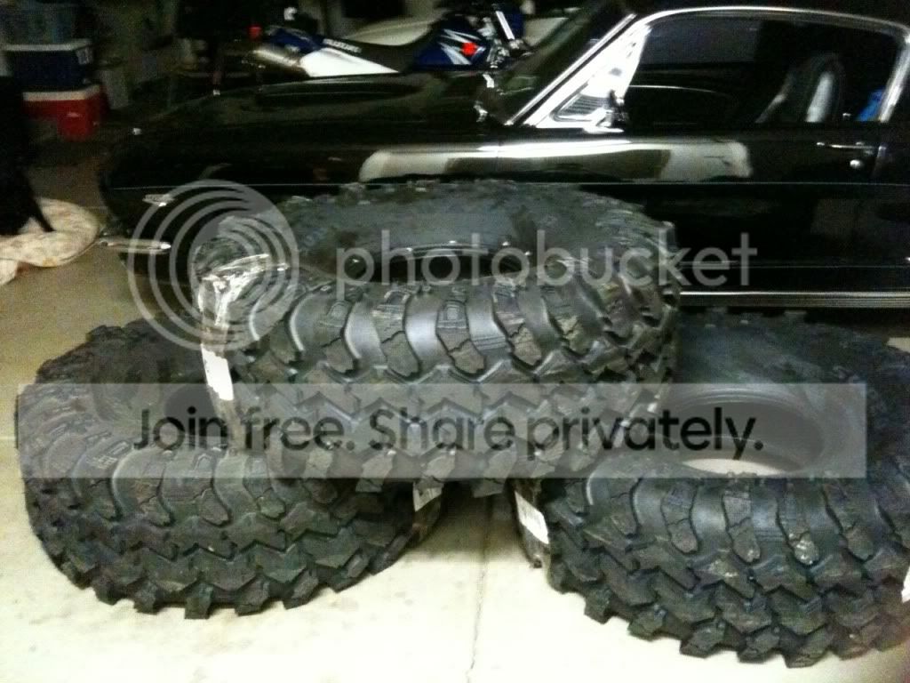

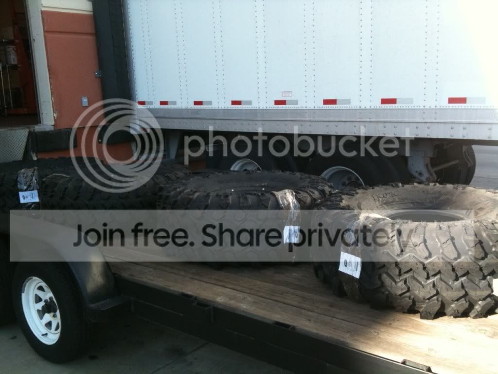

alright so i'm bringing this back up. After a long time and not having time to work on my truck due to school and work, i was able to save some cash and i started buying parts. I have acquired another steer rockwell for the rear, the front will be 4-linked with coils using ballistic parts (they should be shipping tomorrow) and i will be doing a custom wheel disc brake that clears 17" wheels. Last but not least i was able to pick these up and hopefully i'll be able to wrap them in some sweet stazworks double locks.

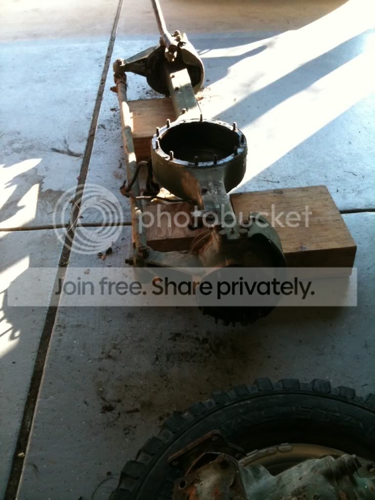

anyways, stay tuned because i'm going to start doing the machine work on the rockwell hubs this weekend, and if my ballistic brackets show up next week all that will be getting welded on and ready to be thrown under.
second steer rockwell all torn down and getting ready for the rebuild.
and the new rubbers:
Thanks guys! I'll try and get updates as stuff happens! My goal for the summer is to get the new tires on, all the brake stuff complete, and finish up the front suspension. I would like to get the steering and doubler set up, but due to funds being limited because of school, that might not happen, but we will see.
