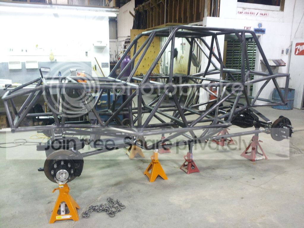

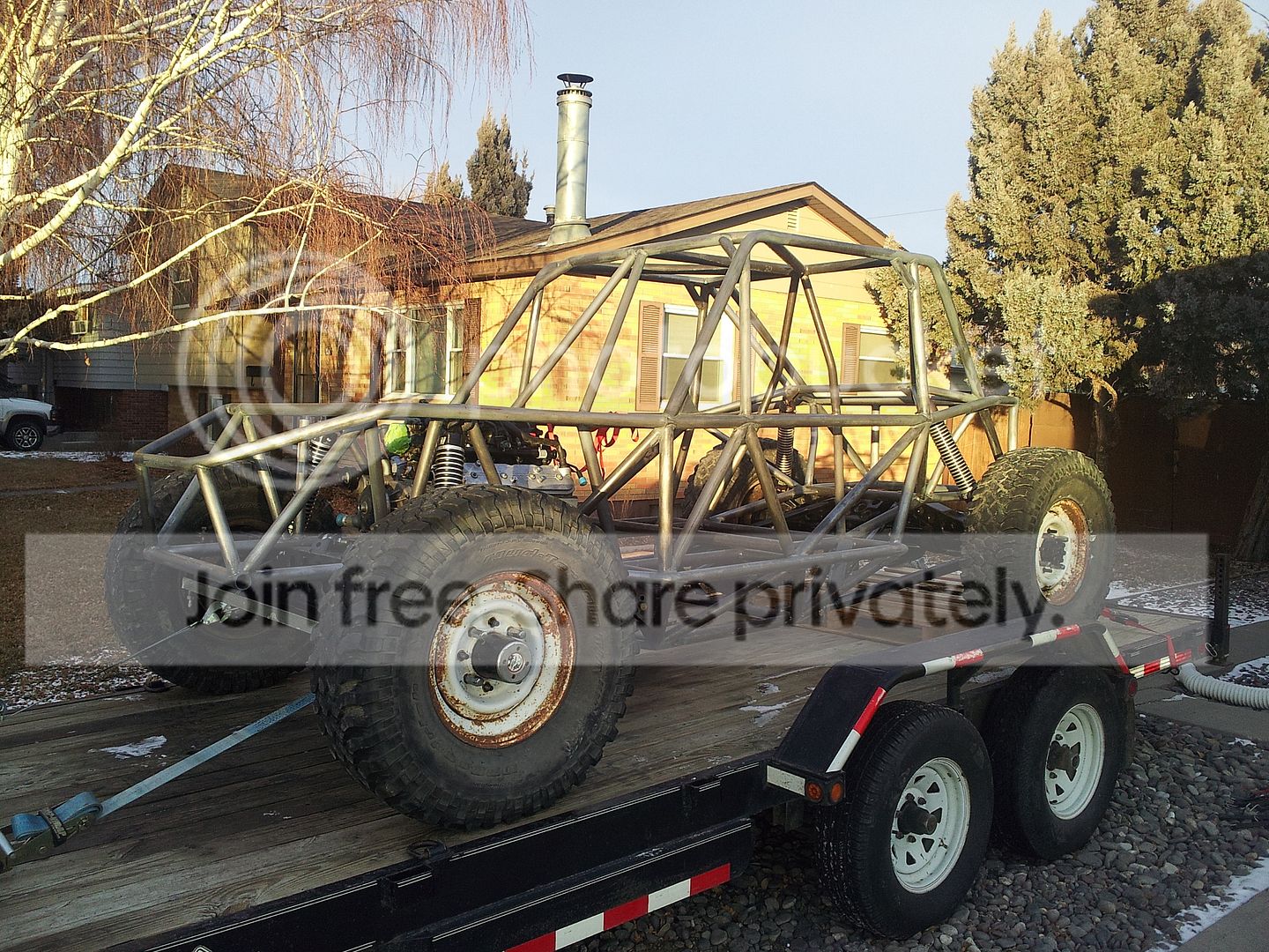

Got links mocked up with PVC then cut and started building. Lowers are 2x.25 HT chromo with 1.25 joints and the uppers are 1.5x.25 dom with 7/8 joints. My old steering setup will restrict up travel 1.5-2" depending on castor so selling that stuff and looking at Sky's Offroad one if they can make me a set for my solid knuckles. Will finish rear truss now that I got it all mocked up and get rear axle finished up and get shocks in the next week hopefully.

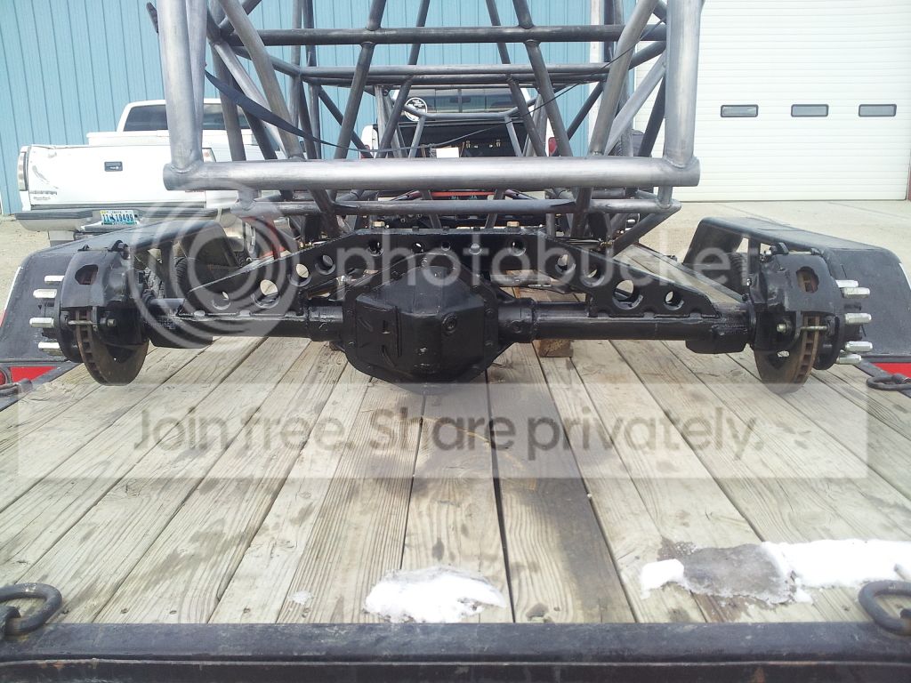

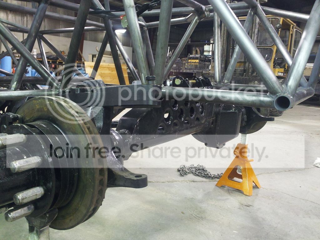

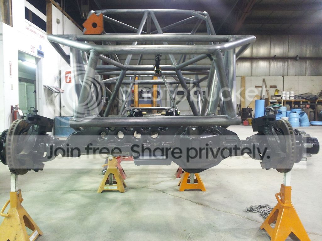

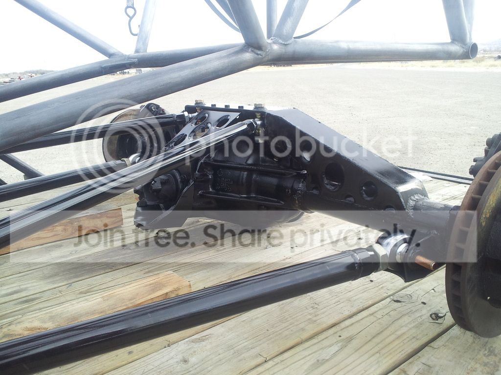

Got rear axle slung under today. Shock brackets next. I had Kert make me a pinion guard that was flat across top so I could make plate to tie into truss.
Seeing them axle gussets reminds me of something when I was 16.

Them axles give me the same impression. Really enjoy the build, and love the new buggy. Hope it comes together soon.
looking real nice Matt, I'm envious!

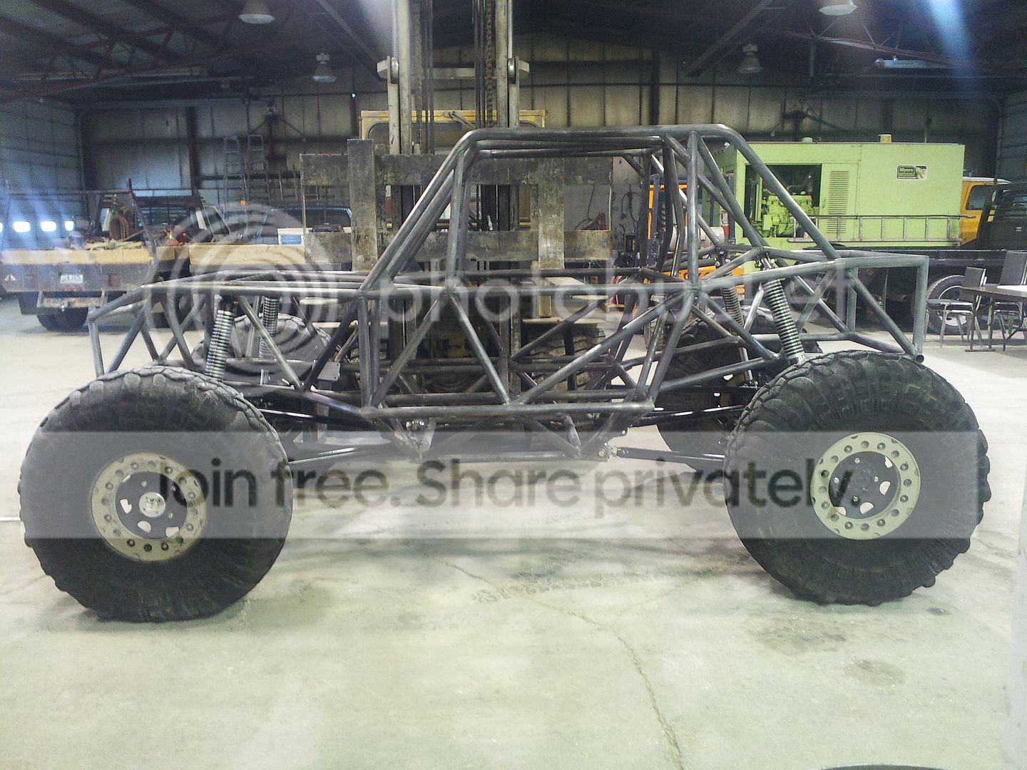

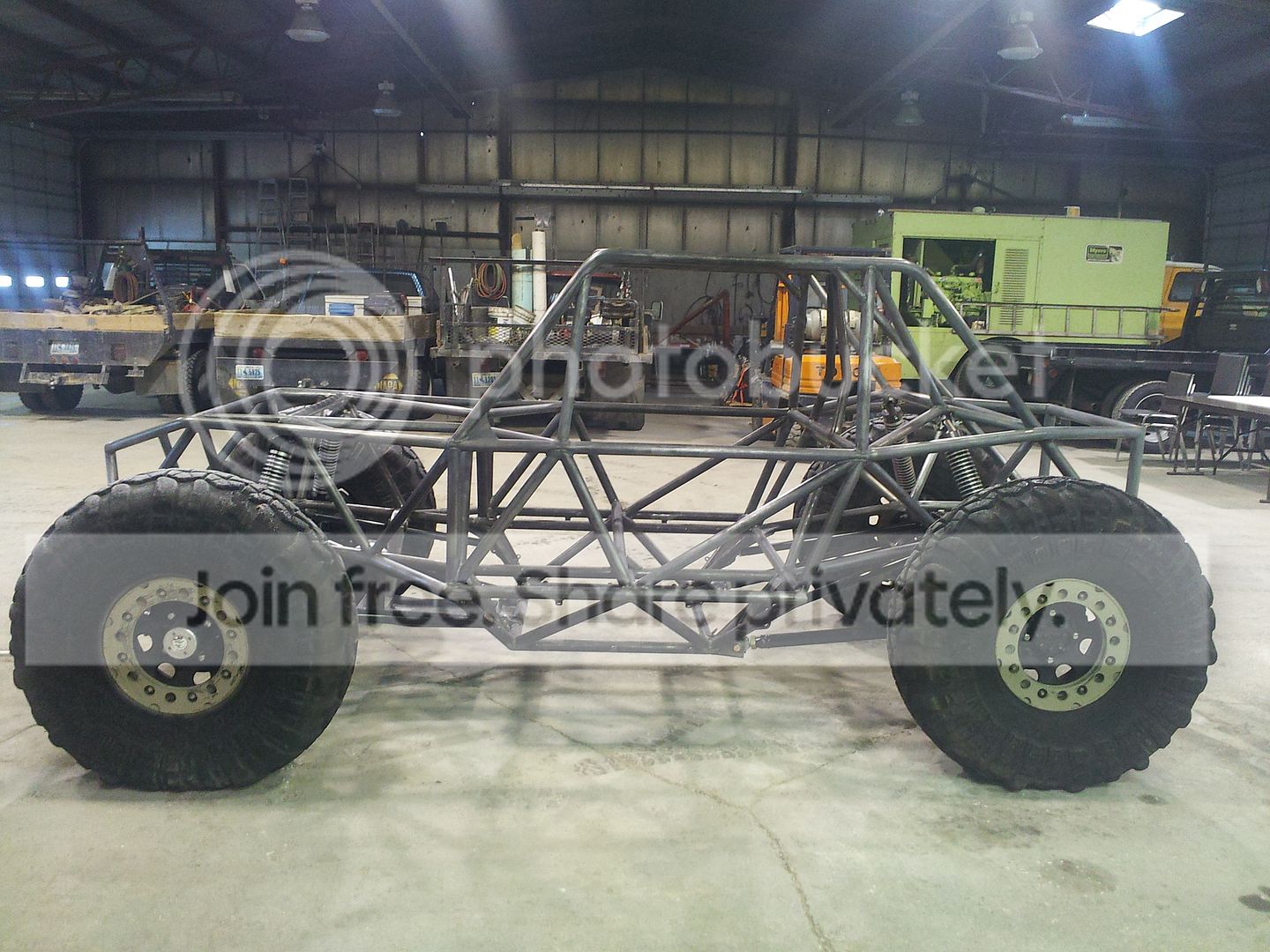

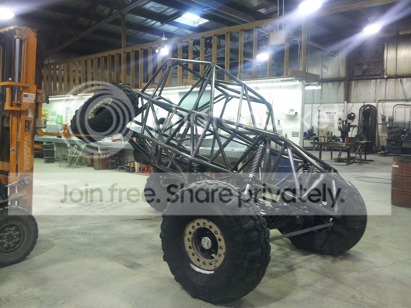

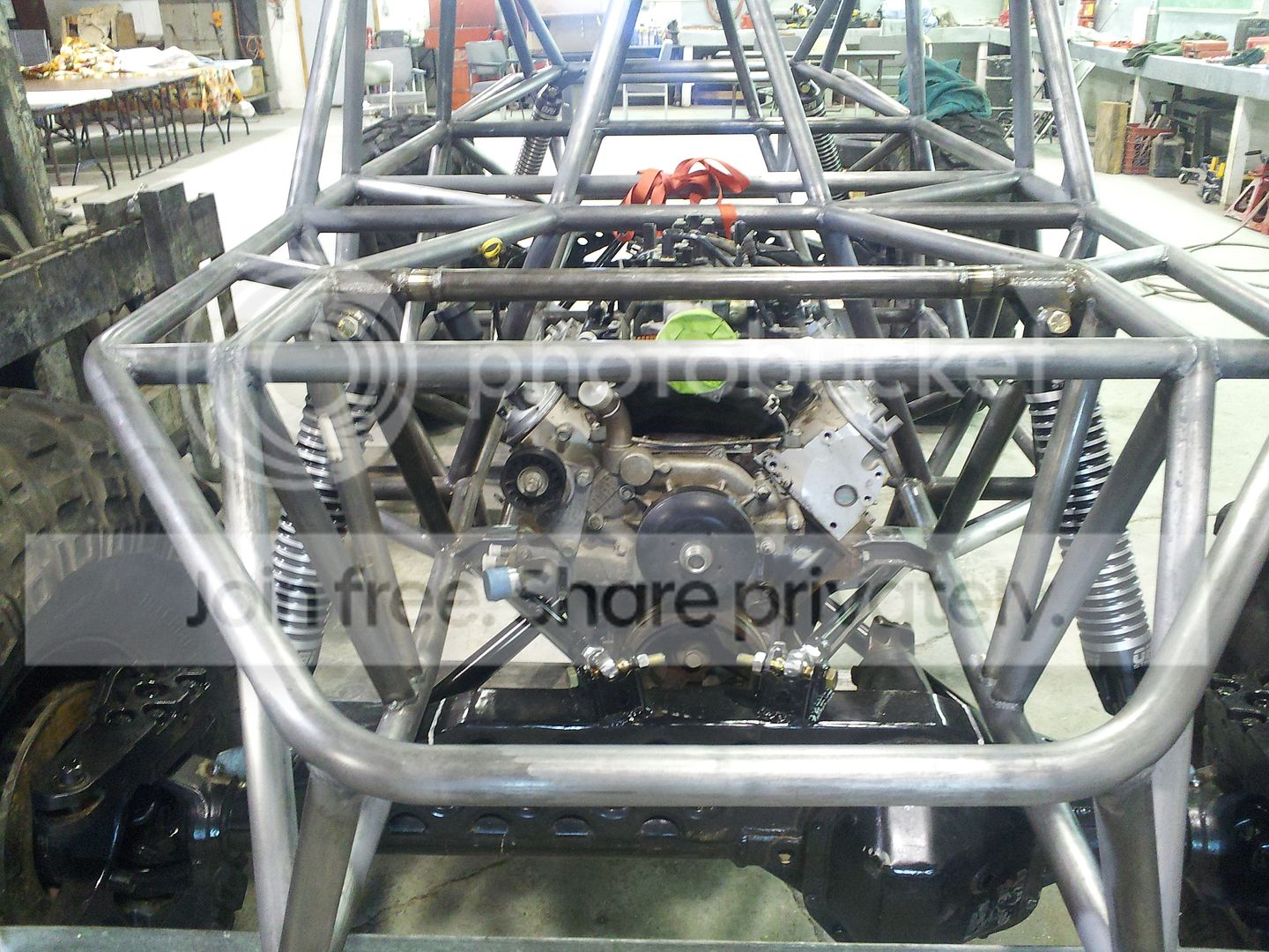

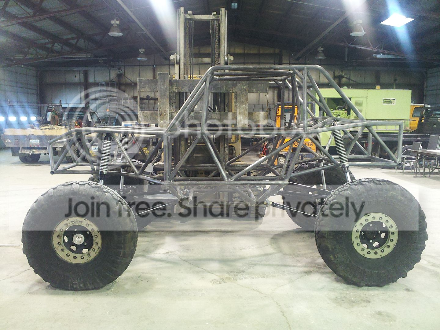

Check suspension clearances, got engine stabbed, and little kid shoes on now that I know tires clear everything ok. Has 10" under belly at bump, 18" under belly & 6'4" at roof at ride height, and 25.5" under belly at droop.
