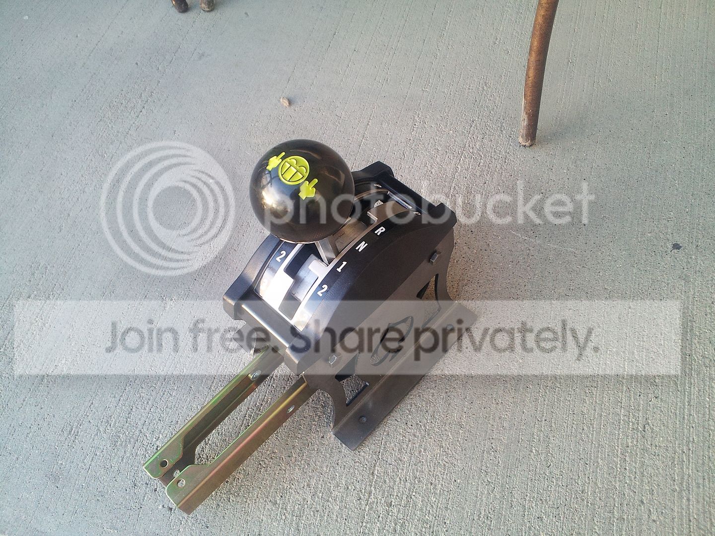

Getting some parts gathered but but Trent Fab just told me it is going to be the beginning of February before my Atlas is ready. I ordered it October 22nd and was quoted an 8 week wait. He blamed it on military orders and lack of gears for the delay. I am betting it has something to do with big name guys needing stuff before KOH myself. Had that happen to me a few years ago when I ordered a winch rope from Custom Splice at the end of December and he didn't ship till after KOH, I am now a MasterPull customer. My shifter from Jimmy's 4x4 and TCI fmrvb w/engine braking showed up so hope to install that this weekend, then hurry up and wait for the t-case since I kinda want to install the drivetrain next.

thats cool Matt, is that a Winters shifter?
yep. I had one once before in the 71 k5 but with a forward pattern valve body I didn't like having to panic row to reverse so instead of cutting gates or changing the valve body I went to a modded B&M pro stick. It worked good but since I am starting over again I am doing the valve body with the recommendation of Brandon and others so going back to the gate shifter.

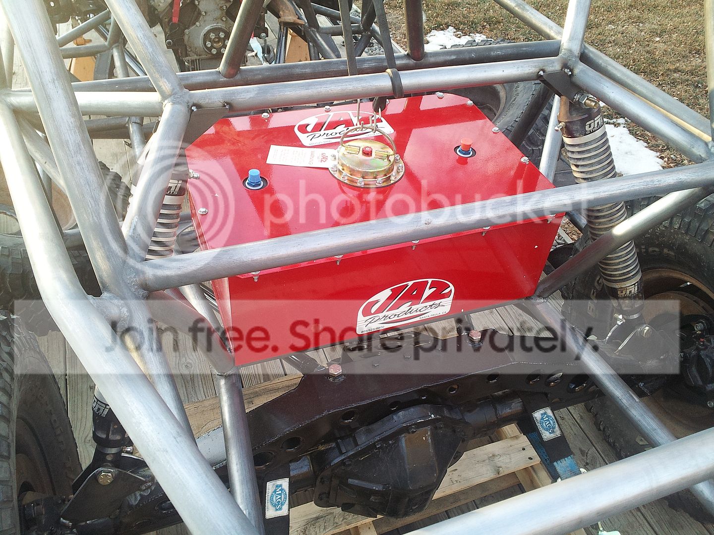

Still waiting for that atlas. I finally contacted Advance Adapters to inquire about the double length lead time and gear shortages TFab told me about. Apparently they have no shortages and extended lead time, still the standard 8 weeks. They asked who I had purchased through and within an hour I had a call from Derek saying my case will be built shortly and got it paid for now. That was last week. In the mean time I got a fuel tank picked up that looks like it will fit nicely. Is a 16gal Jazz tank, need to get some walbros and setup the pickups like I had in the Sonoma. Also got my steering finished up. Is a 2.5x8x1.5 surplus center cylinder, PSC large clevis ends, and Artec ultimate arms.

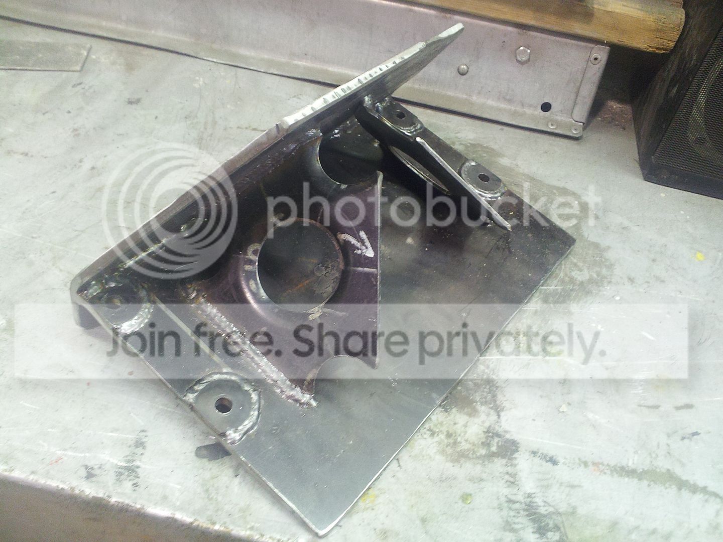

Top of cylinder mount. Short pieces of strap to lock the cylinder in so not just bolts holding the side-to-side motion.

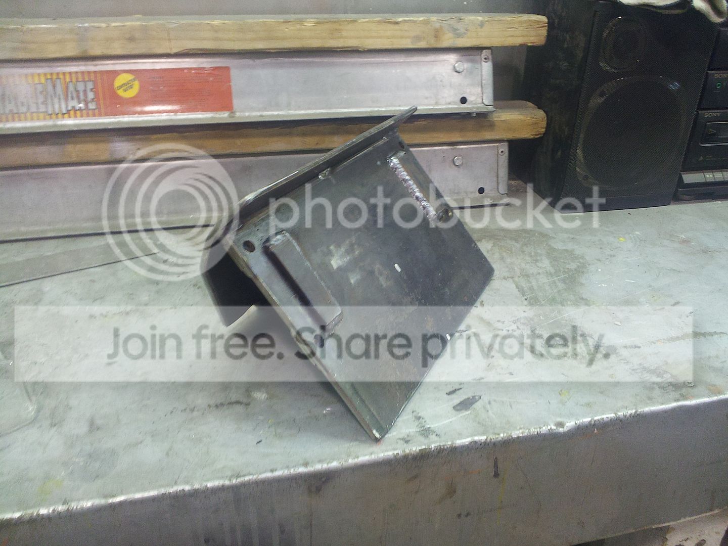

Back of mount. Welded washers to add thickness for bolt engagement and the dimpled gusset plates coincide with the V in the middle of the truss that reinforce the UCA mounts to axle tube too.

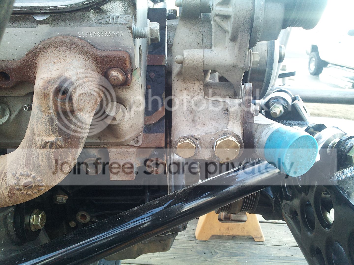

Also tapped the heater core ports to 3/8 & 1/2 NPT and plugged them for now. Will use one for mechanical water temperature gauge eventually.
that cylinder mount makes more sense to me know...and the extra thickness and locating tabs...great idea! Did those come from weakness' on the S10, or just a desirable upgrade for this buggy?
does that 6.0 have any broken manifold bolts?
The S10 had a single ended cylinder, this is my first time with a double, except for the rockwells I built and sold before using. Yeah both rear-most exhaust manifold bolts were broke on the 6.0. One stuck out a 1/4" so was easy to extract, the other was broke about 1/8" deep into the head. I was able to weld a nut to it still and get it out. I need to pick up a few manifold bolts yet to replace them. I also got the EGR blocked off and the EVAP purge blocked by taking the old valve and cutting bottom off and exopied it shut so it still attaches like normal but plugs it off.
