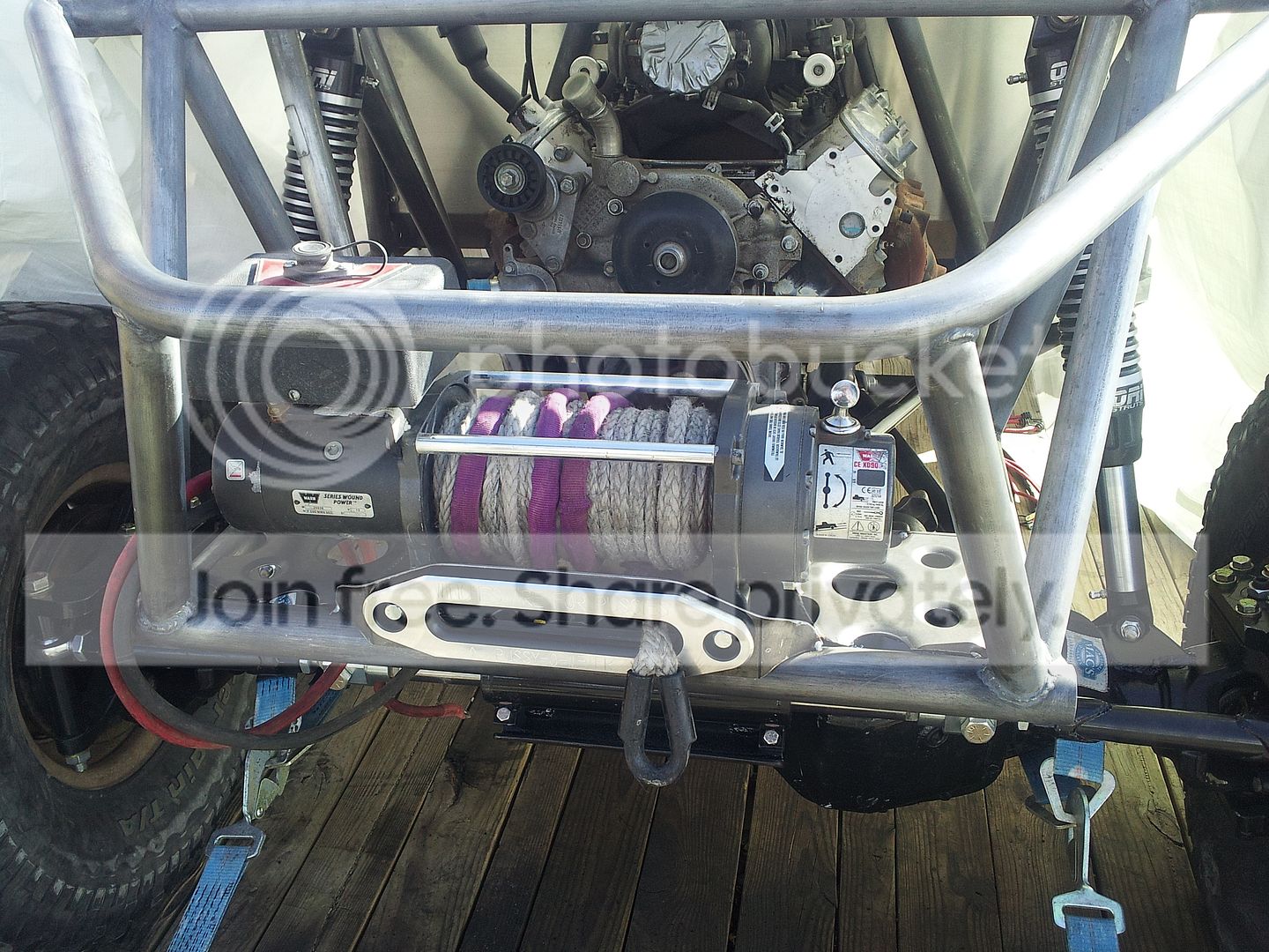

Playing around with winch/fairlead mount. Not overly sure on it yet.
looks good Matt, do you have other options for mounting location for the winch?
Just up front and center. I am thinking of an added tube across front for a bumper.
I think that would be a great idea, would it hamper the ability to get the winch out with the bar in there? Radiator going up front? Coolers? just don't know what your doing about logistics of all that in there?
Radiator will go up front behind winch and layer back a little. Oil cooler might go up front but maybe go in back along with an accumulator. Trans cooler will go in back for sure.
If I do a bumper tube it will be straight ahead of the lower front tube and be about even with the hood tube.
so if a bar in front, could the winch still come out the front if needed, or will you have room to get it out the top after all the coolers are in there?
Yeah any coolers up front would be behind winch still. I also have a slot/fairlead straight down below winch for suckdown routing.
OK, I"m picturing it now!
I like the idea of being able to suck down the nose!
