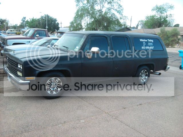

I'm not positive on what kind of mileage this thing gets, because the spedometer quit working recently due to cable issues, but I do know it gets much better mileage than my 4" lifted one on 35" tires & 4.10's.
I put $30 worth of gas in it last week and did a pretty decent amount of running around, I can honestly say it lasted much longer than the 4wd Burb.
Thinkin' agian,, it has to do alot with air resistance being cut from under the truck.
