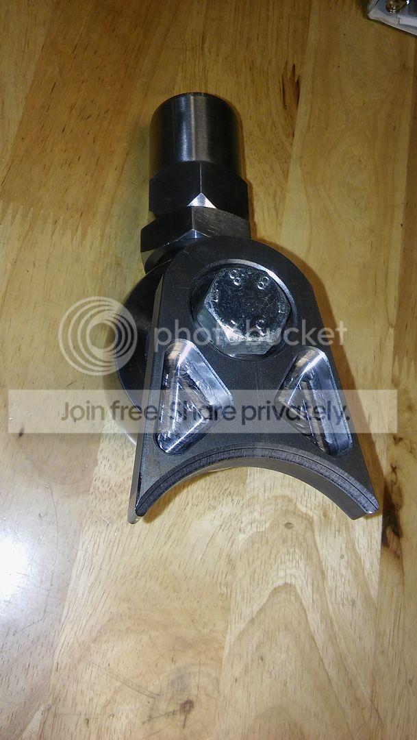

Made some axle tube lower link mounts with some free time at work. Turned out how I wanted. Nice big machined chamfer for welding.

Progress looks good. Keep on rolling.
The c'bore on them have enough clearance for a socket. I am in the process of machining my motor mounts and tranny mounts right now with a similar design.
And they are 1.25" rod ends
