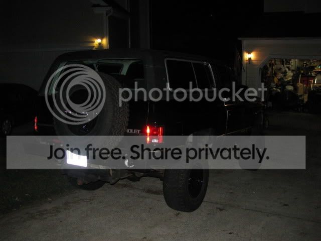

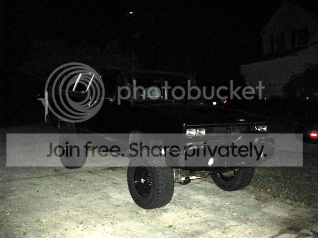

Here are some new crappy pics. I took the grille off and painted it semigloss black. Also put the new tallights on. :) I'll post better pics tomorrow after I wash and clean the truck.

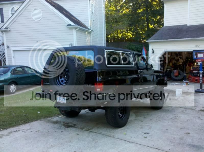

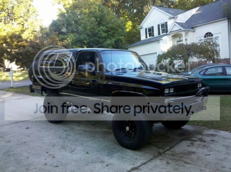

Pics of how it sits now.

I'm hoping to have mine look alot like this, it's a beefy look, but it's also very clean and sharp lookin at the same time and not too much. Looks great man:waytogo:
Looks SOOOOO much better with the normal tail lights.
3"body, 4" suspension that I think has sagged. Tires are 35" bfg all terrains.
