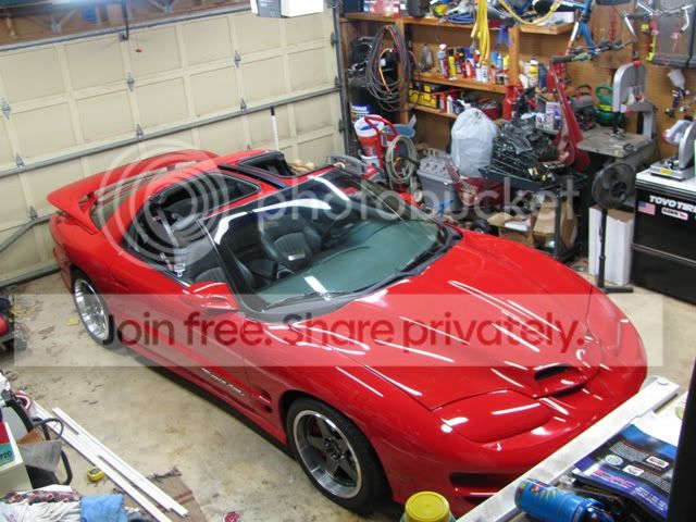

Here it is a few days before the engine went out.
Sweet. My buddies big into those cars, he saw me checkin the axle pic. Looks nasty man!!! :D
I've had this one for 7 years now. The thing is a blast to drive, should be even better with a few hundred more ponies. :)
