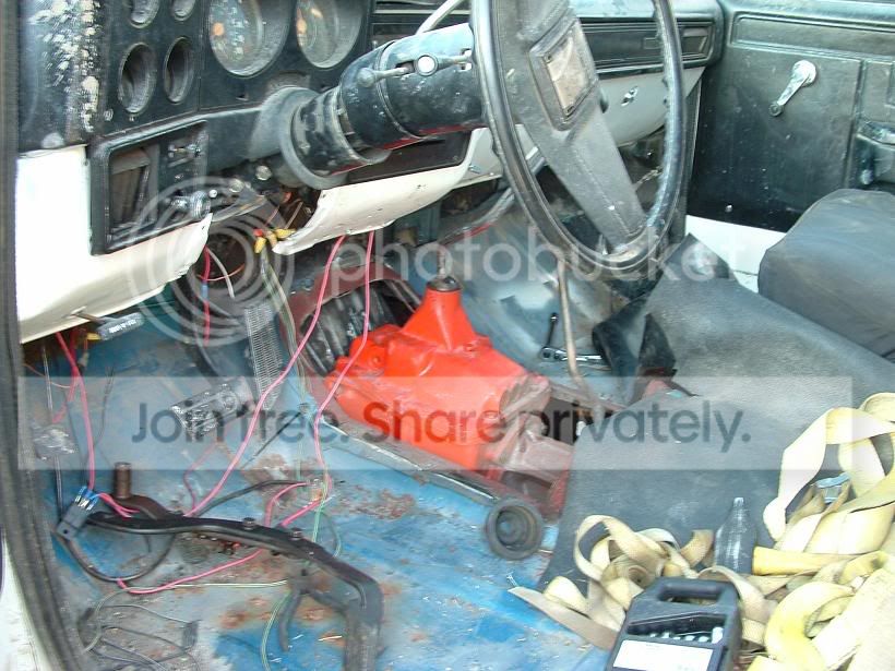

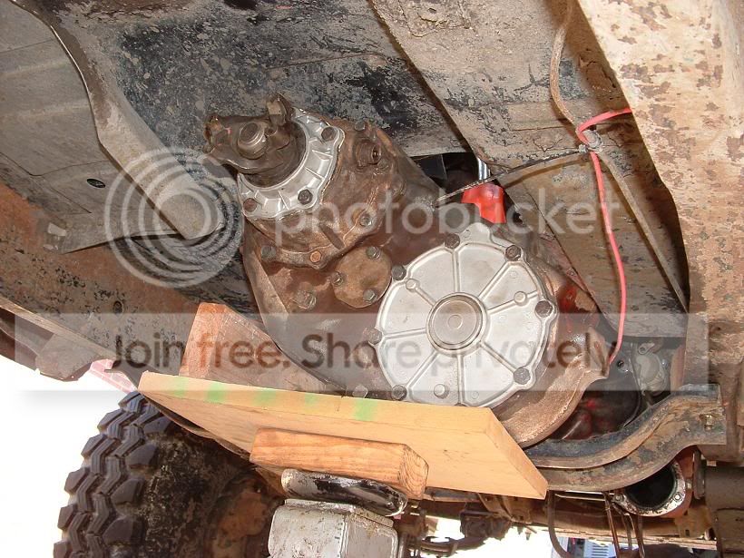

welp im a good ways into my swap now. goin from the th350 and np203 to the sm465 and np205 to be mated up with my 400 sbc.
basically have the tranny and tcase mounted up now, have all the hydraulic parts EXCEPT THE FREAKING PEDALS!!!!! cant find these for nothin out here.
i went with a LUK 12" clutch set, pioneer flywheel, novak conversions manual-hydro bellhousing conversion, jkw offroad twin stick kit, and this afternoon i plan on ordering a 1410 driveshaft and yokes from HAD.:bow:
anyways here's some pics.
this is my super duper tranny jack adapter.
so far the real pain in the ass has been mating the transmission to the engine. it took a few different sessions of shaking and swearing before it finally went in.

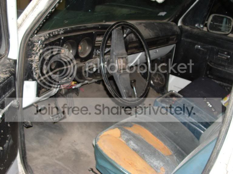

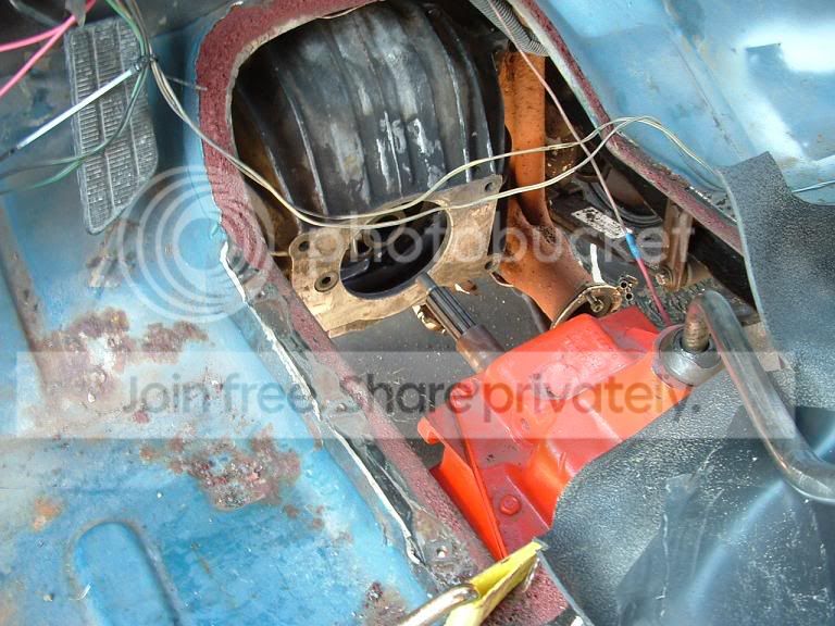

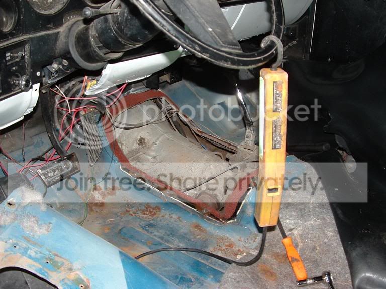

hows the twin stick going to line up with the old shifter? are you going to have to cut a big hole?
i think ill be able to just enlarge the hole in my current tranny tunnel...then again the new shifters may be too far back. not quite sure yet, but it cant be too hard. i like to take pics so im sure ill update with a pic of what i did.
