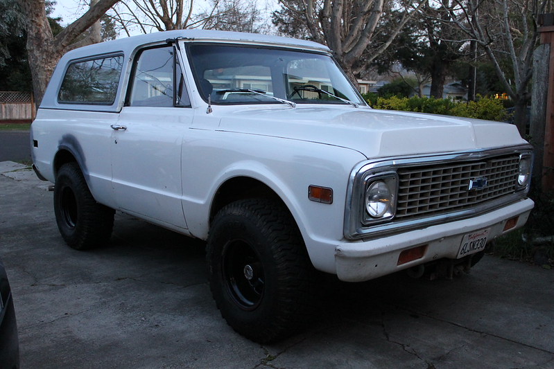

View of passenger front corner

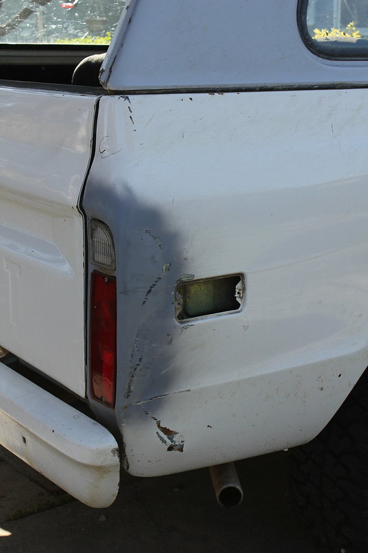

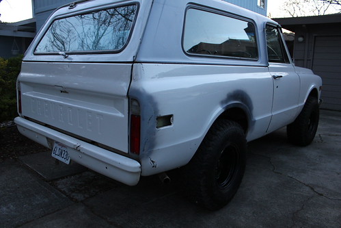

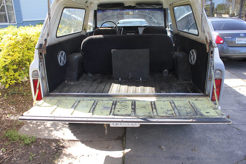

Rear passenger corner, PO had scrunched it up with a trailer, now gate doesn't latch too well on that side:

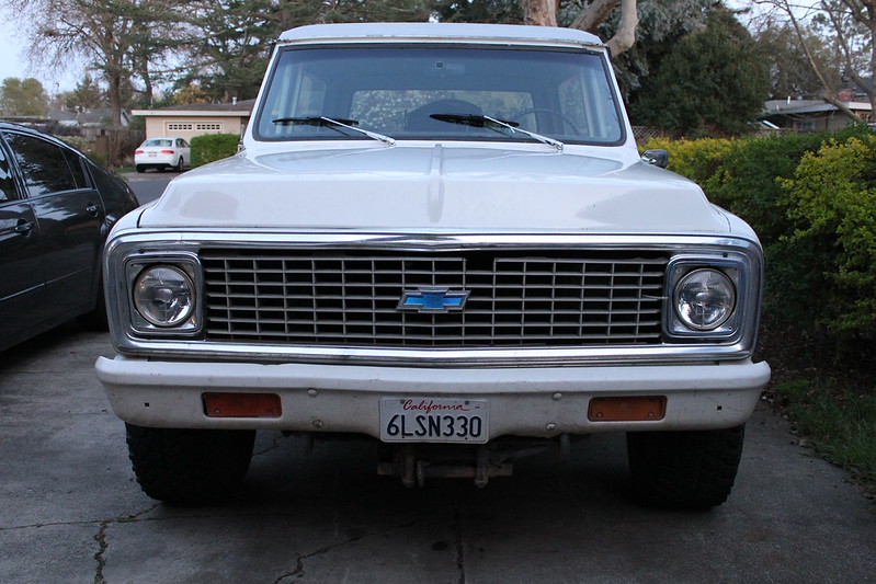

Front view, winch underneath, PO said it was off a newer blazer and actually a "Blazer winch" was there such a thing?

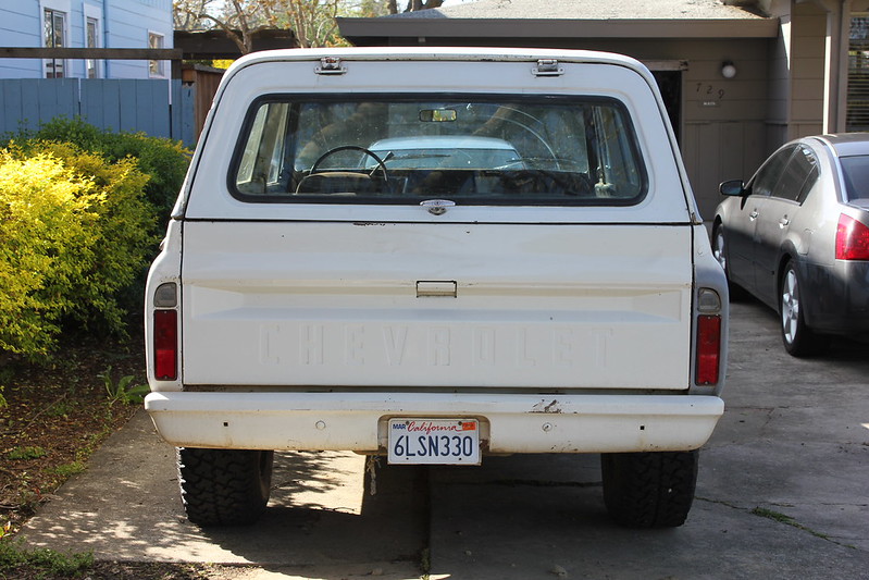

Rear view:
Better pic of the damage to rear corner:
Rear open:

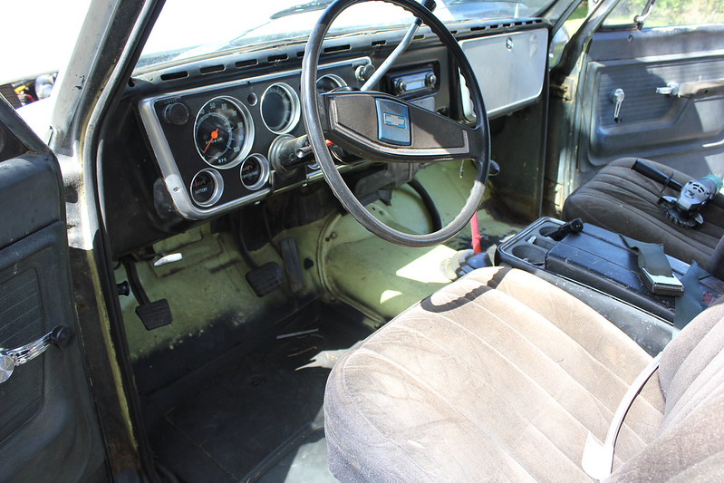

Front cab:
Cab from the other side:

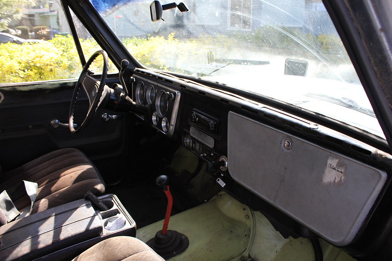

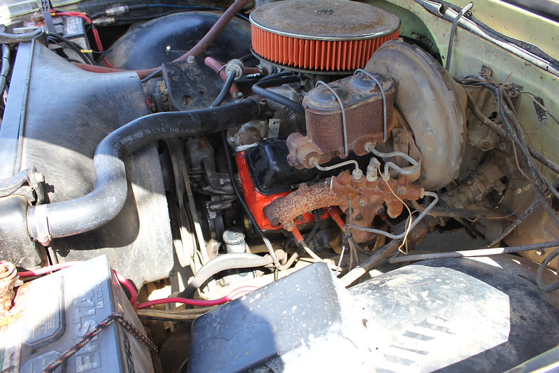

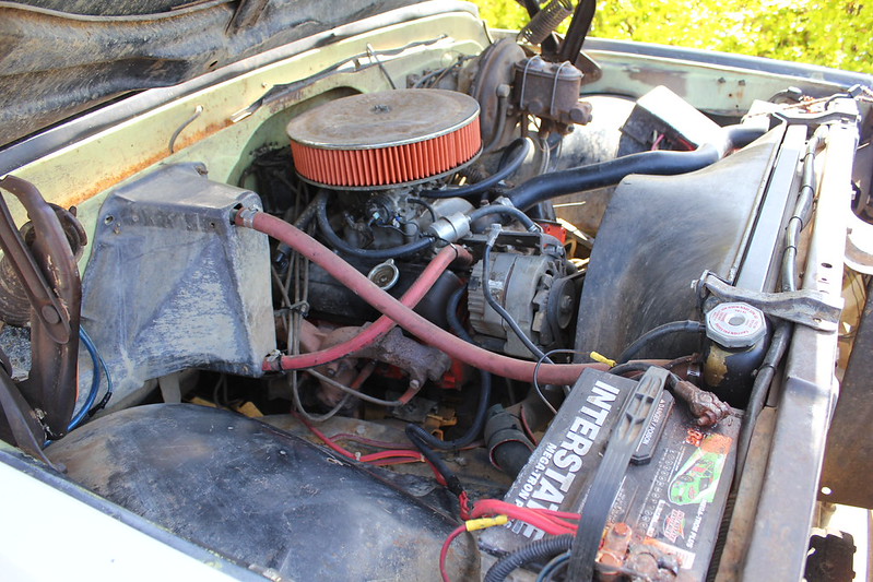

Was told this is a 400ci, but not quite sure how to tell:
Other side of the engine bay:

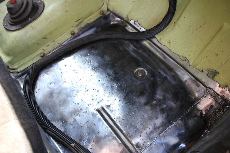

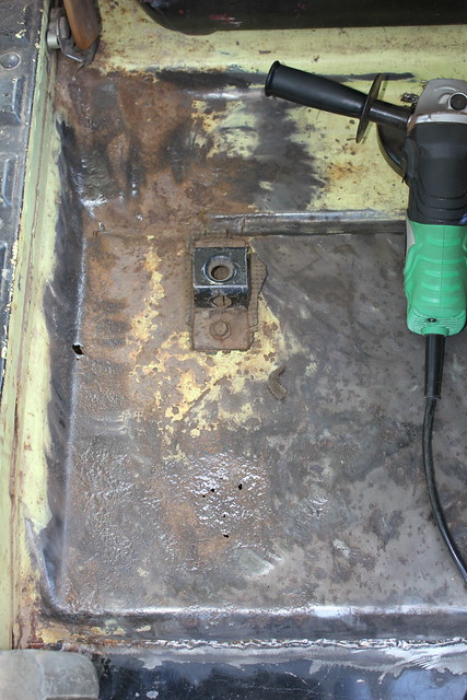

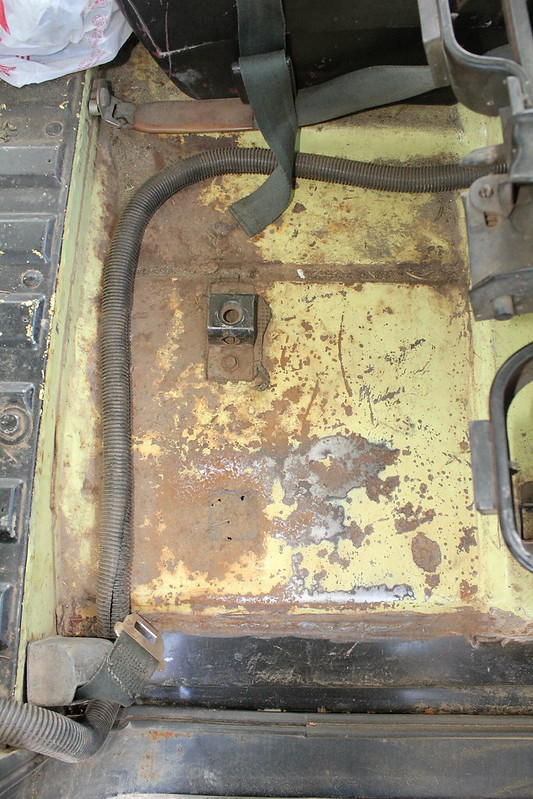

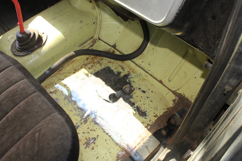

Before I started clearing out some paint and rust on the passenger floor:
After some paint/rust removal:
Under the passenger seat:

Only real way to tell if it's a 400 is the stamped number on the back of the block, near the dizzy. Oh I wish I could remember my own stamp :doah:
Thanks K85, I'll check that tomorrow as I am replacing the distributor. I do know it has a th350, and think the transfer case is a np205 based on the shift pattern.

I believe 400,s have 3 freeze plugs per side,but I have been drinking tonight! that is all,,,,,,,,

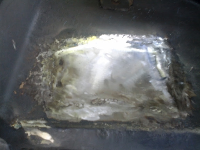

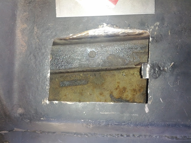

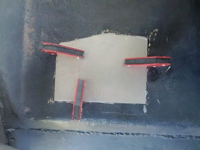

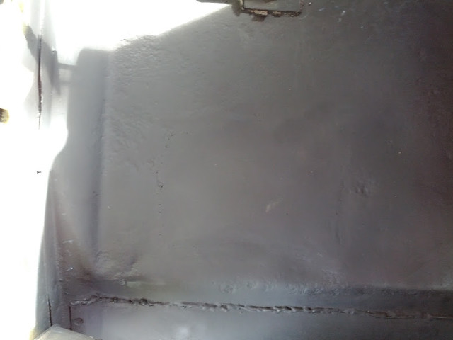

Pics I have below are my first attempt at welding in a small patch to replace some rusted out floor under the passenger seat.
here is a before of the area I worked on:
floor cut up
with donor metal
ouch...who welded this?

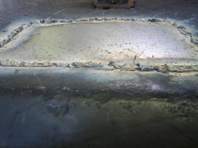

did about 3 passes of welding and grinding, but not sure which one this was:
and now primed

That was the exact spot that I first attempted sheetmetal repair on too! :)
I remember that small "tab" to support the floor was broken at the welds so the floor felt even more spongy in that area.

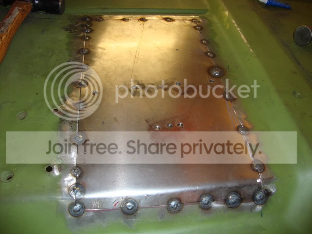

A trick you can try for simple fitment of patches is to cut the patch FIRST, then lay it over the area you intend to repair. Using your 4-1/2" grinder and a .040" cutoff wheel, carefully run run the wheel along the protruding edge of the patch piece using it as a cutting guide. You'll end up with a perfectly matched hole, and the disc width will provide the perfect gap for the welding process.
Sheetmetal is a tricky balance. You want enough heat to penetrate fully, but not so much that it warps everything. Wire speed needs to be slow enough that it doesn't give you big blobs on the surface.
Good first project! :waytogo: Rust repair is no fun, but it's satisfying when you know everything is solid.
-G
Good fix. Here's one I picked up to stop warping also in those sheet metal spots. Go around it just tacking it first. 1-2" apart then just come back around tacking more and more till you get to a point that either you can run a few short easy beads or grind and maybe you tacked enough you dont need a bead.
Good job, bud. Pretty nerve racking the first time you cut into your rig, huh? I cut six inches the first time and had to go sit down and drink a beer, figuring I just destroyed my truck. :doah: Little did I know at that time, in the long run, I was going to end up using the cut-off wheel on the rig like a surgeon. Basically getting rid of half of the tub by the time I was satisfied that there wasn't any more rust...
Are you using Flux core wire? I see a lot of splatter around your welds.
I don't know if it's just the picture, but it also looks like your patch has paint on it. Make sure that you clean the area that you're going to weld really well. Like Trav said, lots of little tacks around and you'll eventually have the entire thing filled in.
Here is the beginning pass on my area...:smirk:
