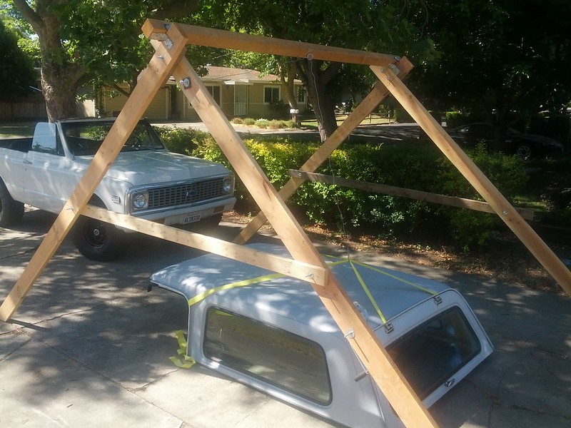

Now that we are back, I ended up building a lil something to help me take the top off since I have limited garage space. It's pretty hokey but did the trick:
And now that it is off, I don't know if I will ever be able to put it back on...I am loving it!
I was also able to touch up the rear passenger fender a bit, and get it to a pretty good color match. I will be buffing out the last layer of clear coat though to try and get it as shiny as the rest of the vehicle.
Topless is the way to go. Beautiful country up there and very nice pictures.
Great way to take the top off, is that stand collapsible too?
Yeah, bolts are what is holding everything together so I can bring it all down to a pile and move it to the backyard when not in use.
Cool, I'll be stealing your idea :D
Are those 2x6's ? How long are they?
They are 12ft 2x6's, and a 10ft 4x4. Used a boating hand winch off of amazon to raise and lower. I used ratcheting straps to hold the top and then just centered the wire rope over the top. The only problem is that part of the fiberglass drip rail on the back chipped from the straps. So you may want to either run 2x4's as your braces under the top, or devise another way. I am not very worried about the damage on mine, as my top needs some other work from the previous owner(s) damage to the top.
When lifting the top up and lowering it down, there wasn't much sway on the whole thing, but I may put some angle 2x4's or 2x6s from the side 2x6s diagonal up to the 4x4 cross beam to keep it from being wobbly. But it did much better than i anticipated and was really easy to crank up and down without using any pulley system.

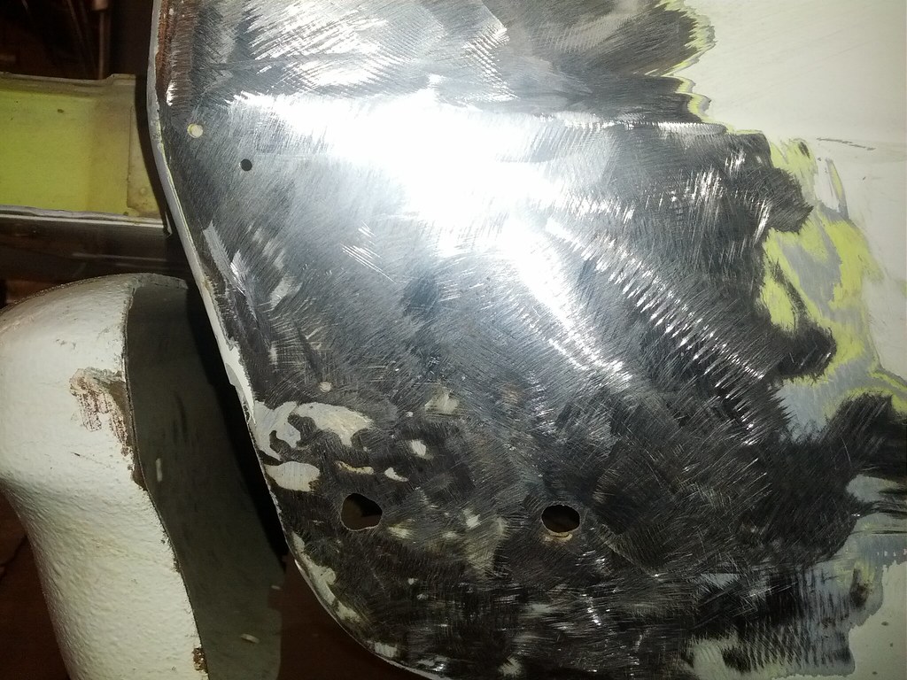

rear fender holes.
Are there to be any holes in the rear passenger fender as shown below. Taking a body class at the local college to do a bit of work on the rig.
Thanks
Looks like the holes to mount a swing out tire carrier.
-G
Thanks Greg!
