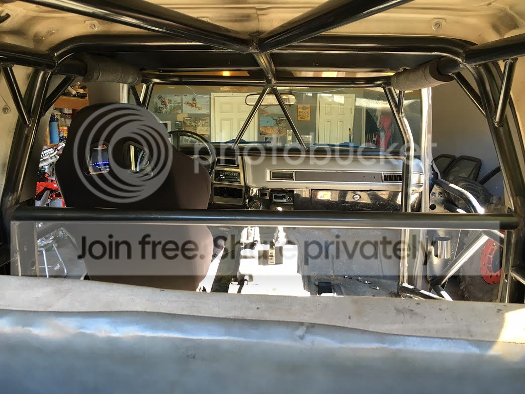

My 86 K5 build

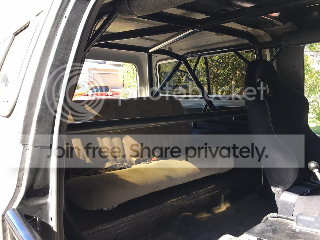

love the truck, I searched a ton through the thread, but how many sticks or total feet did you end up using for your cage? I am looking to order some tubing for mine and yours is a great inspiration.
Thanks!!
Where I purchased mine (and I think most metal shops are like this) they were only sold in 20 ft sticks. And I believe (if I remember right) I got 7 or 8 total sticks of tube, and the purchased 1 20ft stick of 1" tube for my bracing....but I knew I was going to use some of that tube for my rear bumper, crossmember, and wrap bar so I wanted some left over. I still have 10 ft or so left over sitting in my garage right now.
I'm a believer in, take whatever you think it's going to take to build it, and add on another 10%-20% more cause you are going to have some that gets ruined cause you jacked up a bend (at least I did, haha) and at least when I built mine I had an idea of what I wanted, but as it progressed my plans changed and I added more tube then I thought I would.
Hope that helps :thumb:
Thanks!!
Great! That is what I figured, and trust me I will mess up a piece or 2 for sure.

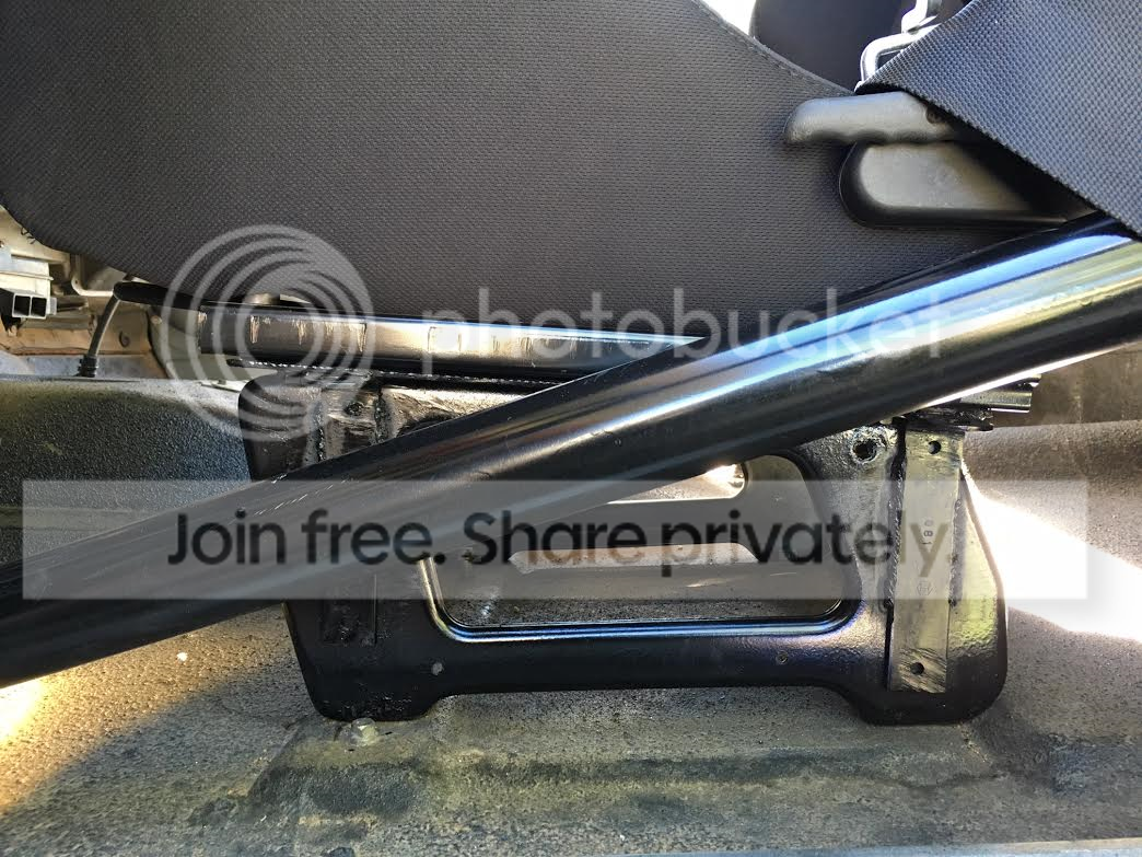

Decided it was time to work on the seats/belts in my blazer. I was rocking the stock seats this whole time which have been fine, but I wanted to install my full 4 point harnesses now (been just running the lap belt portion for a year or two).
So I purchased these seats:
https://www.summitracing.com/parts/sum-g1130l

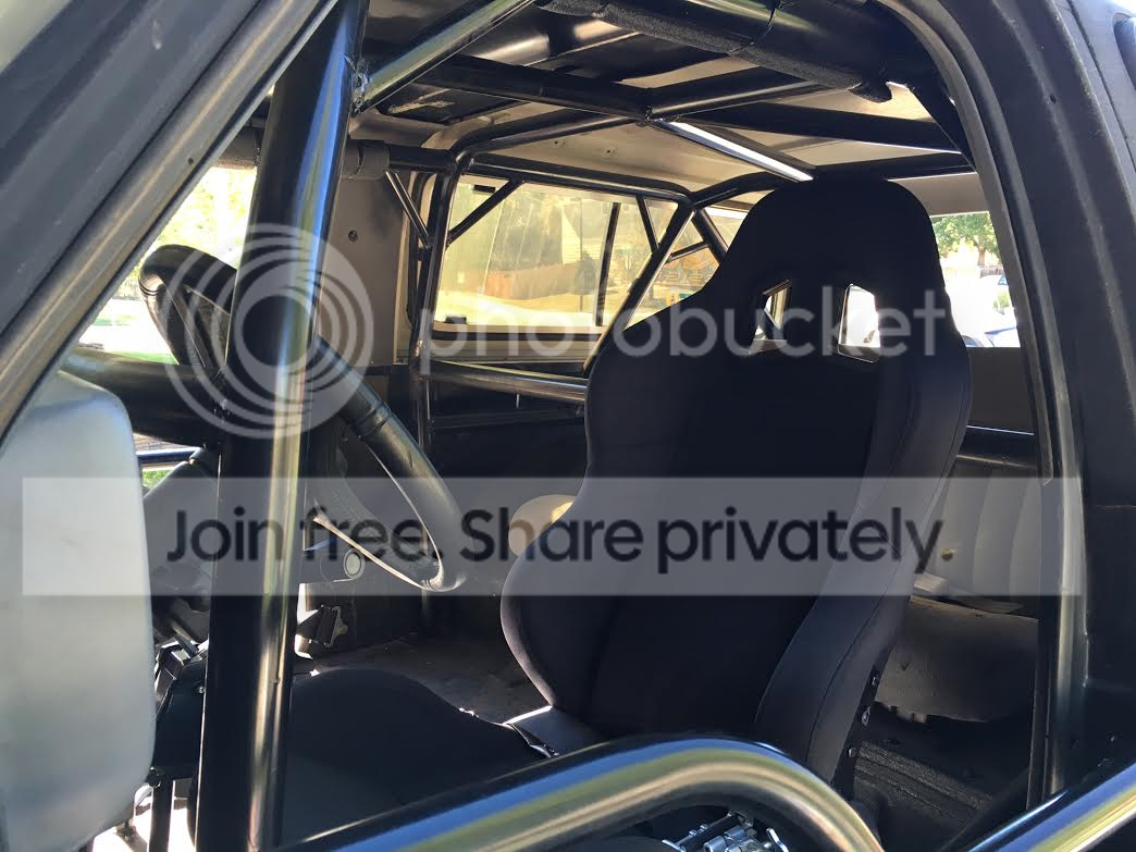

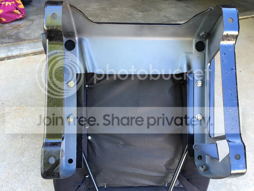

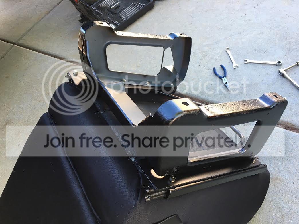

They come with a adjustable slide function that I wanted to keep...so after a while of staring at everything, I decided to use the factory seat bases and make them work with the new seats

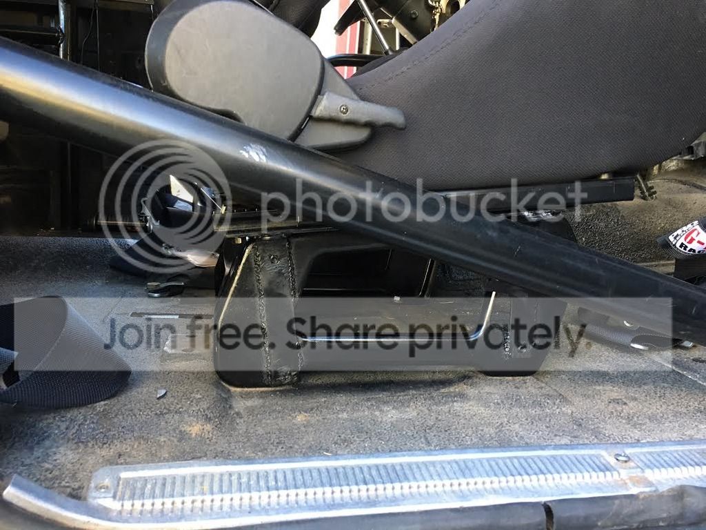

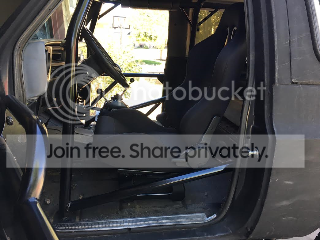

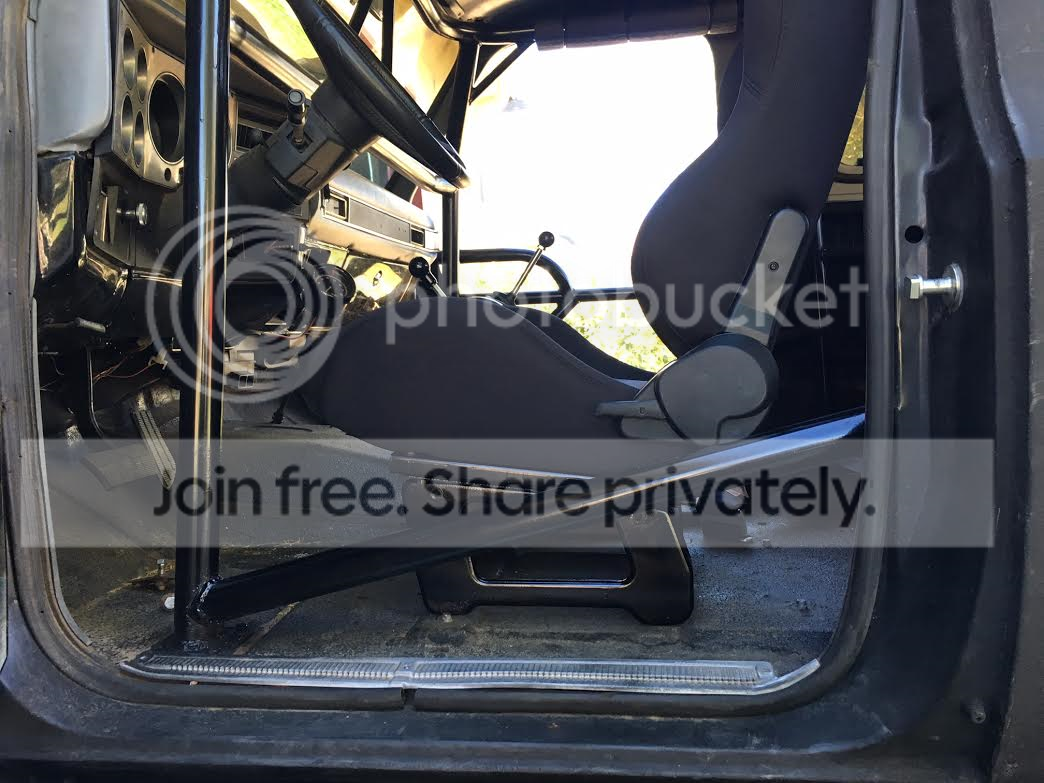

The sliders on the seats are wider than the factory seat base, so I took some metal and basically just cut a rectangle out wide enough to be able to bolt to both the base and the sliders of the sets. Here are some pictures showing it mounted:
Then I bolted it into location to see if there was anything else I needed to adjust:
And if fit like a freaking dream...I think it fits even better than the stock seats!

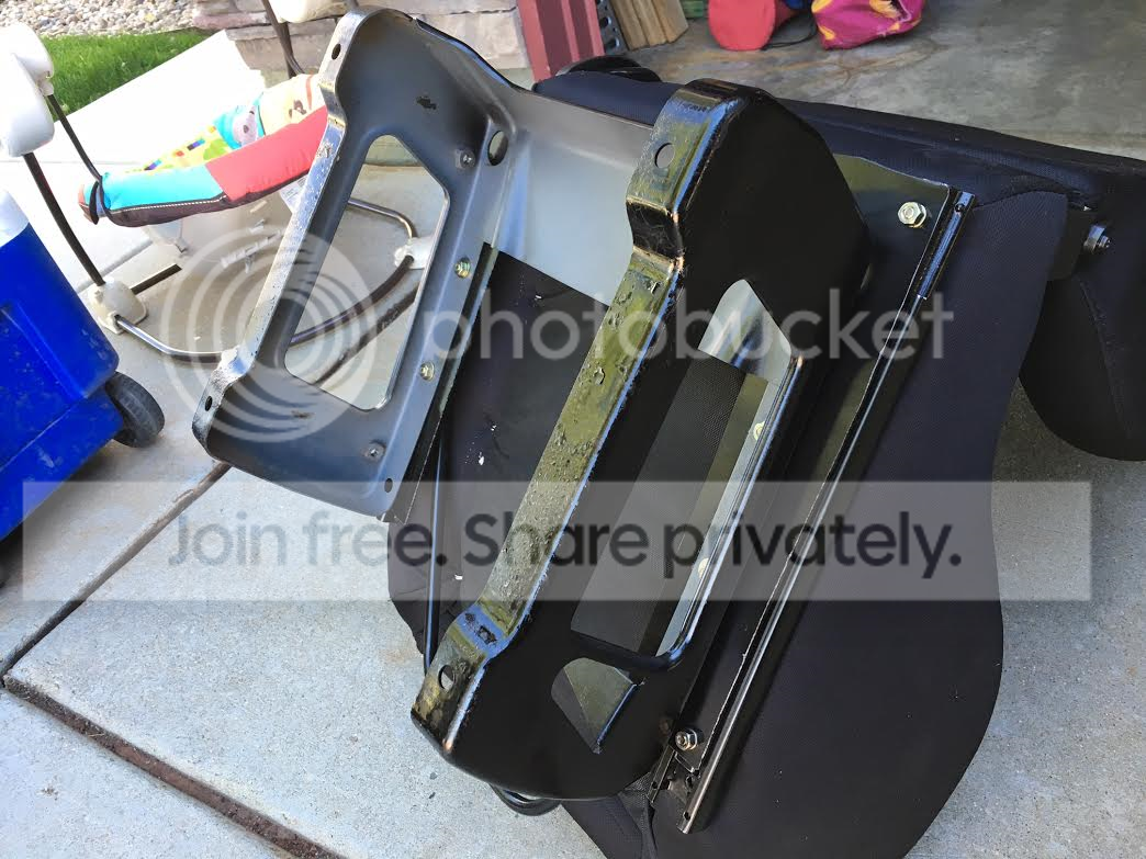

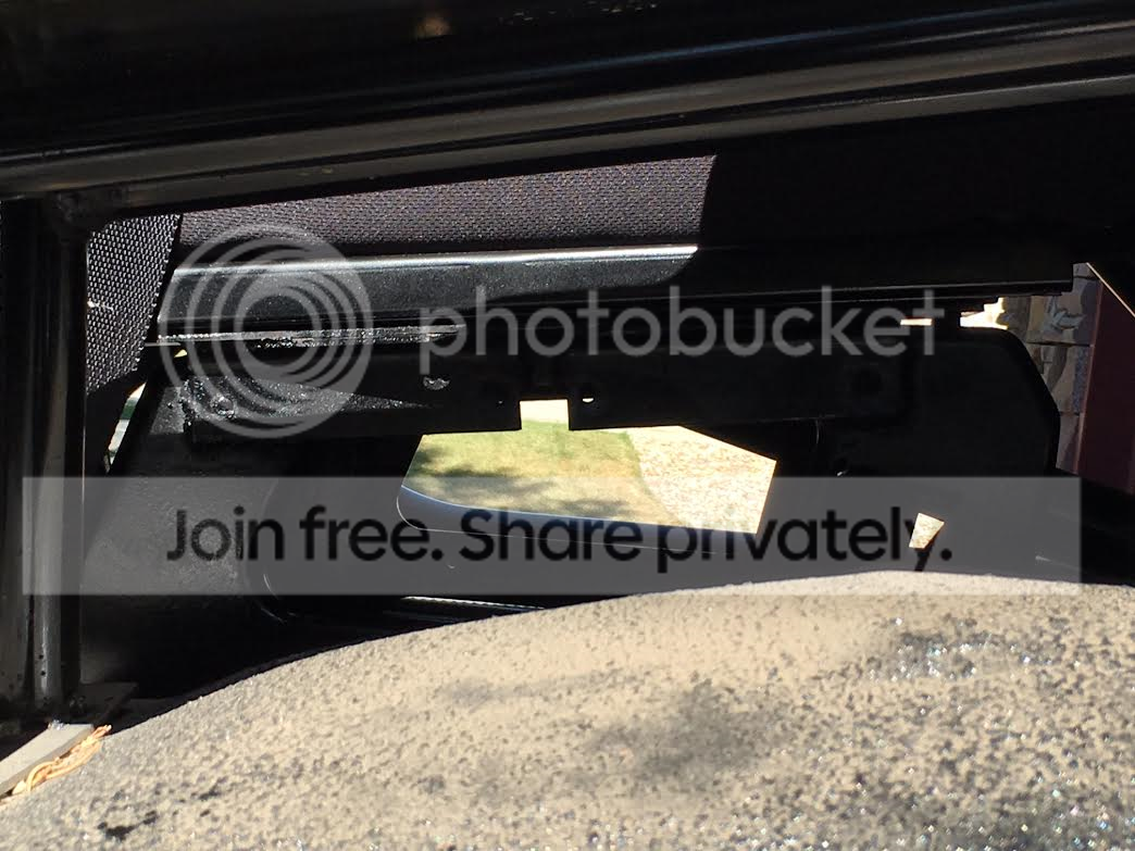

The one thing I noticed is the stock seat base has a slight "curve" on the top of it, and I bolted a flat piece of steel to it. So there was a slight bit of play from the seat and base. So I stole the stock base brackets that bolt the stock seat to the base, bent them enough to work for me, and welded them to the base and my new piece of steel to stiffen everything up...it worked really well. Here are some crappier pics showing those braces:

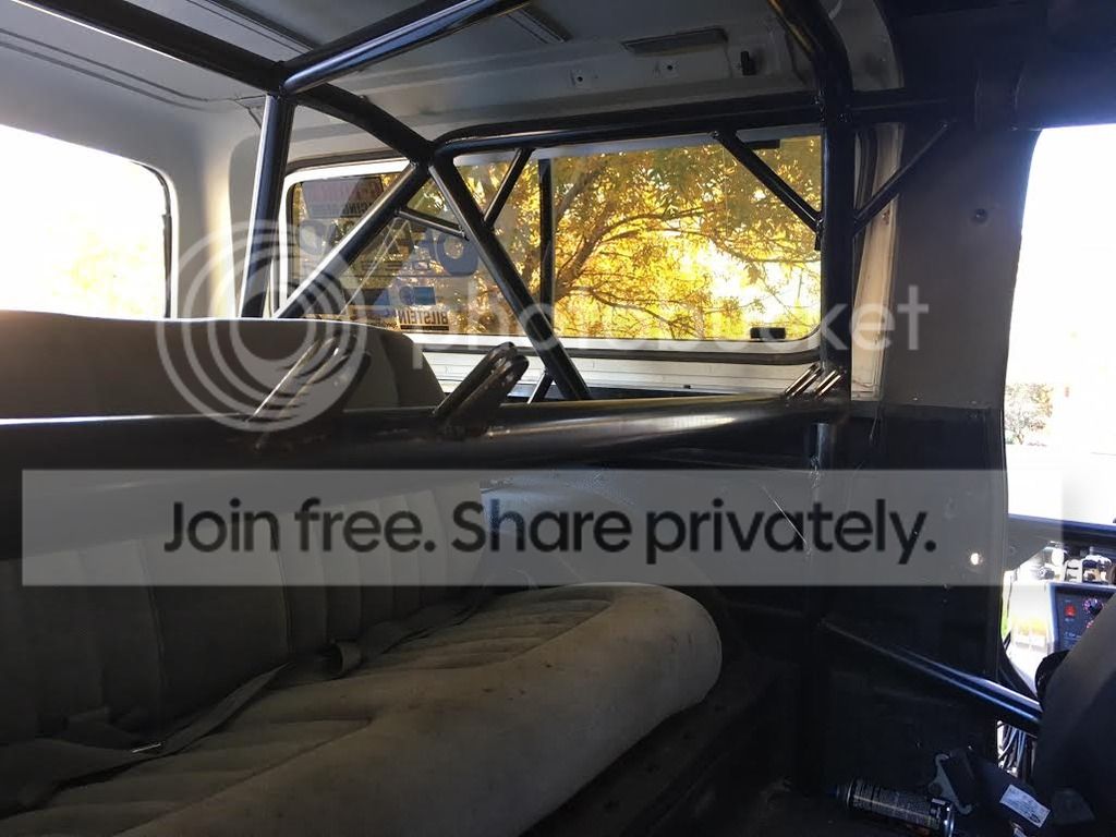

Then cut and welded up a cross-tube which is where I'm going to weld on some tabs for the shoulder mounts of the 4 point harness's:

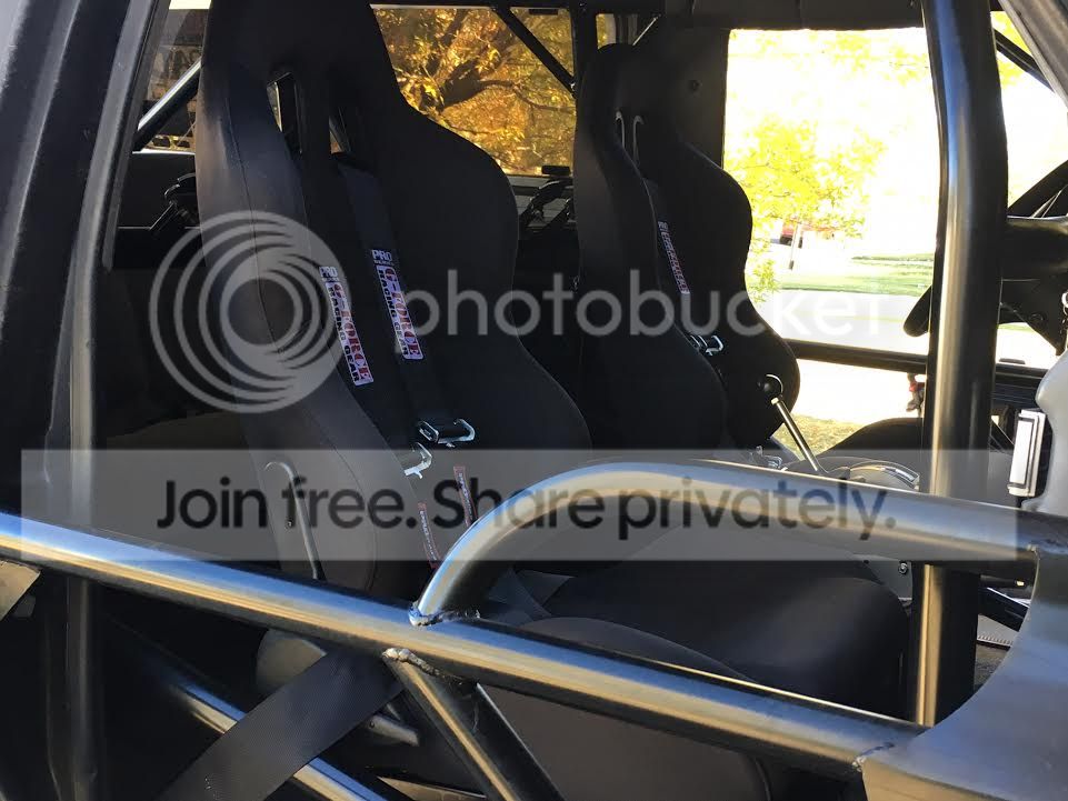

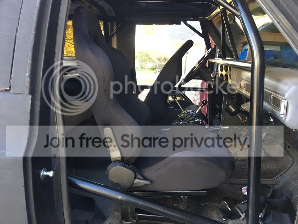

Finished up mounting my seats and getting my harness's in there:
First, like I mentioned before, my brother was kind enough to send me his stock driver seat base so I could mount my passenger seat. The only small difference I found was the footprint for the 4 bolts to mount to the floor is a tiny bit different from the driver to the passenger, but all I had to do was drill two holes on the bottom of the base to get it to bolt up, not a big deal
And the pic above is the seat slid forward as far as it will go. Did the same bracing I did on the driver seat:

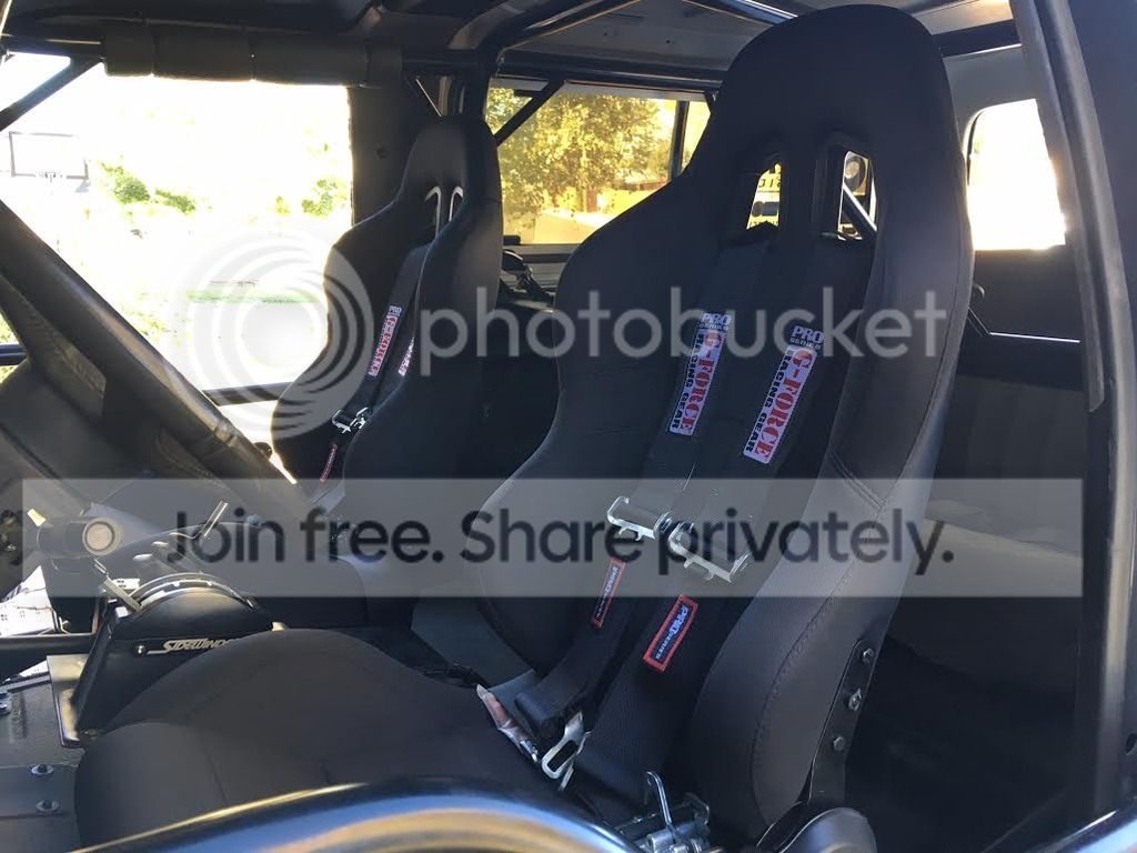

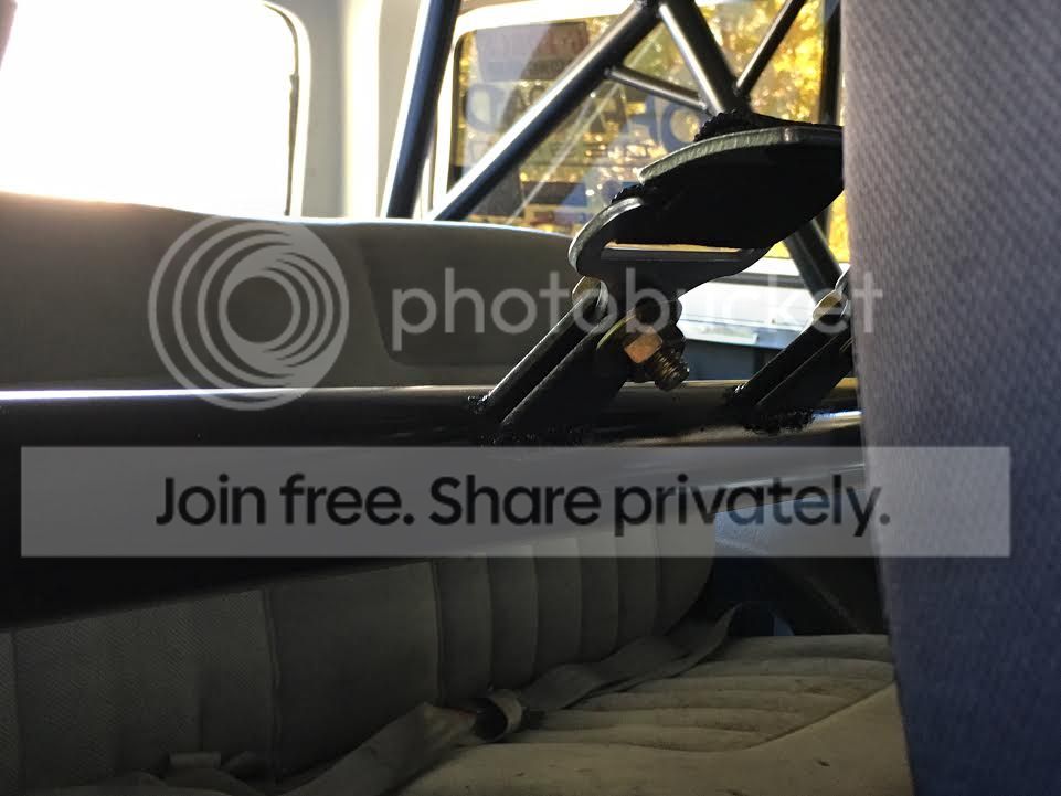

Then I got some of DIY4x's racer tabs. Talked with Kurt and he made me some thinner tabs so I could make the mounting dual sheer:
And all finished welded, painted, and harnesses hooked up:
I sat in there all hooked up with the harness's, and it's very comfortable...very worthwhile upgrade without braking the bank or getting too fancy with the execution of it :D
