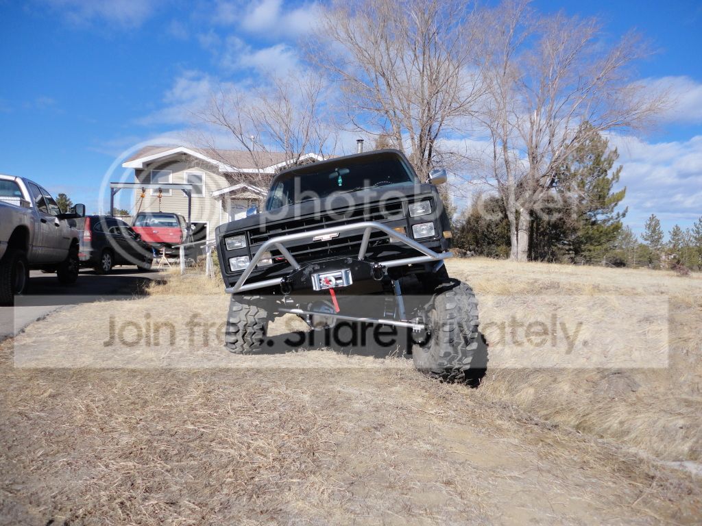

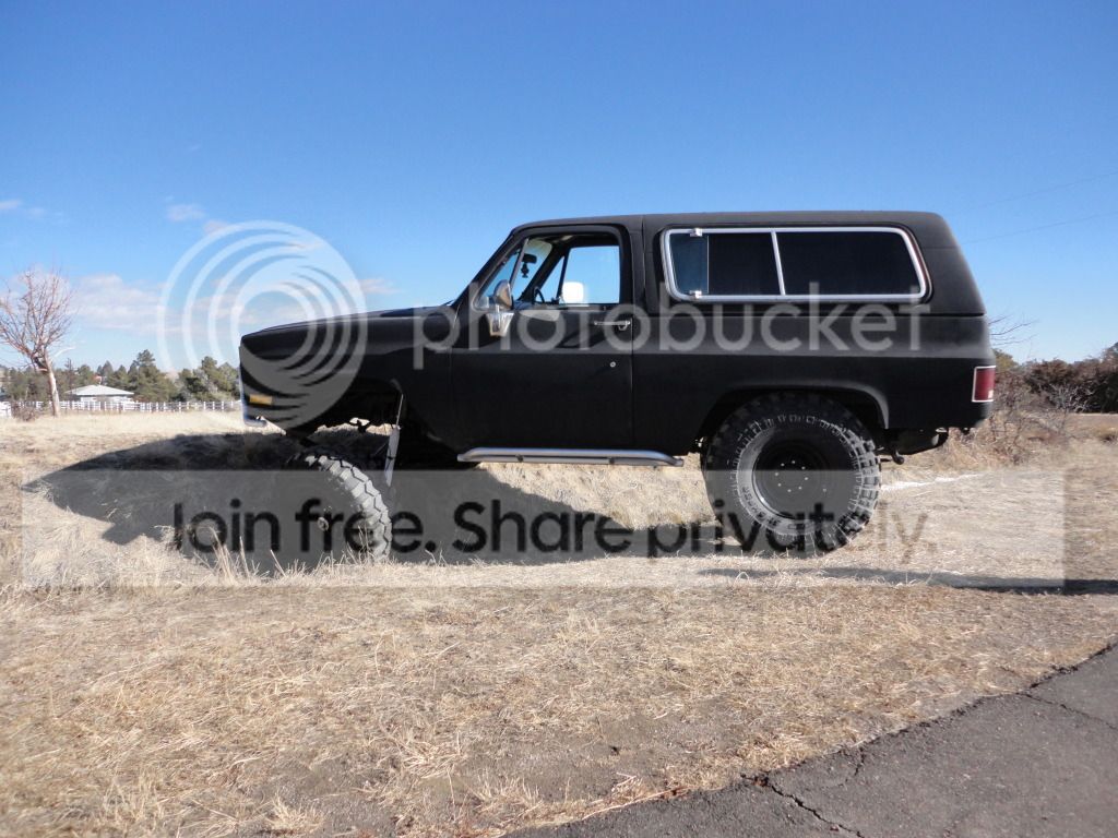

My 86 K5 build

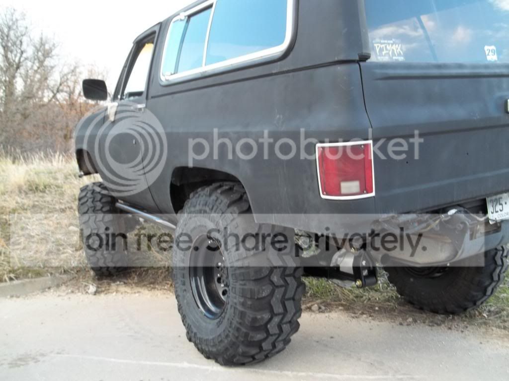

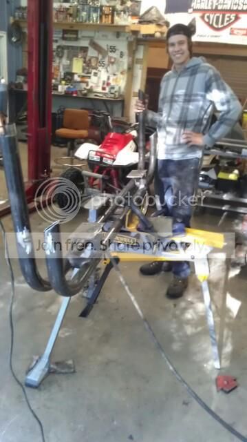

Sorry to hijack but I loves my HF bender scott
THis is all 1.5" pipe
Pipe is measured in ID so OD is really closer to 2"

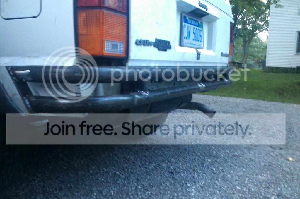

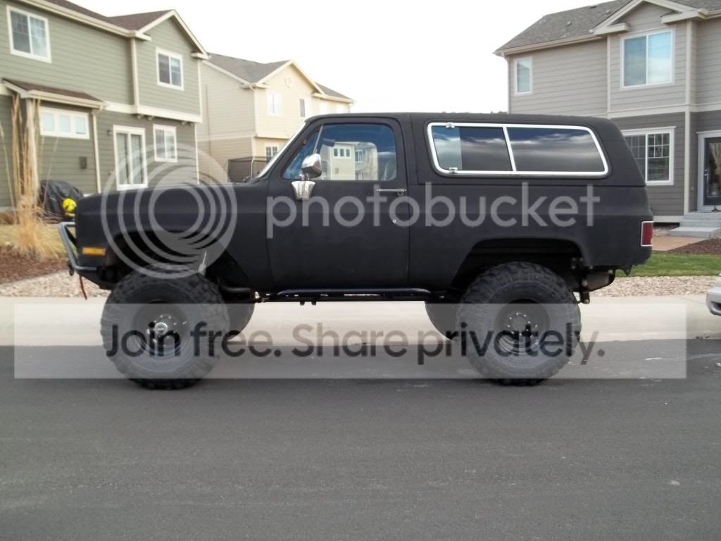

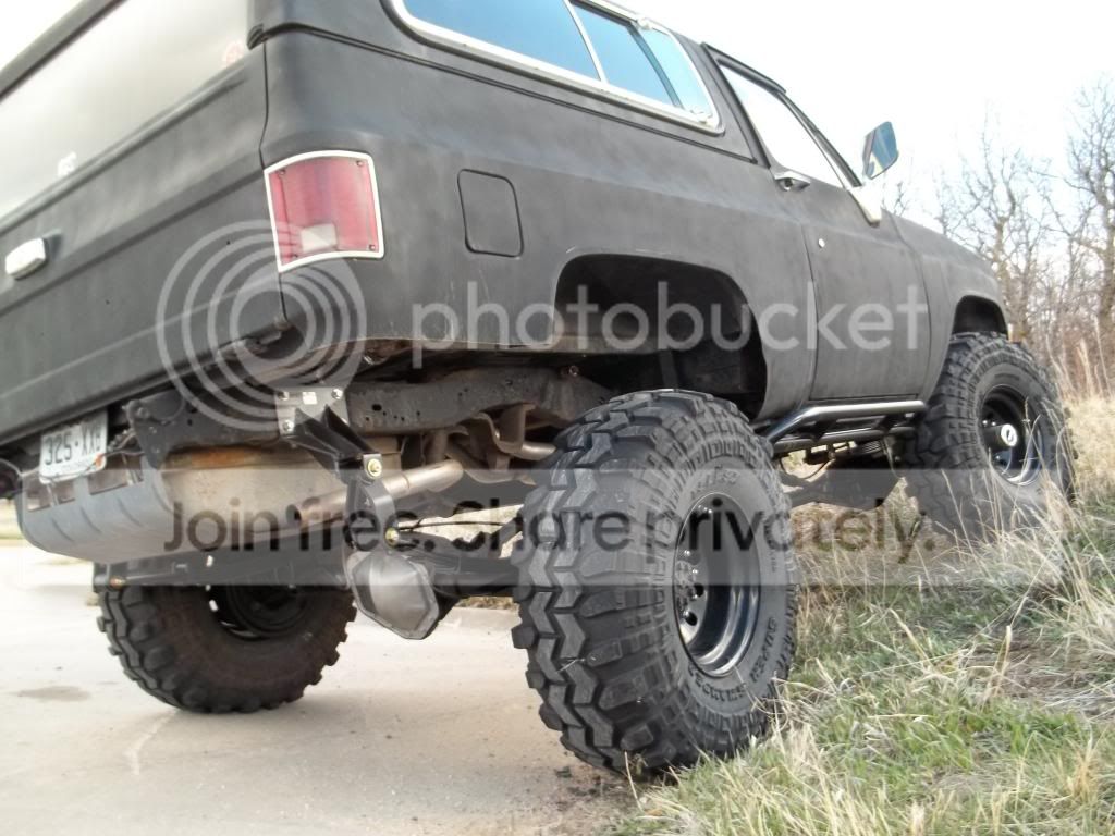

I love that last one on the chevy. That was actually exactly what I wanted to do from the start. But after looking at my abomb, it was going to be way stronger to do it the way I did. And that is they same exactly size pipe that I used too Scott.
And no worries on the hijack, that's actually why I referenced you in my last post....so you would back me up :thumb:

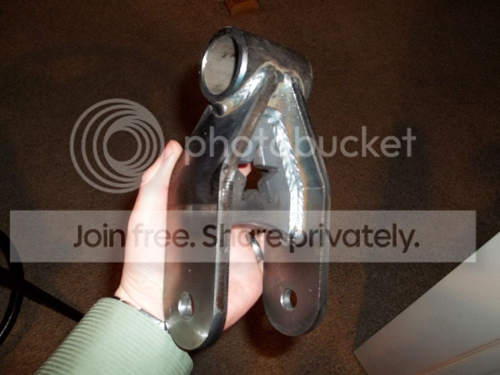

If you insist I shall pic whore.
This was just last weekend. Started at midnight, ended at 4:30 lol. And drunk off my azz.... Turned out pretty bitchin. Not even close to done.
Only pics I have of a 90. Worked pretty good I must say. And no it wasnt even finish welded or grinded yet. So mind the ugly joints, and mind my ugly mug :D

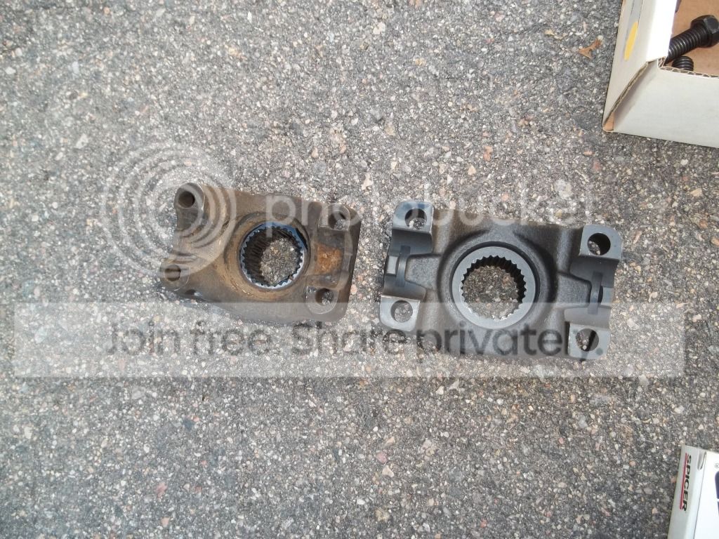

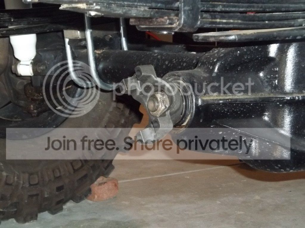

Got my new (to me) front driveshaft in. I bought it off one of my buddies Craig (icehouse) who lives just down the road from me. He is building a bad a 74 k5 that's going to be linked front and rear (if you haven't seen his build thread, check it out. That thing is going to be freaking sick). It's a full 1350 cv with about a 13 in slip in it for a fantastic deal. So at the same time I got a 1350 yoke for the d60.
1310 next to 1350

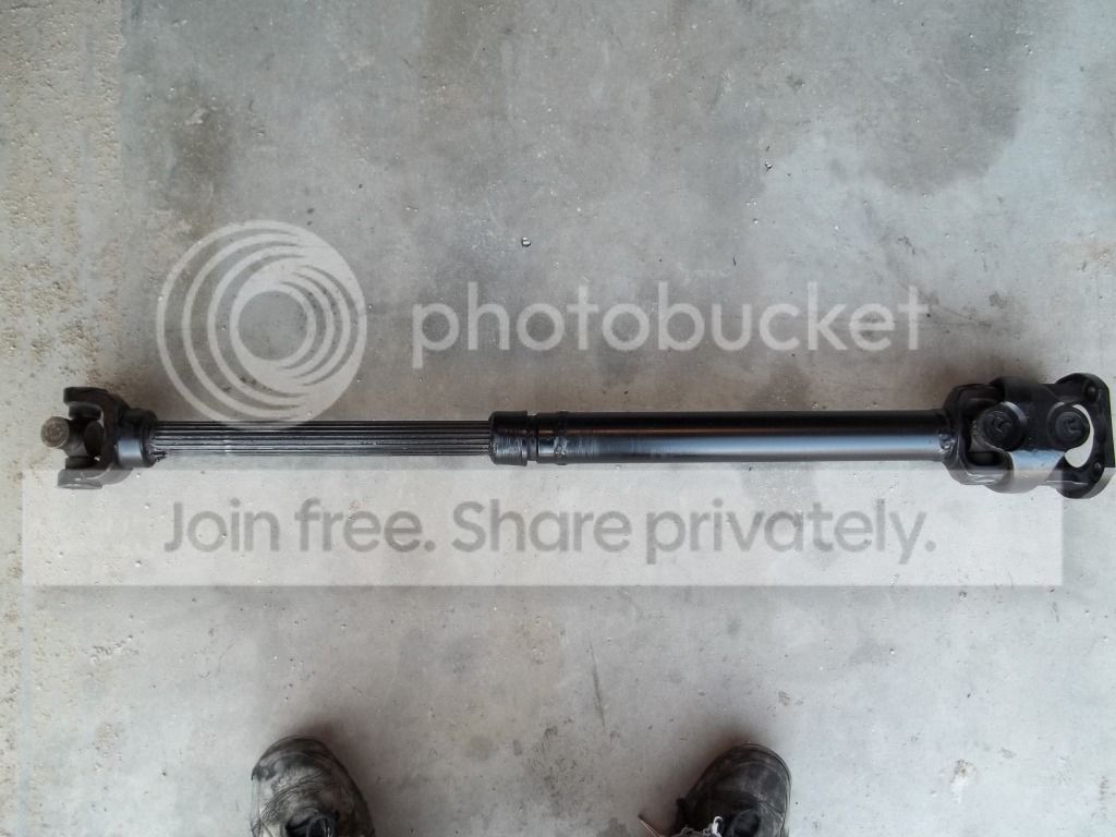

Driveshaft Compressed

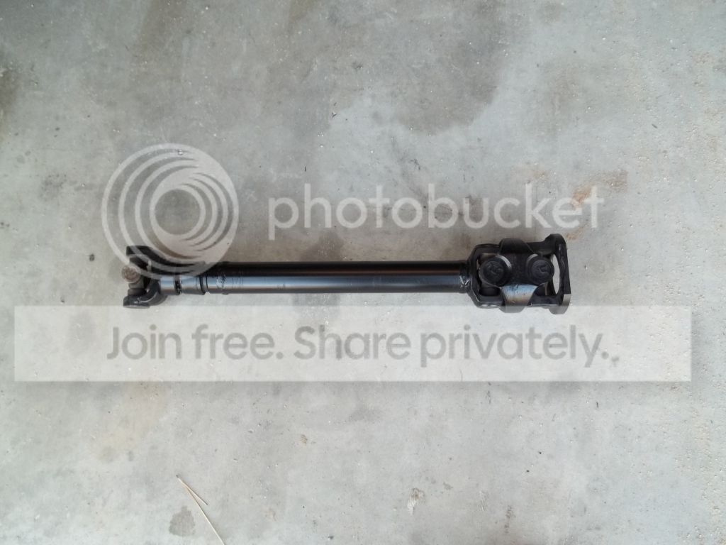

Driveshaft Extended

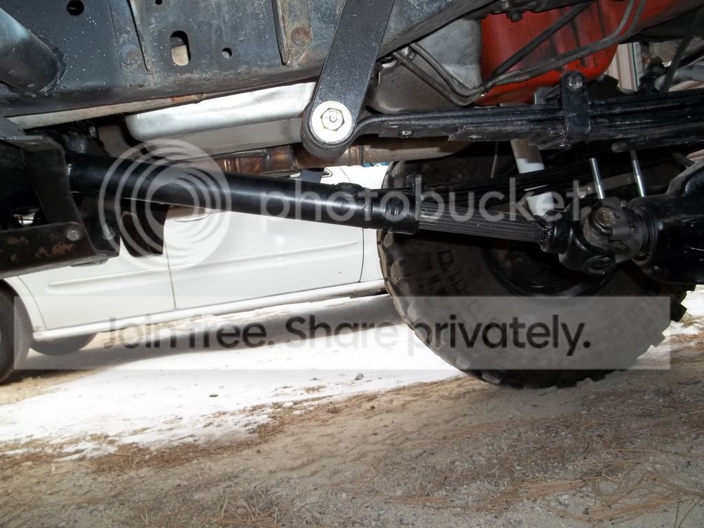

Installed
Wow I can't believe how much it flexes lol
I know right :D. I have actually decided that it is flexing so much that I am going to put some bump stops and some limit strap on there.
Not a bad idea, definitely bump stops. I ran them with stops, but not limit straps.
Yeah, the bumps i'll do first. My draglink barely contacts the crossmember at full stuff (not bad at all, but still does), so i was gonna make sure the bumps don't allow that. Then we will see with the straps, I might be fine without them. I was gonna try to make my own bumps that go in the factory location. We will see what I come up with.

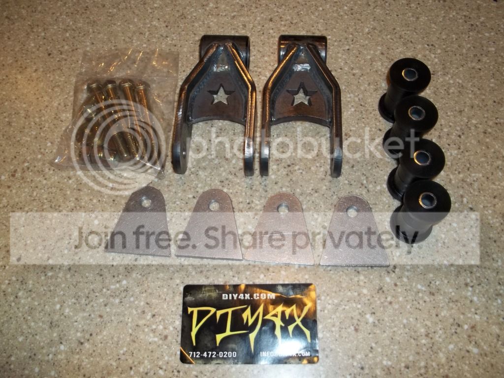

Got a couple parts in

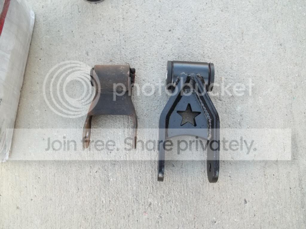

Got some 6'' shackles, some new poly bushings and greasable bolts for the rear now. Also got some shock tabs.
Man these things are so beef its not even funny. So Bad A!

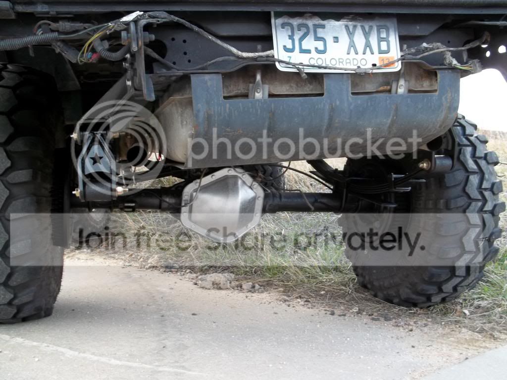

The original plan is to pull the old shackles and remove the factory bushings from the springs (not looking forward to that crap). Then I was going to inboard my rear shocks with some of the left over tubing I have from the sliders and bumper and use the shock tabs, but my exhaust is exactly in the way of where I want to put my inboarded shocks, and I really don't want to have to mess with the exhaust again (already did all of that a couple months ago). So I'm thinking of just getting some new shocks for the rear and putting them in the stock location until I redo the exhaust later on down the road. Then at the same time I will inboard the shocks. So now I am thinking I can use those tabs to put some limiting straps on the front. At the same time I do that I am going to build some bump stops too.

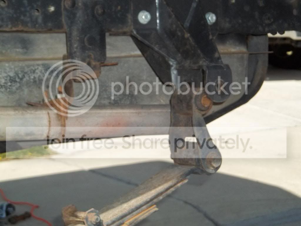

Well, i've been busy as crap lately but I had a half day at work today, so had some time to get my rear shackles on.
Taking the rears off
Old next to new. Amazing how much more beef these things are
And installed

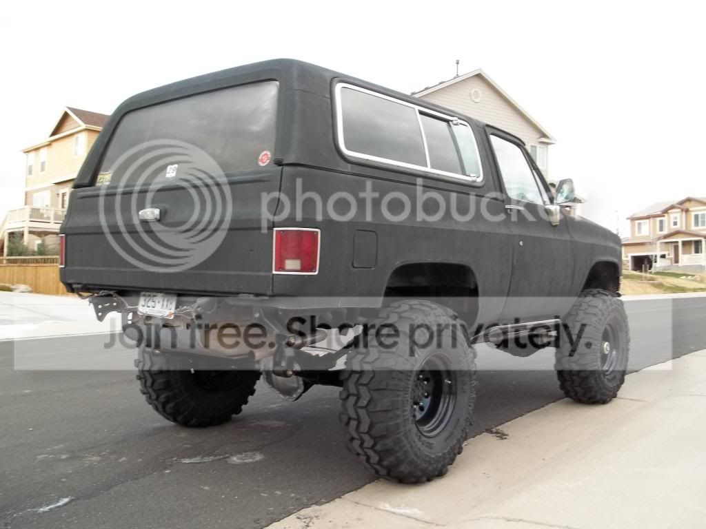

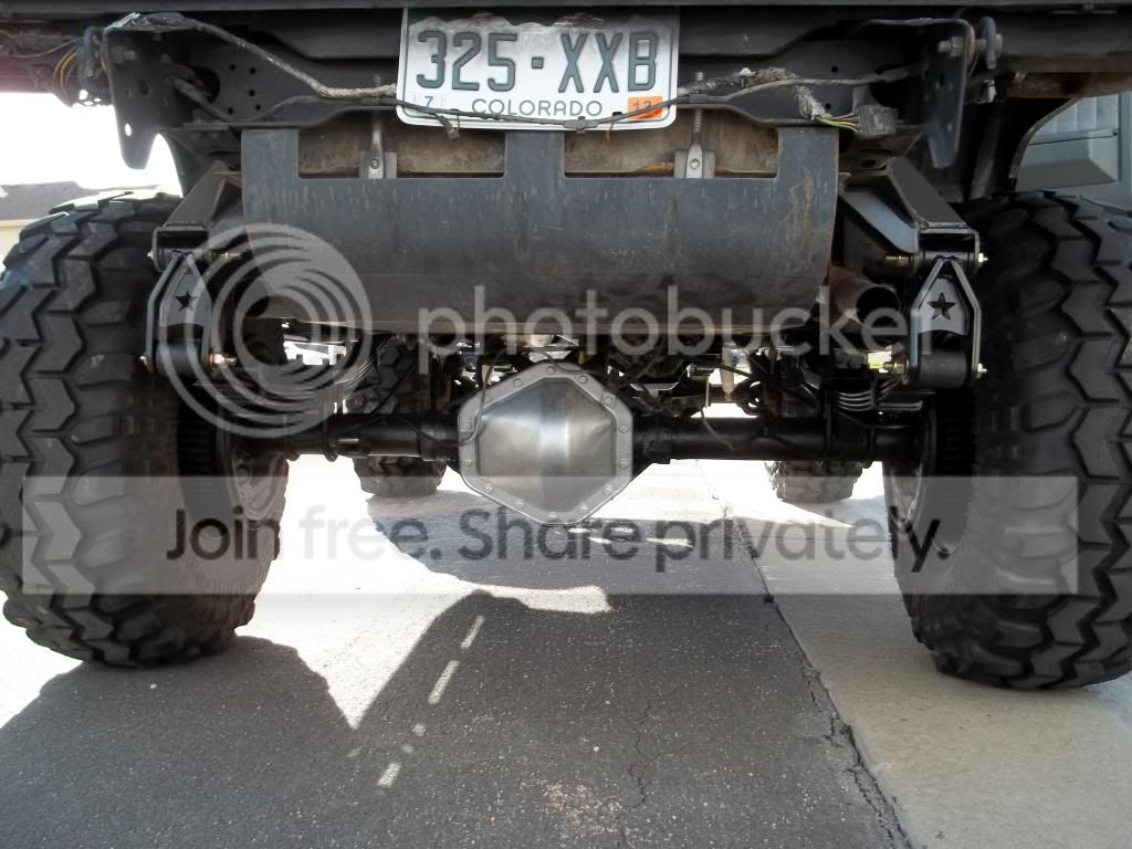

I thought I was going to need to get new shocks in the rear too, but after some measurements, I think mine are going to work just fine. As stated before, I'm going to leave them in the stock location and later on down the road when I mess with the exhaust, then i'll inboard the rear shocks. Also, the silver paint that I used on my tubes was the crappiest walmart paint out there and they were already starting to rust, so I paid a little more money and got some good black paint for now. I kinda like it that way though. I may leave it.
I think it sits a little bit more level now, which is good because when I get a bumper on the rear, I think it will set perfect. Next order for business is to reseal my tcase because it has been leaking like a siv and I'm sick of it.
