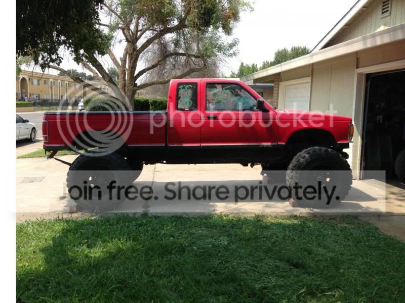

My '91 S-10 build: Ol Red

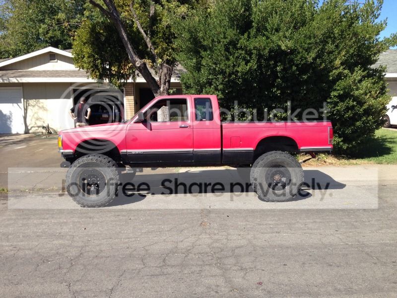

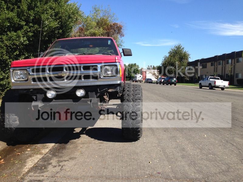

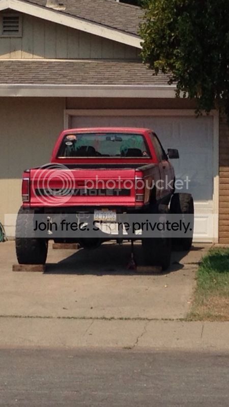

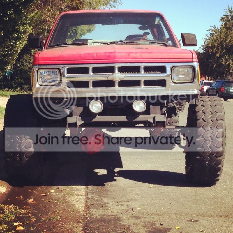

Looks awesome! Have any front / rear shots to show the stance?

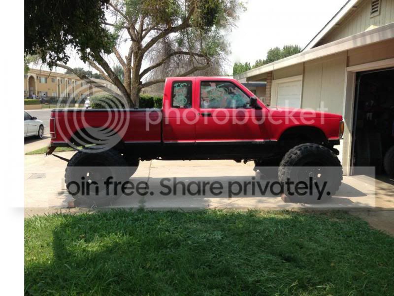

Only one inhave right now. Ill try and get a better shot once is back on all 4

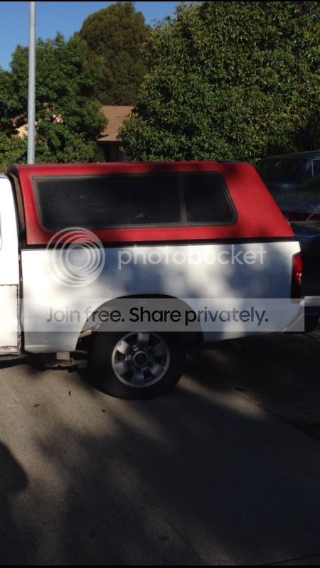

Forgot that i picked up a camper shell for it.
Ive wanted one since i got it and sold the work camper that was in it.

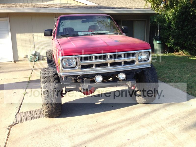

got a lot done last week.
managed to get it "driving" :haha:
didnt meet my mid week deadline but hey a win is a win right.
drove it around the block with now shocks and decided to put some on the rear at least before attempting to drive it across town.
went to do the rear wheel cylinders and discovered that the rear shoes are shot to hell so disk brakes will be on order next check.
it drove ok on the way to the new house. the ride that the sliders provide was odd compared to a conventional shackle. not sure if it was all the little things like having 1/2" of up travel before the pumpkin hit the old A arm pockets on the engine crossmember or the fact that my steering is limited from going full lock because I cut off the stupid duck bill skid (that 2wd s10s have up front) crooked or that the rear shoes being so far gone that the brake pedal is super low and if I stomped on it to quickly that it would lock up the rears (dont know why this happens just yet)
A lot of things to address and to finalize before its wheeling but Its at least mobile and I couldn't be happier with how its turning out.

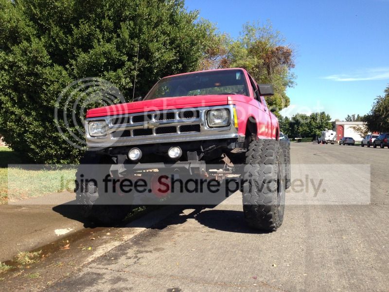

And here you can see the crossmember that hits the pumpkin and the old duck bill before i cut it off.
I plan on cutting the A arm pockets off to allow the pumpkin to nestle inside more and trim the remaining skid off to clear the steering.
