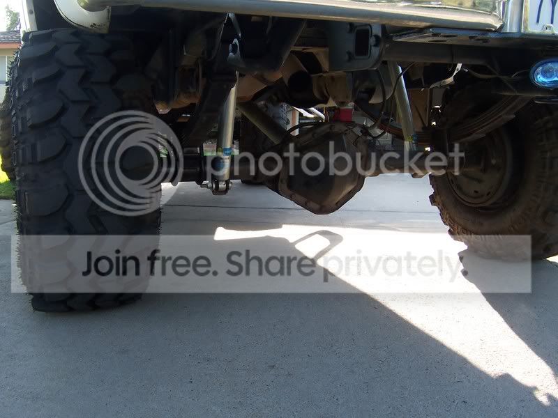

This is the first pic I ran across of when my truck used to be a truck but you can see up in the corner where I mounted my little lights...
It's been covered but my vote is to buy the smallest/cheapest lights you can find at Auto Zone/WalMart/Kragen/Etc and put them on an independent switch. Most of the time I didn't need them but when I was somewhere that wasn't well lit I could kick them on.
Mounting them here protects them very well since they're under the bumper but above the hitch so I'd drag the hitch before they got smushed. :)
