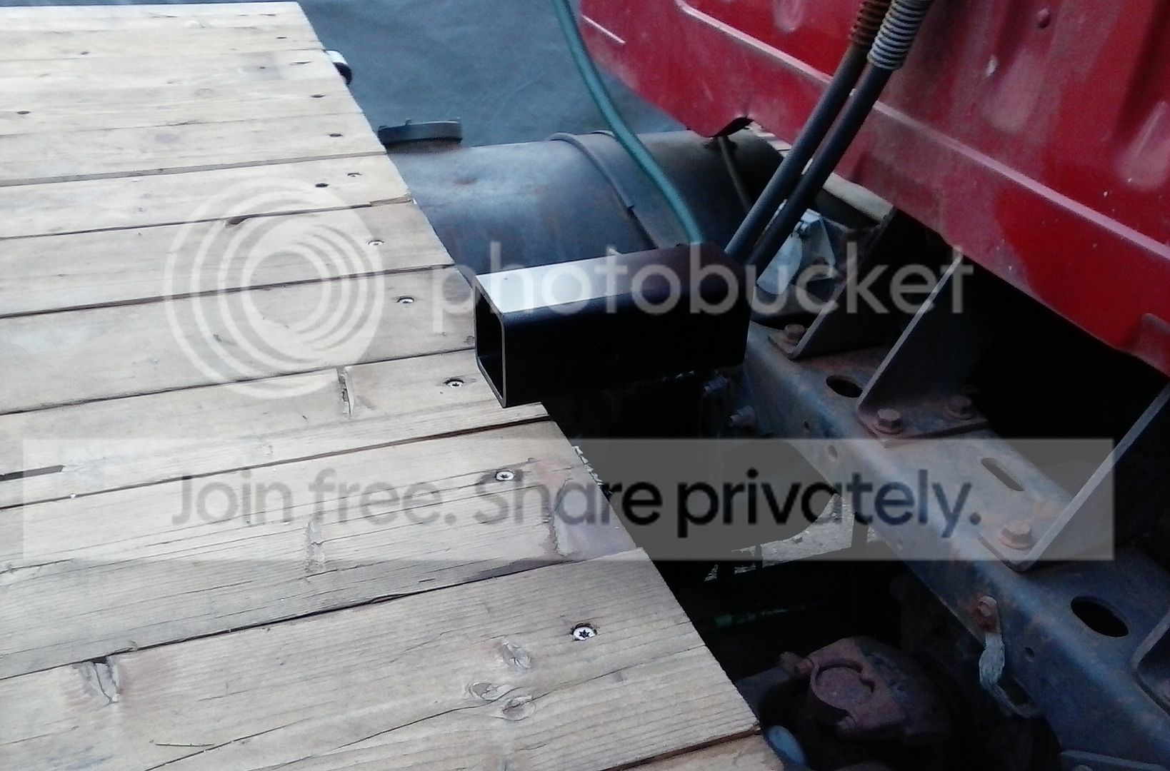

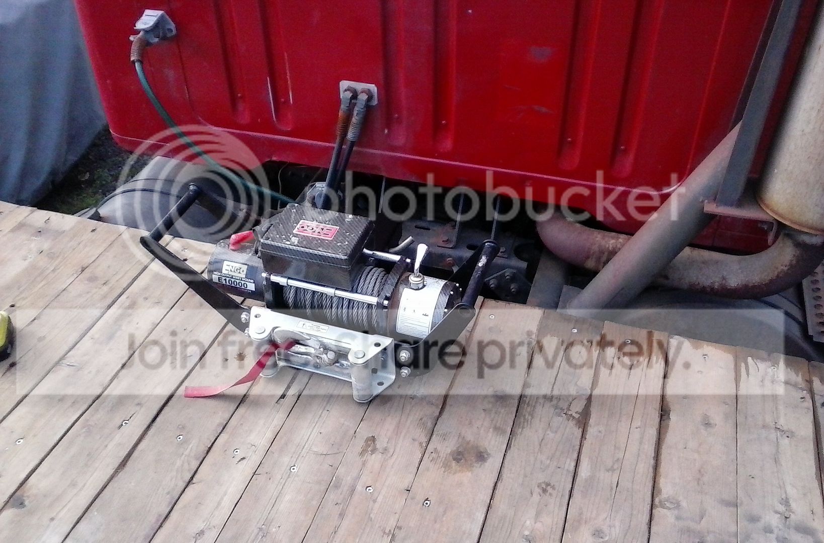

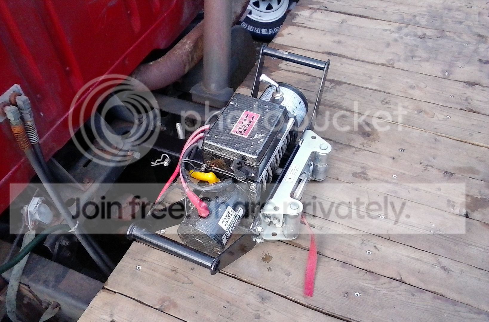

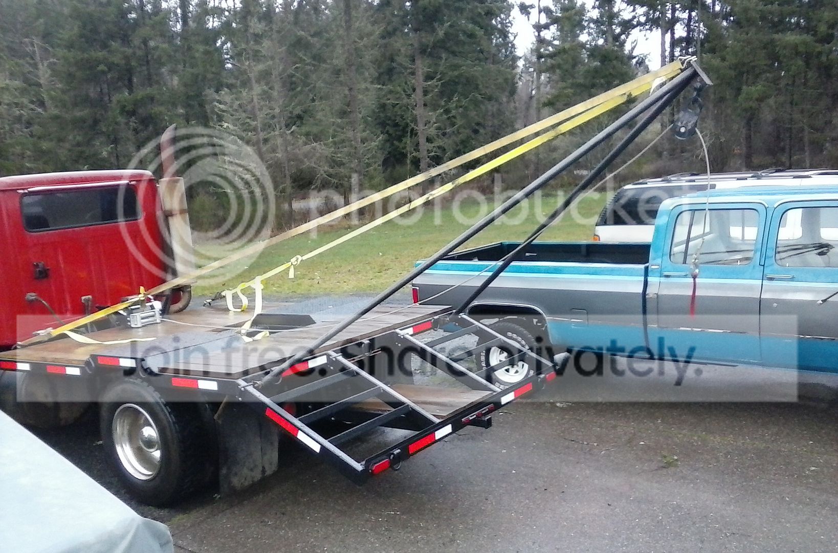

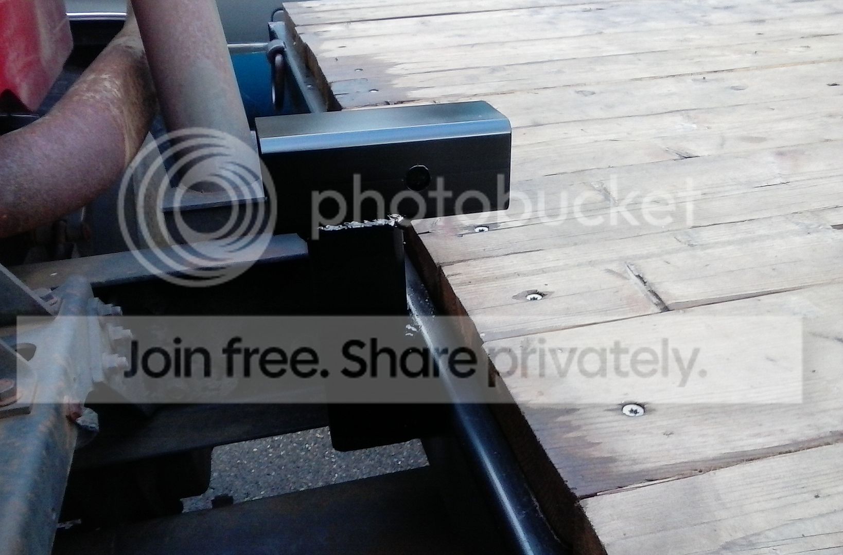

I added a hitch to the front of the flatbed, mostly to accept my winch cradle but I can see lots of uses for it.

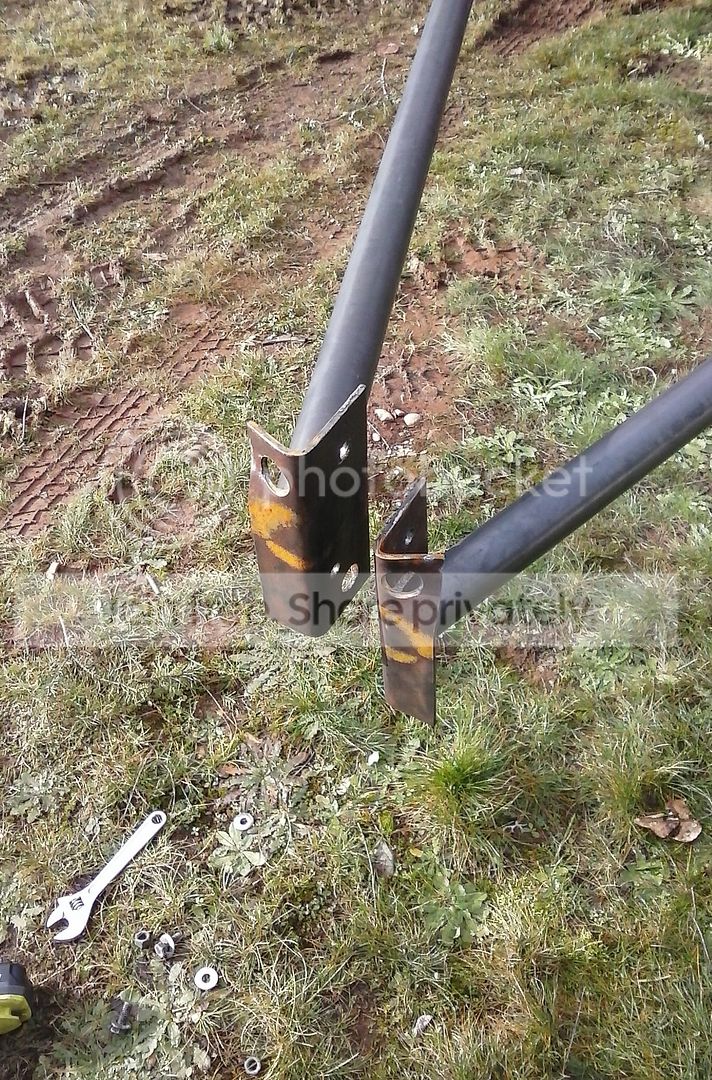

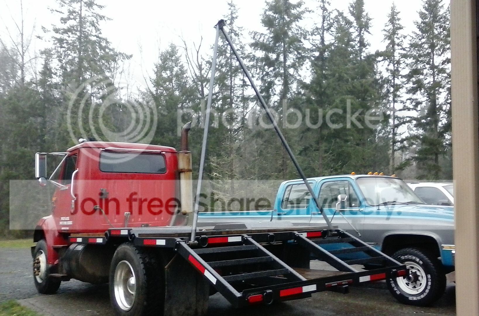

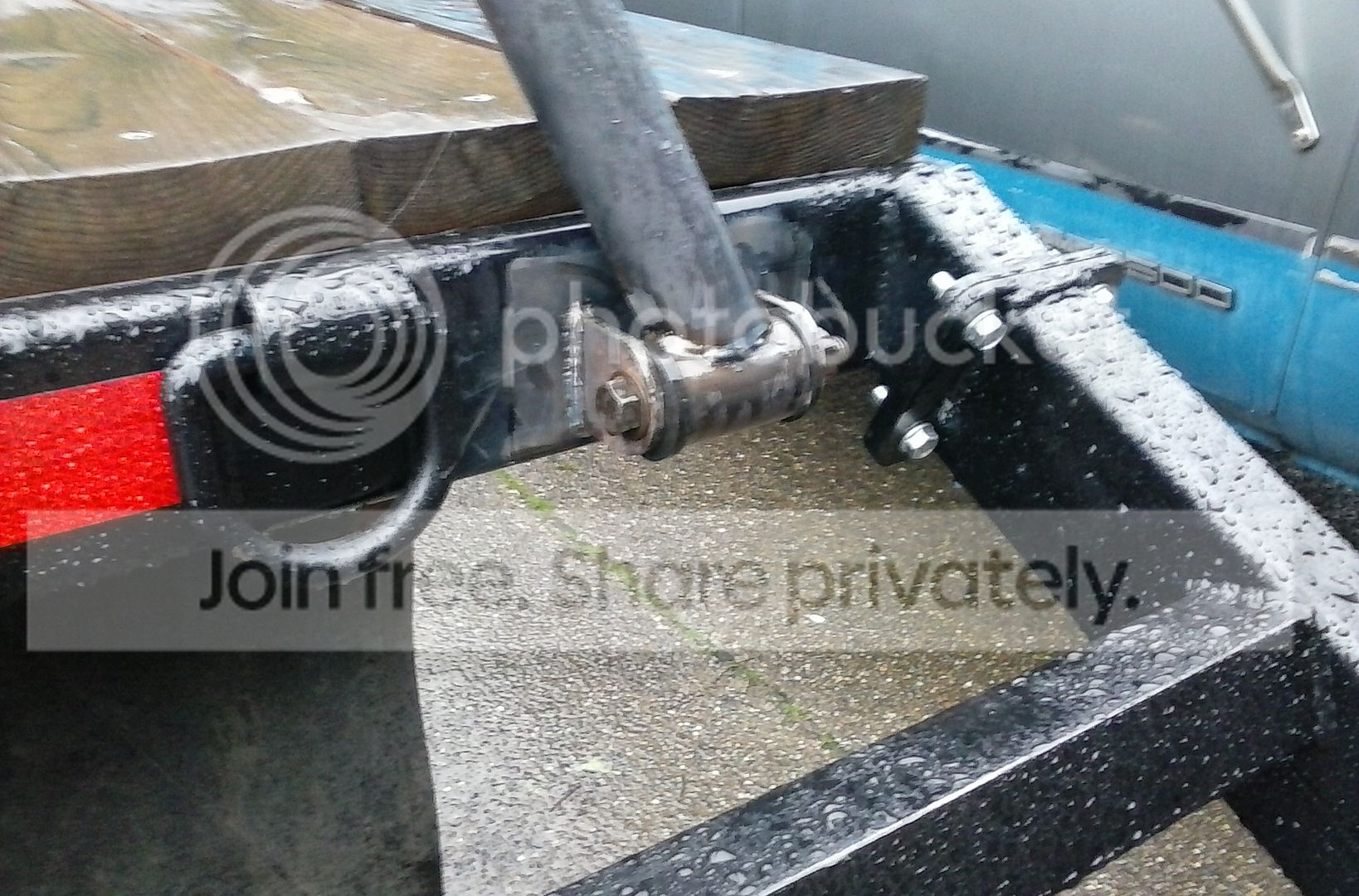

I built a simple and light 2 point crane, pretty much only designed to lift 2-3k. I just made some tabs, used bushing sets and bolts I had lying around. Tubes are 1.5" sch40 pipe.
The 2 pieces of angle bolt together. Straps hook in on top and a d ring goes through the bottom. Both sides break apart for easy storage. And yes I planned on the angle bending a little where the straps hook in.... no biggie, now the hooks go in better. The dump bed that I lifted below will probably be the heaviest thing I lift with this crane. Mostly I wanted something to lift motors/axles/cabs/truck beds etc onto and off of a trailer.
I always cut down my straps for specific uses, looks like I will have to pick up 2 more and leave them full length.

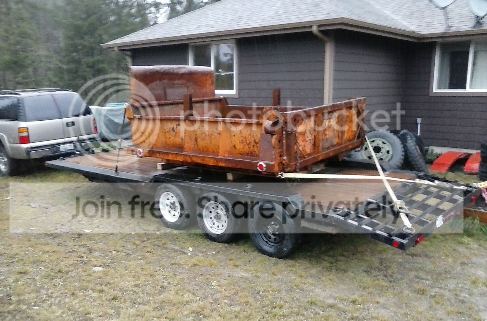

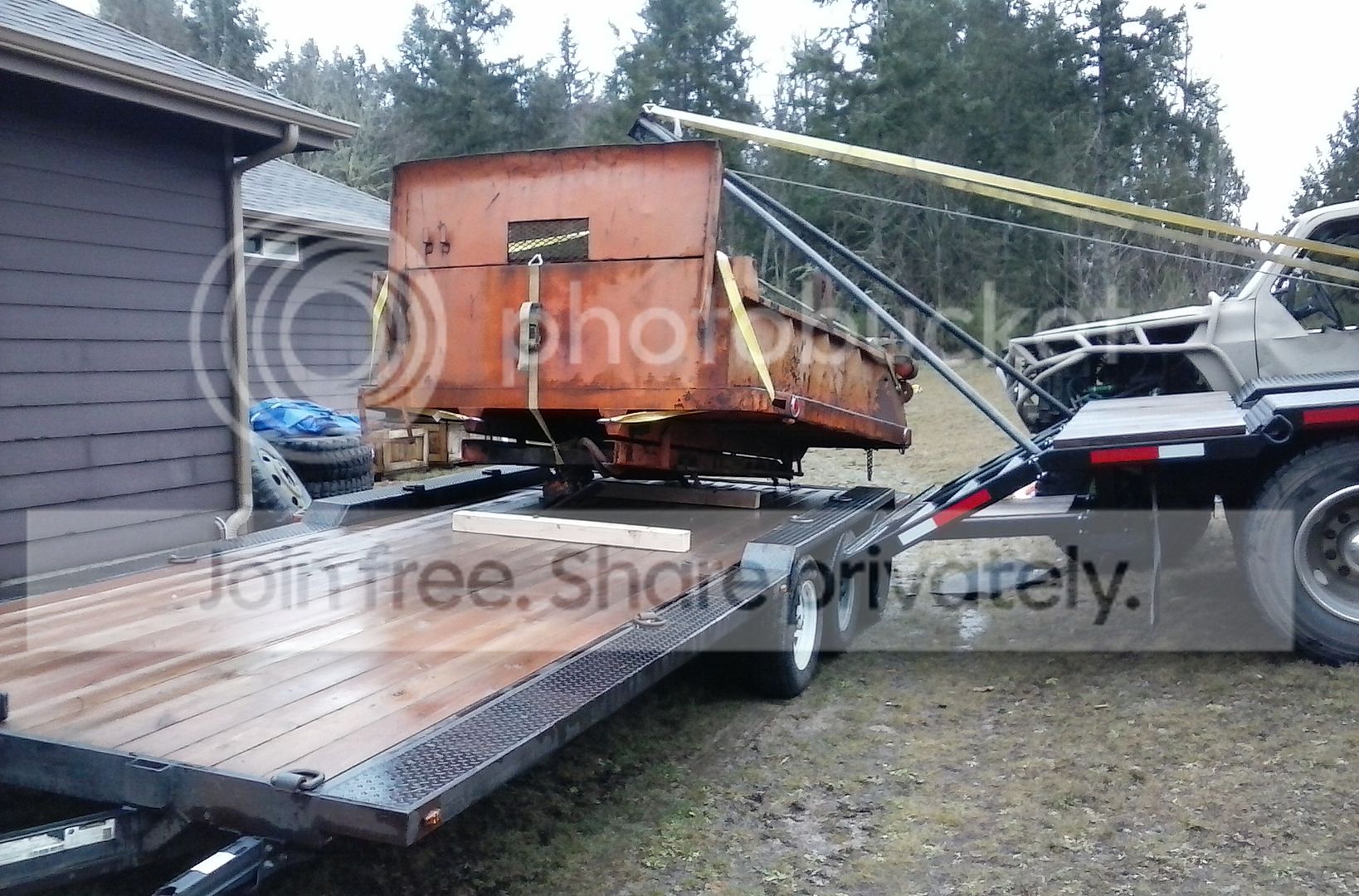

I picked this sucker off the ground and drove the trailer underneath. I still need to get quick connect wiring for the winch to work on the Intl. Instead I needed my Jimmy to supply power.
Success...
This should make moving big stuff around by myself a lot better.
looks good . I would just add a gusset to the hitch piece you welded on to help triangulate it a bit from the direct pull direction .
I know little over kill but better be safe than sorry .
