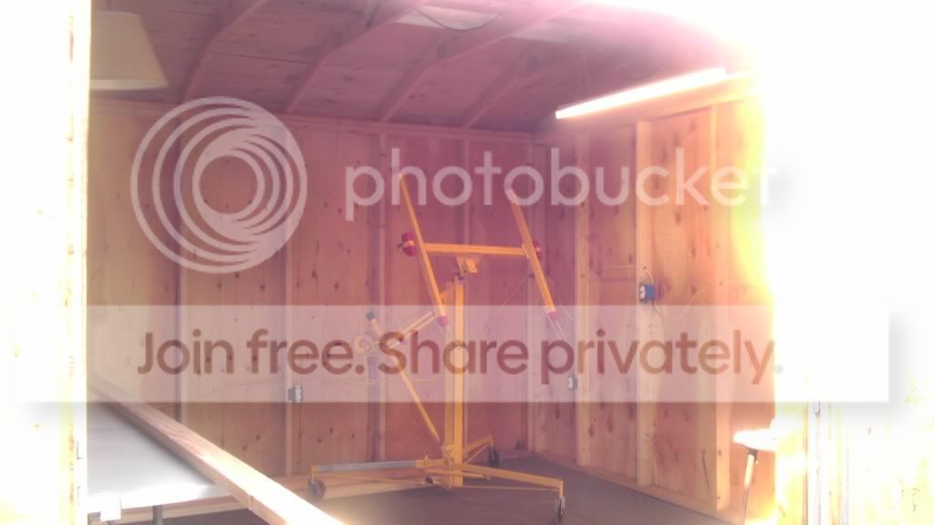

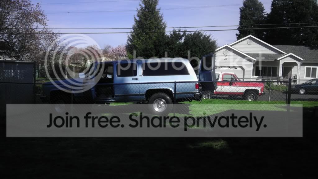

Just quick pic of it being to put to work some more. This was just me unloading a drywall hanger. Anyway, i have about 100 miles on the 5.3 now. Still runs good! Also still need the exhaust done... Calling today to get a quote.
