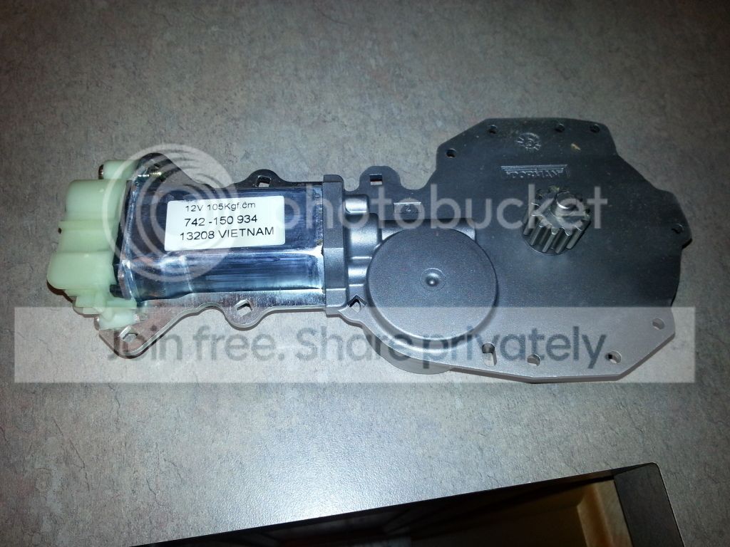

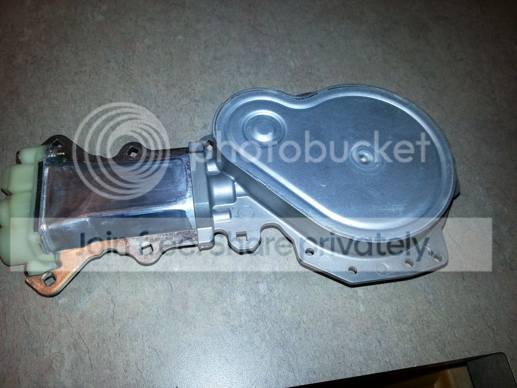

Got my window motors today. They are Dorman units. Dnt know how they work yet, but i was excited to see that they were indeed 100% brand new and look more stout than stock.
Here's some window motor pics for fun. You can see they have a cast gear housing which should make them a tougher unit than the stock all stamped units.

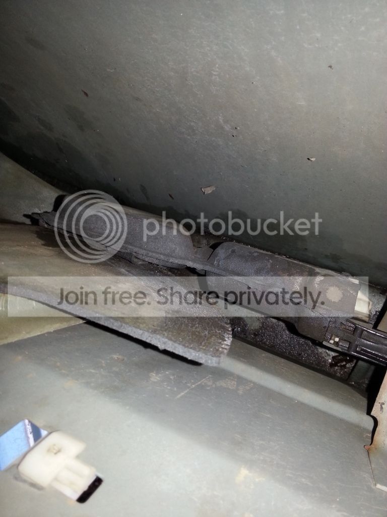

Straight from Nam!
Old
Sweet, those do look better than stock ones. I'll eventually have to do all the window motors too.
