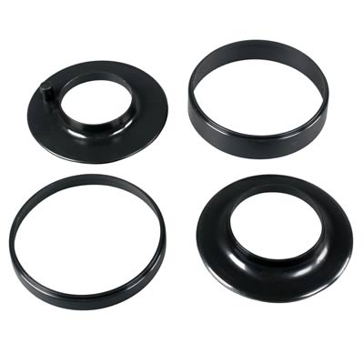

Got a link? Not sure what I should get. I would much rather run the stocker if possible.
They do make spacers to go under them too you know.
I already have a 1" spacer under the TB. The HAT is missing by about 1". Any kind of spacer would probably be fine with HAT to hood clearance. Never seen one though. :dunno:
The link has a couple in it,
http://www.summitracing.com/search/?keyword=air%20cleaner%20risers&dds=1
