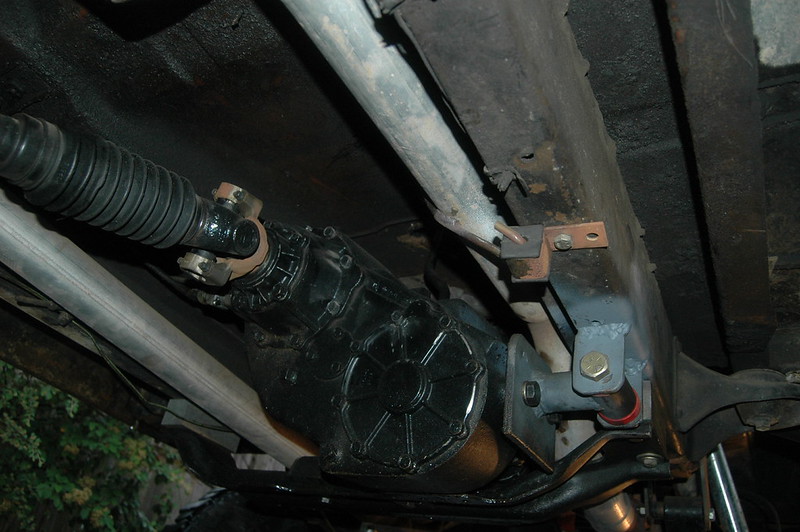

Hi all,
Long time lurker! I love this site. I used to own a nice 1988 Suburban, and have always missed full-size Chevys. I came upon a rather good deal in the Sacramento area that I had to jump on:
1977 Blazer
- Dana 60 F, open
- 14 Bolt rear, open, disc brake conversion
- 90% 38.5" boggers on new 15" steel wheels
- 8" lift, springs F, blocks R.
- NP 205 with extra crossmember support
- TH350
- Fox reservoir shocks F, Procomp's rear mounted inboard.
- 454 bored out to "582" (yeah right) with comp cam, lifters, edelbrock carb, holley manifold, serpentine. There were no receipts for any engine work, so who knows! It sounds good!
-Dual exhaust through 2 flowmasters
- New battery, nice bench seats F &R.
The bad:
- body rust on rockers, A pillar, etc..
- None of the gauges work.
- Hood doesnt close at the back, rear window crank is difficult.
It was $2000, which was a steal, and it runs well.
Here's my question: I'd like to end up with a NICE K5 6.2 Diesel, 4" lift, 37's on H1 beadlocks, D60, 14 bolt, doubler.
Should I have some fun with this and try to sell it for $4-$4500 as is, or pull the axles and sell it on 1/2 tons that I'd have to buy? OR just try to build this truck into my end-goal? I think I could get more than $2k for it on 1/2 tons, so I'd end up with free 1 ton axles, but that's a lot of work...
Thanks for letting me think out loud! I"m excited to be building full size again.

For $2000, you did good. You've got a helluva starting point. For a little bit more, you could make it really nice - rust repair, paint, get rid of lift blocks, go to crossover steering, etc.
However, If you're dead set on a 6.2 (why?) on beadlocks, etc. Maybe swap axles and sell it as you suggested. It will cost you more in time and money to convert this one. Maybe use the profit to find a rust-free truck.

Personally I'd sell that motor and drop in a fuel injected 350, build rear shackle flips, and use the lift blocks as door stops.
What gears are in the axles?
(The wrong gearing alone can kill your MPG.)
For on-road use with 38.5" tires you'll want 4.10 or 4.56 so you aren't always running wide open on the road.
I'm running TH350/3.73 gears/37" tires, and turn 2,000 RPM @55mph, I have a 4.56 rear that I was going to swap in later but I like it the way it is.
I would do like you said. Buy a nice (newer) 6.2 Blazer. Cobb the parts from this one for your new rig, and sell this with the left overs.

Best advice here. I fully support the 6.2 idea. I have one. 35" tires 700 trans and 4.56s. I hear of people getting 15 -17 mpg out of gas motors but at my elevation none of my motors or any of my buddies have been able to get much more than 12. With a lift and tires. My 6.2 gets an average of 18. On a flat highway if I keep it at 65 I have gotten 20 mpg. Even with the price difference between gas and diesel it makes sense for me.
Also the 6.2 700 241 combo I have is awesome off road. I have no desire to put a doubler in it. I was super impressed the first time I took my 6.2 off road

Just make sure you use a tape measure before using one of the RPM-gear calculators. My 37" military tires actually measure 35" tall. That seems to be a common theme with big tires. They never measure to match the size on the tire.

If you plan to drive on the highway the transmission you use also matters.
You can gear it a bit lower with a 700r4 than a TH350 because the 700R4 has overdrive, whereas the TH350 does not.
My suggestion for 37" tires would be.
Th350 - 3.73-4.10
700r4 - 4.10-4.56
(High altitude mountain men will disagree)
On a completely unrelated note, while I think doublers are great being cast iron and all. An NP241 would give you a 2.71:1 low range and is roughly 350 lbs lighter than a 4:1 205/203 combo, and it's a whole lot easier to install.
Another option (if you are lucky) might be to look into the 4:1 NP241OR out of a Heep Rubicon, but I do not know if they can be made to work on a GM tranny.

Until you start doing some pretty serious stuff a 700s 241 combo will crawl awesome with the 6.2. I have 4.56s and 35s and I think they would be fine with 37s.
I would definately try to find a later truck with a 241 though

Look for 88-91 Suburban's for the passenger side drop 241c. They are all drivers side drop after that.
A 208 (2.62:1 low) would work too but they claim the 241 oils better.
