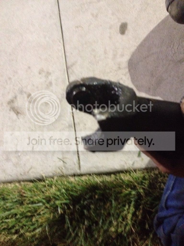

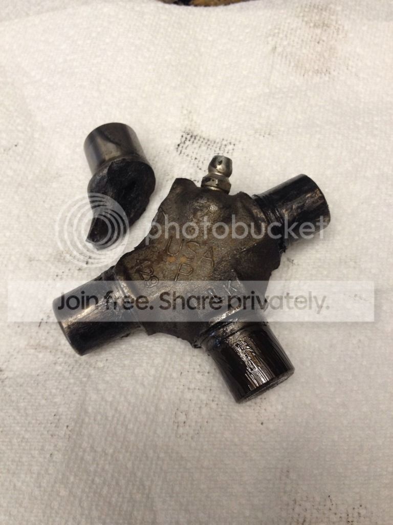

And this makes it u-joint #5 and yoke #4.... It's been over a year and a half since the last one. I would say I gotta stop doing that but I know I wont:whistle:... So I'm on the search to upsize my driveline. I found a shop nearby that will shorten and balance drivelines for 60$ so I think I'm going to head to the wrecking yard and pull a 3/4 or 1ton driveline and have it shortened. I'm looking to up to a 1330 or 1350 u-joint aswell. Anyone have an idea what I should be on the lookout for?
I beleive 1350 yokes from a 14 bolt semi float will fit right on the pinion splines.
It will go right into the 12 bolt? And I thought about just using a conversion joint and start looking for a 14 bolt FF and the parts to change my d44 over to 3/4 ton and just be set
Oh idk about 12 bolt. It will on a ten bolt I think. Well Ive switched a ten bolt yoke onto a 14bsf before, so I imagine it works in reverse
Alright I'll look into it, I should be at pick a part this weekend and I'll check some yokes.
