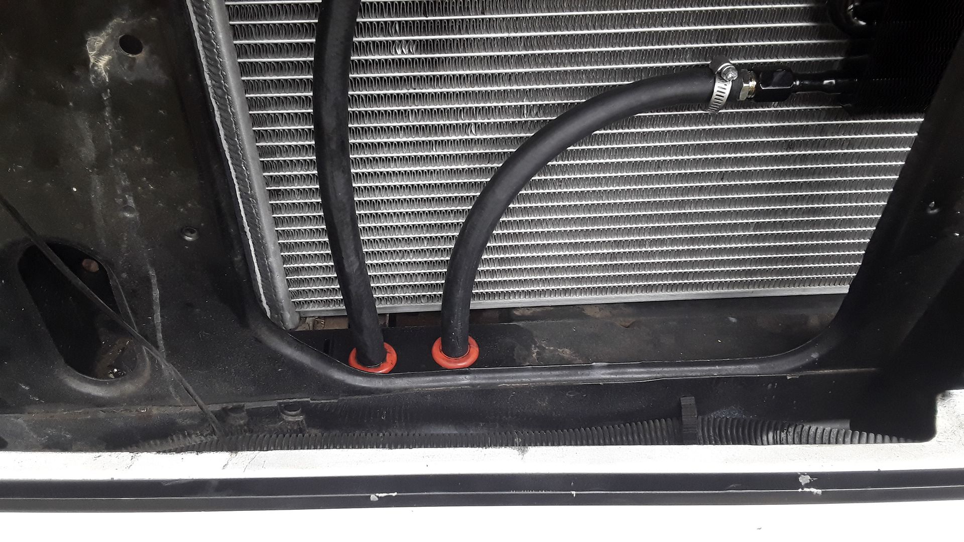

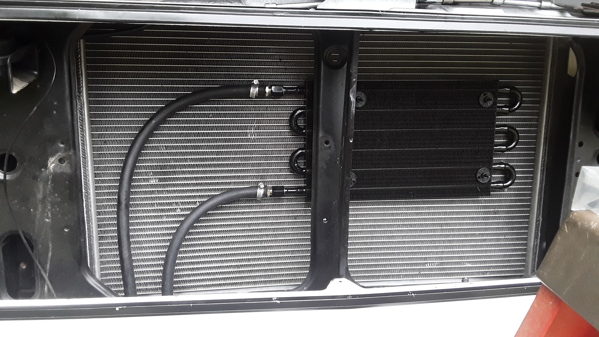

It been awhile since I've really done anything to the "beast" but today I installed a shift kit and a bigger trans cooler. I've been working on my sons truck and it's almost ready for the road.
Drilled some holes in the core support so the hoses could be routed neatly. Grommets were used on the bottom too

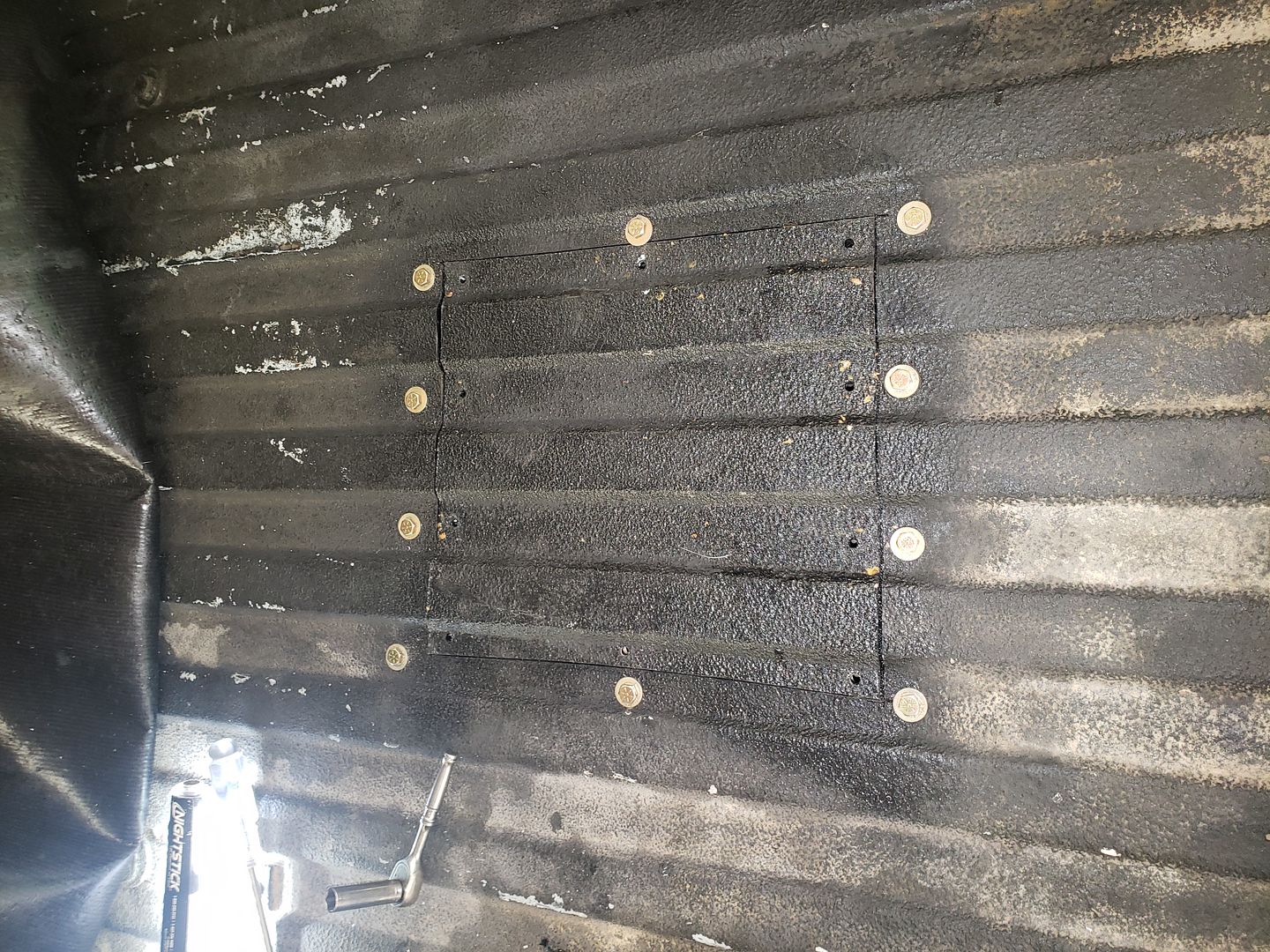

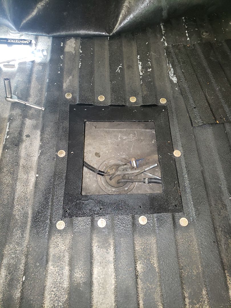

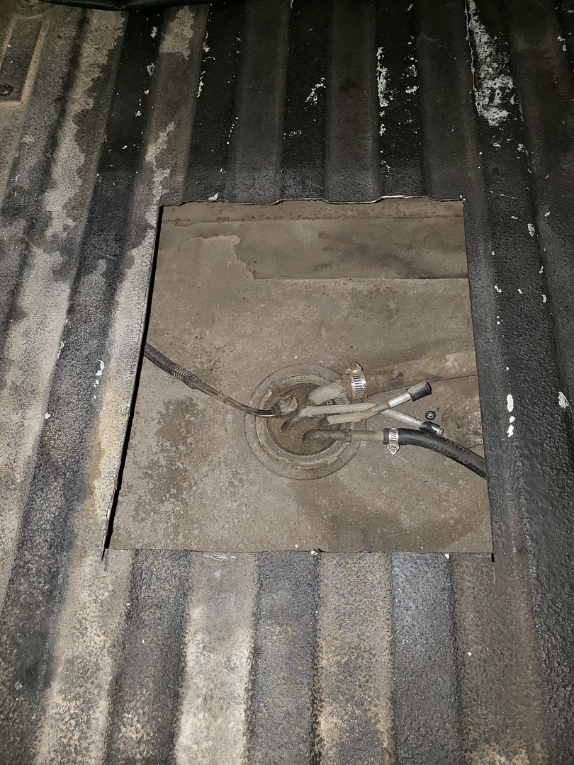

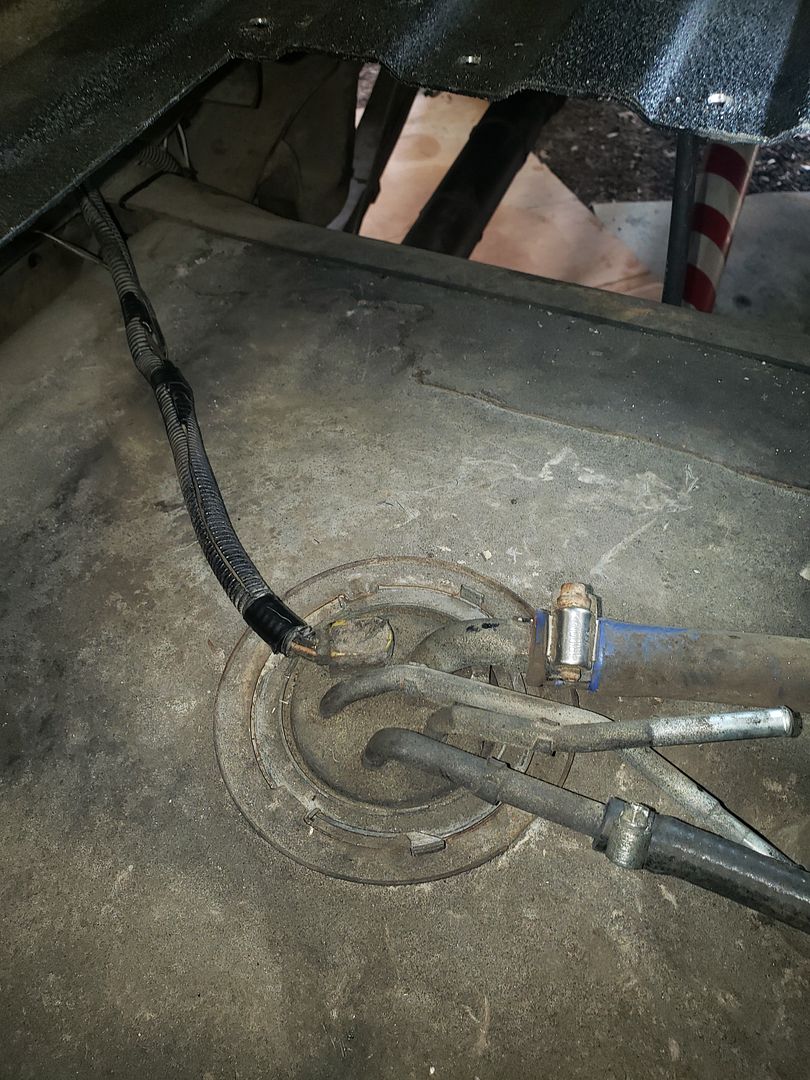

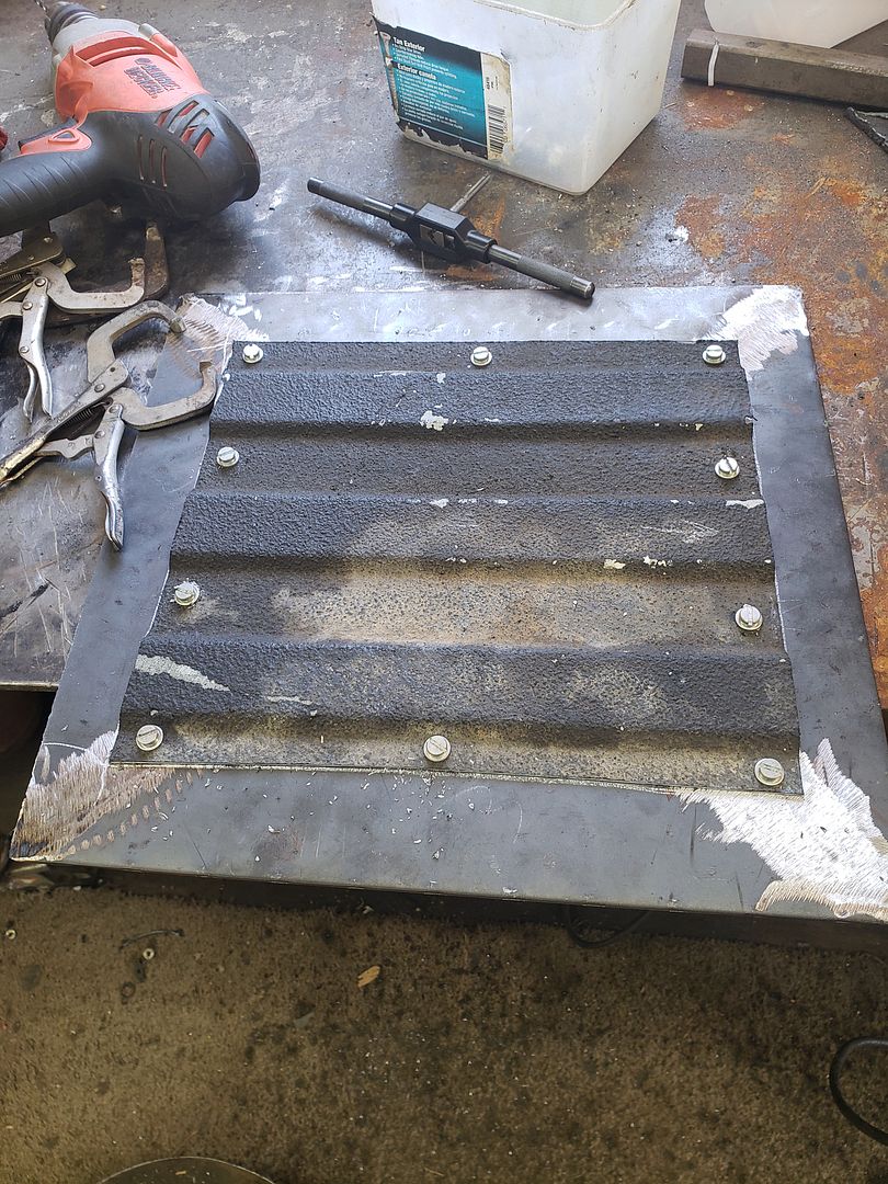

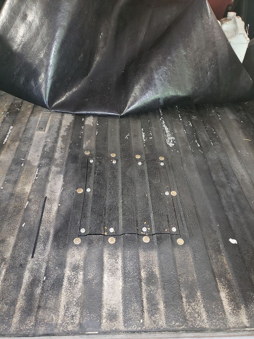

Had a fuel related issue. So I decided it was time to run a different fuel delivery setup. I want an in-tank fuel pump, so putting back a factory pump seemed like the right choose for me. With that being said I have two options drove tank (which is full) or make a access hole.

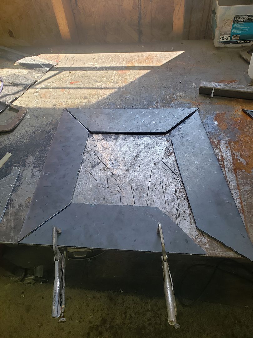

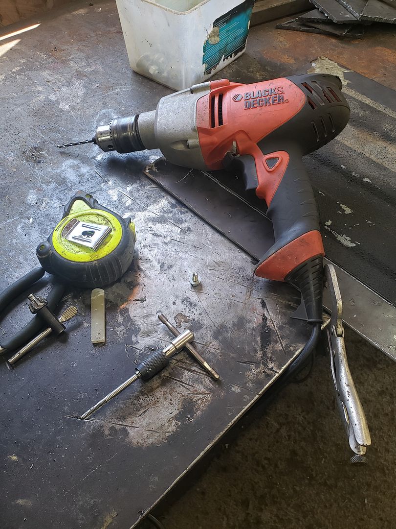

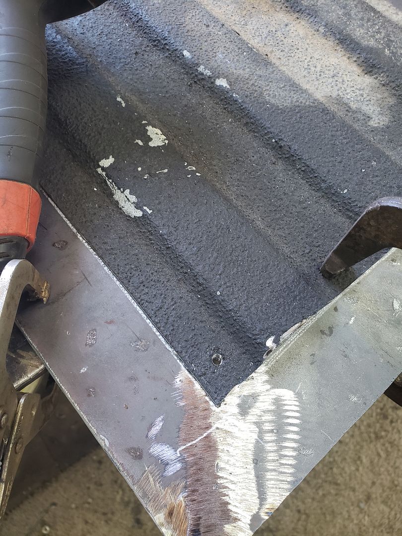

Had some scrap diamond plate laying around, so that’s what I’m gonna use to make a access hole to the gas tank.
Finally got to use my plasma cutter
