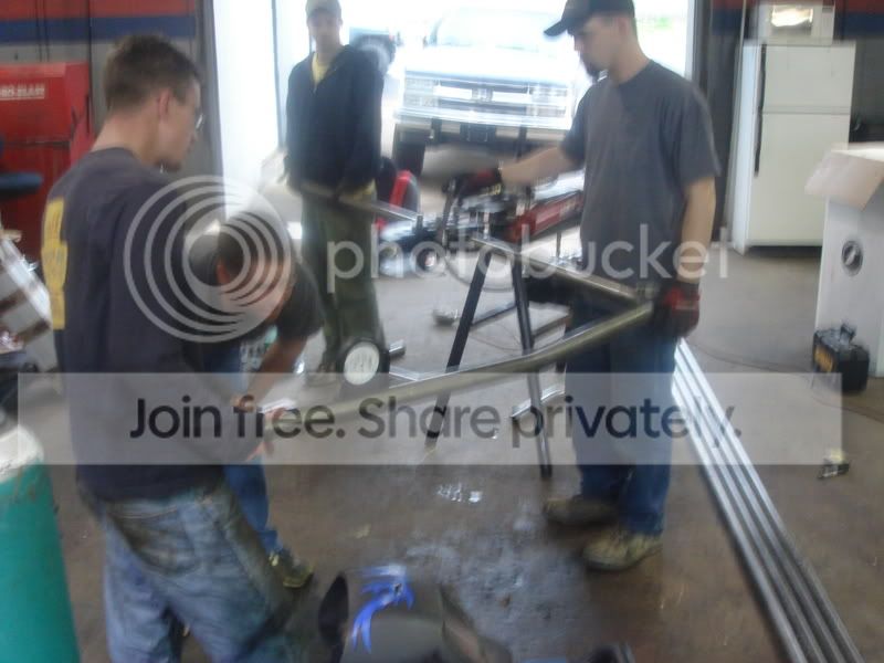

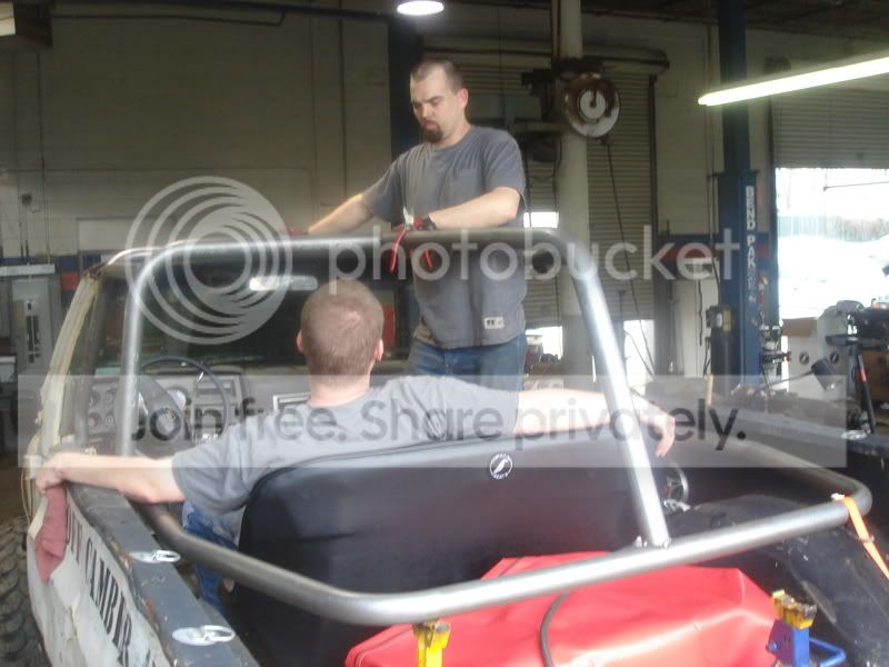

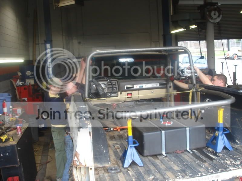

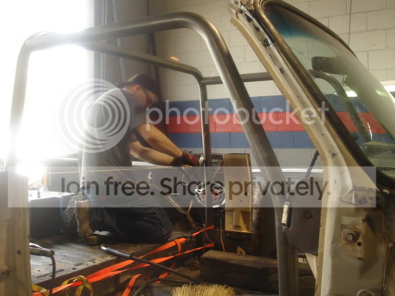

So we got alot done yesterday, Im sitting at the shop now waiting for Justin to show up. I just tried bending the seat tie ins and I fd up about $80 worth of tubing. So Im waiting on Justin ( I havent used bend tech by myself before)... here are some pics from yesterday.

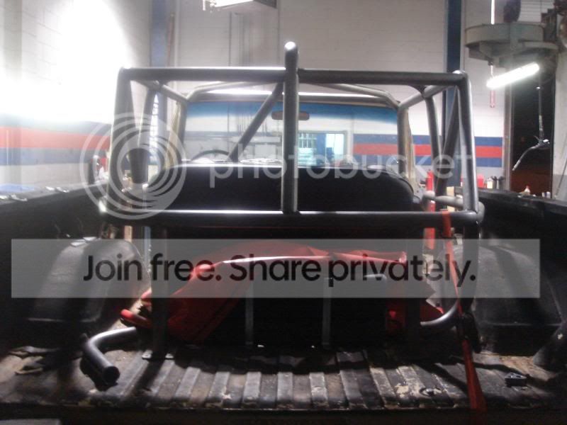

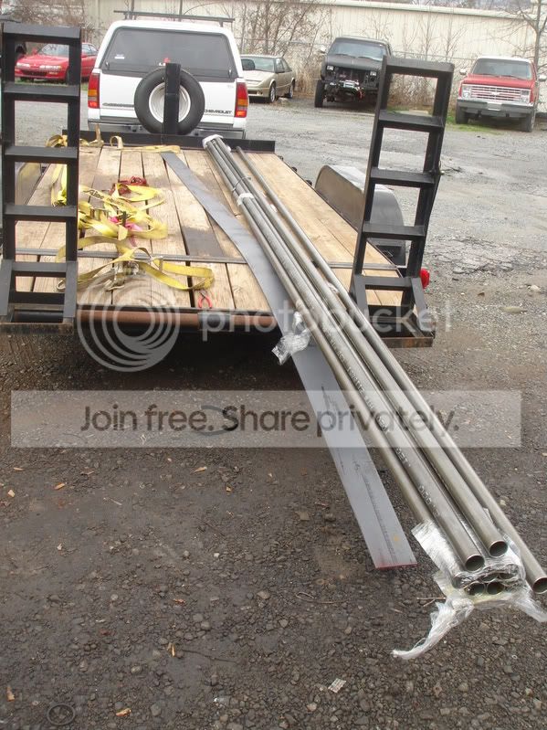

And here is what $1100 dollars worth of tubing looks like

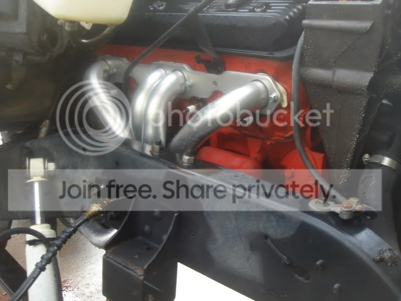

damn those header flanges are thick.
I count 8 sticks of tube. please tell me you did not pay $6 a foot.
I'm blind, I see a stick now that I did not. but thats still around $5 a foot. around here it's usually around $3 a foot for DOM.
Dont forget the taxes! Also for some reason the 2inch comes in 22 ft sticks

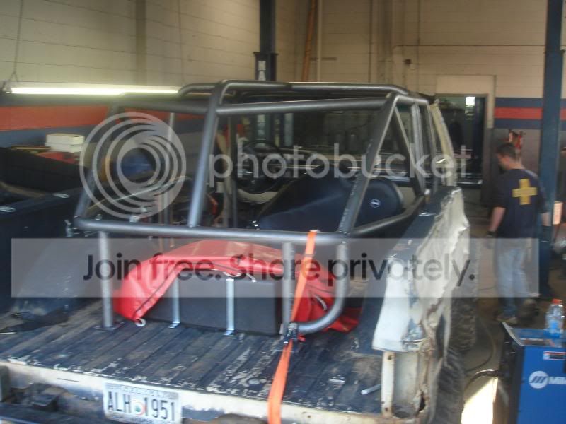

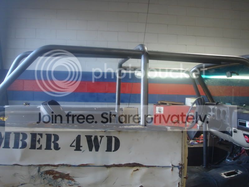

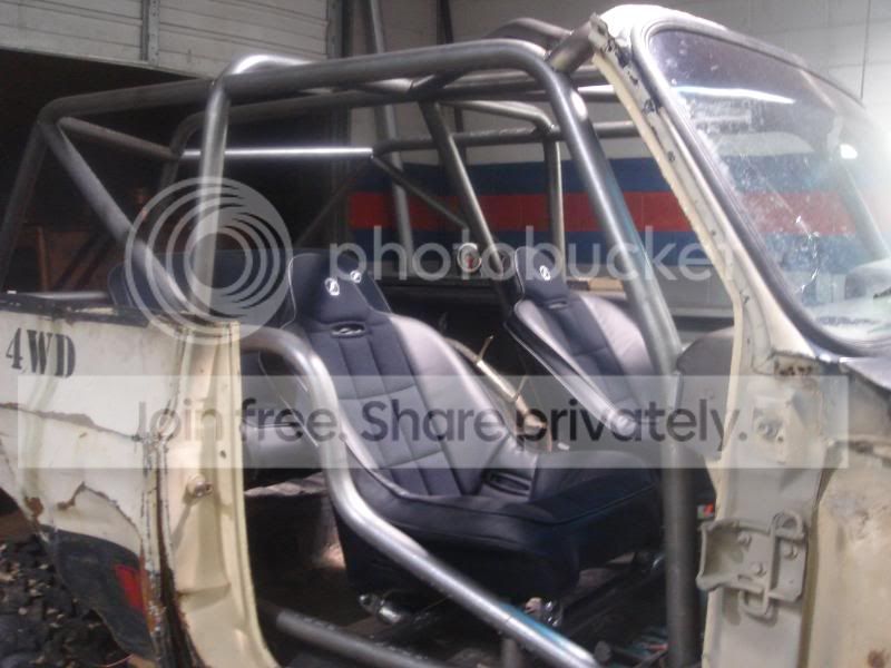

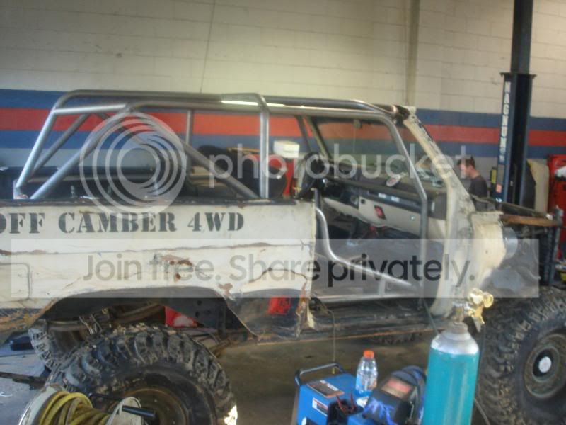

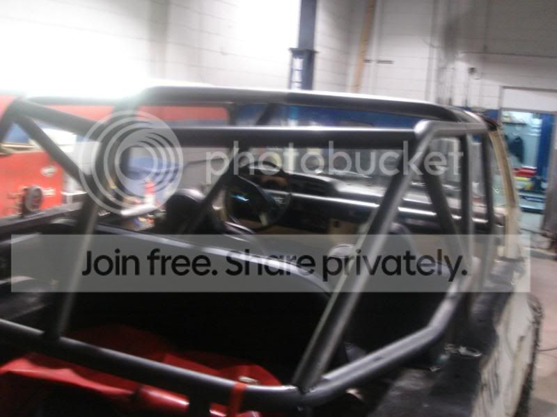

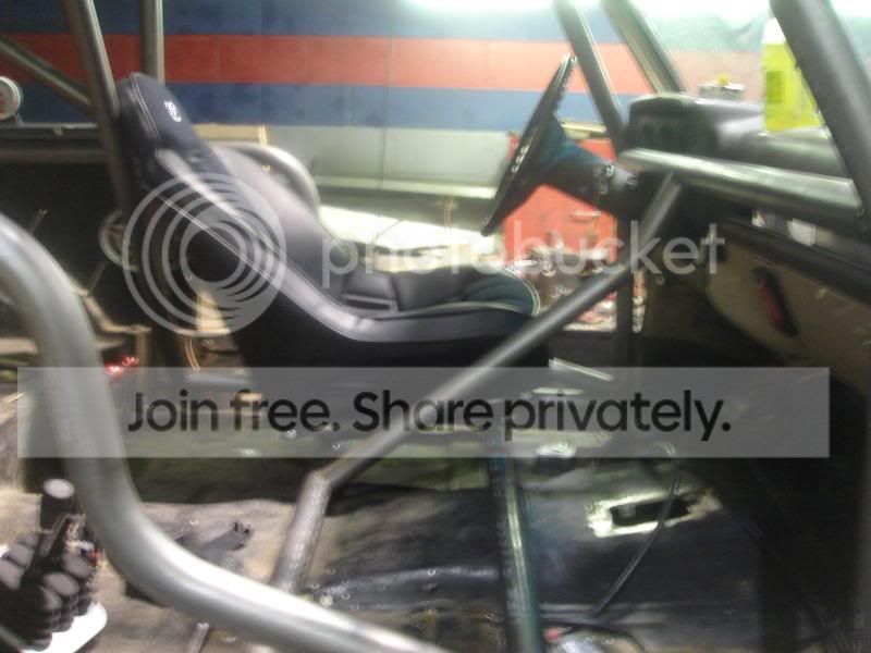

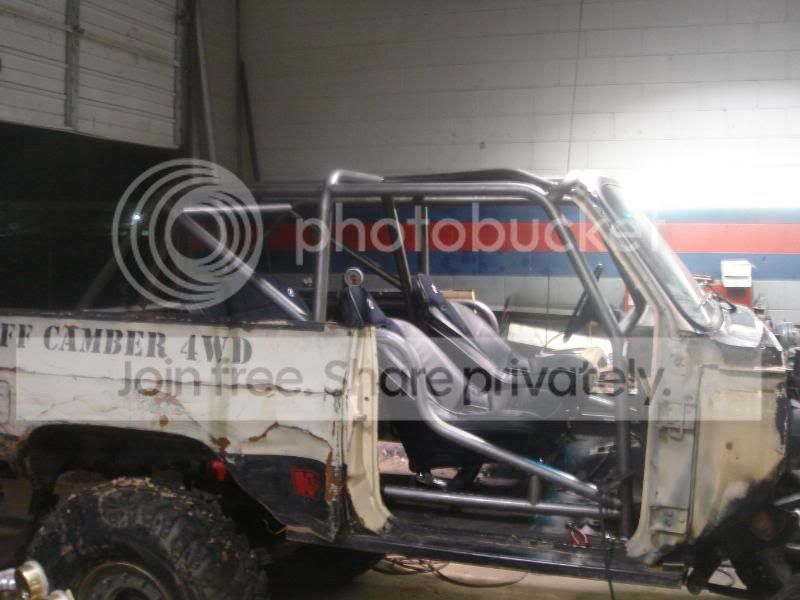

Here are some pics of the cage so far. I hope to finish it in the next few nights. Not bad for 2 days.

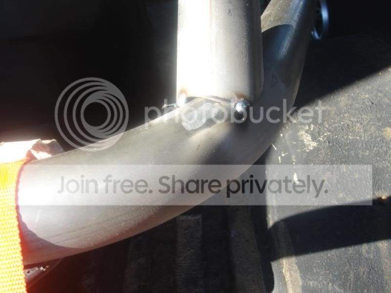

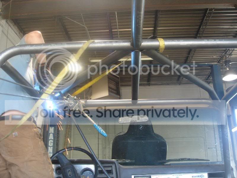

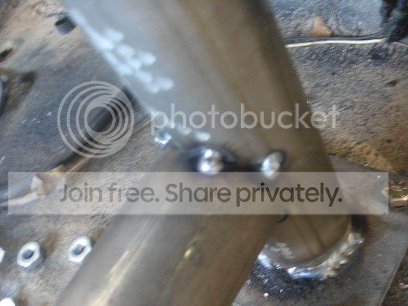

I like it so far, but I would be concerned that the door bars are gonna be shoulder busters if things get unexpectedly rough. Also, the one pic showing some welding...I really hope the rest of the welding is gonna be better than that. You spent the extra cake on DOM, at the very least it should be welded correctly.
I dont have to scroll on my comp.... Hmmm, Ill resize the future ones. As far as the welding goes, the finish welds will look much better... That was partially my fault, I had the big bay doors open while justin was welding... as some of you might have heard it was a little windy here in Atl. this past weekend. Also remember, I am still working out the design on a couple parts so there will be a couple of changes and alot of gussets...
