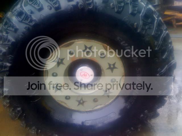

a quick pic of the wheels I took for my wedding cake (grooms cake will be a replica of this) this is with my iphone, so the pic quality is crappy. I will get some good pics as soon as I pick up another camera.

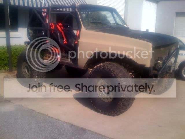

So I basically ripped off the drivers side rear quarter coming down upper two. then going back up the shelf on upper two I ripped off the passanger side front fender. It was sawzall time... so here are some recent pics. I am going to build some small fenders for the rear.

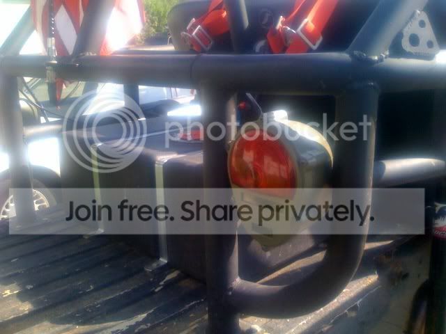

woohoo!! Looks like morgan and I will stay nice in cool in that backseat this weekend. lol. Those brake/turn lights are cool, what are they out of?
