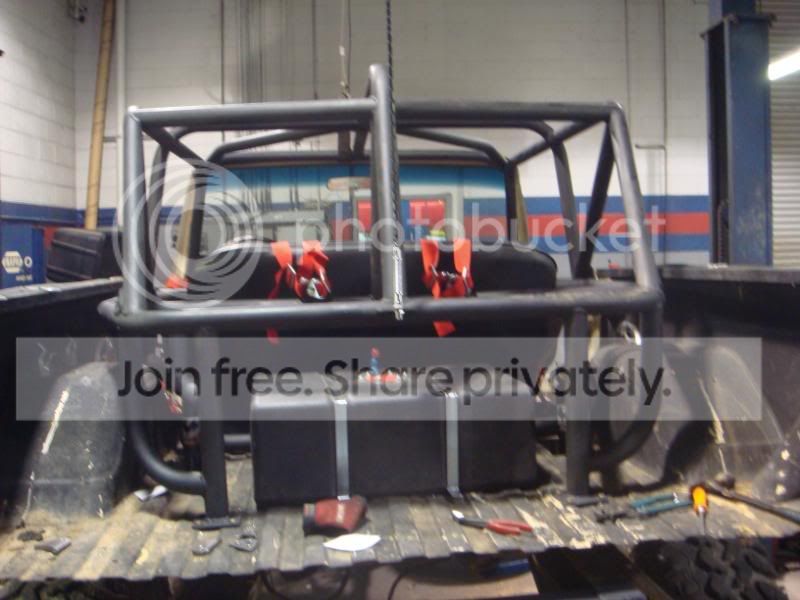

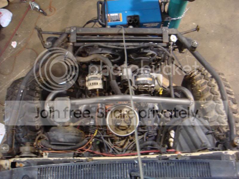

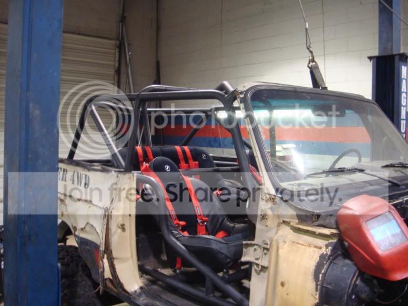

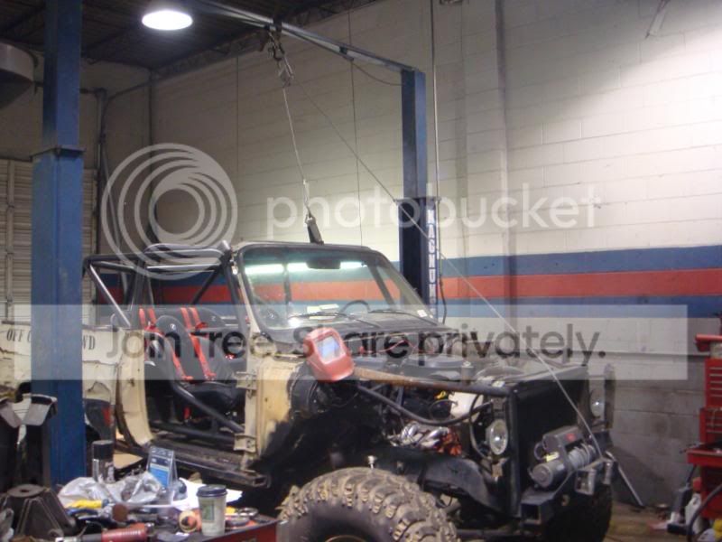

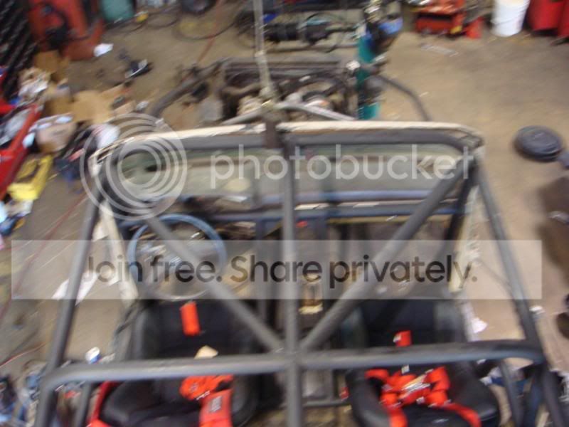

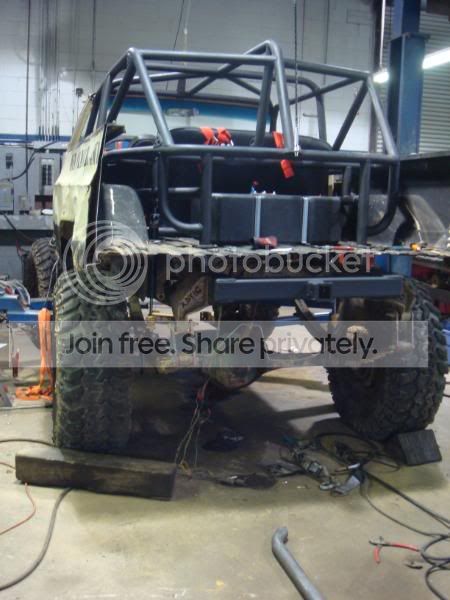

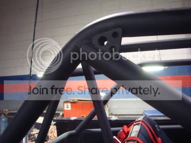

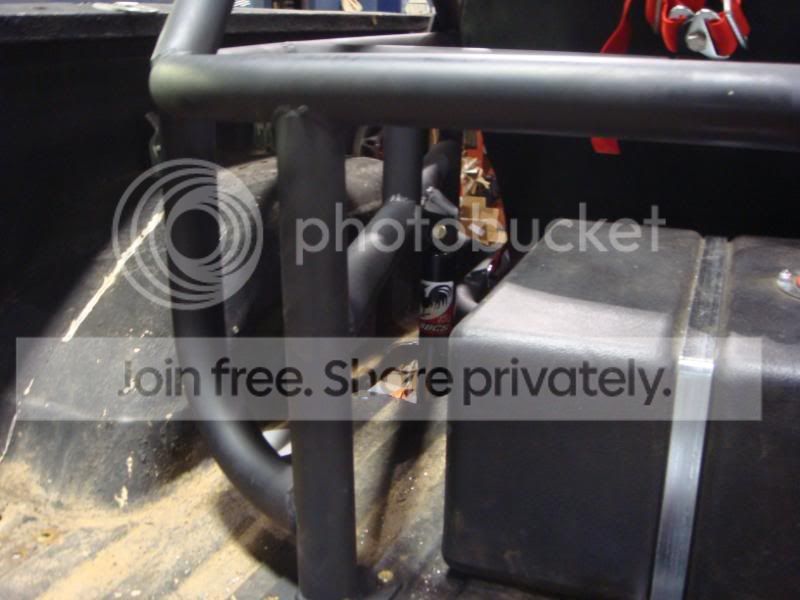

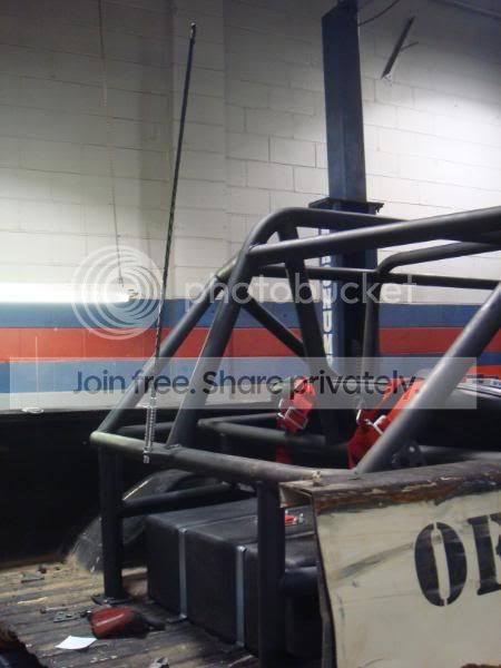

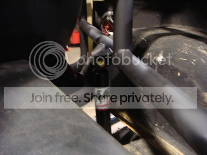

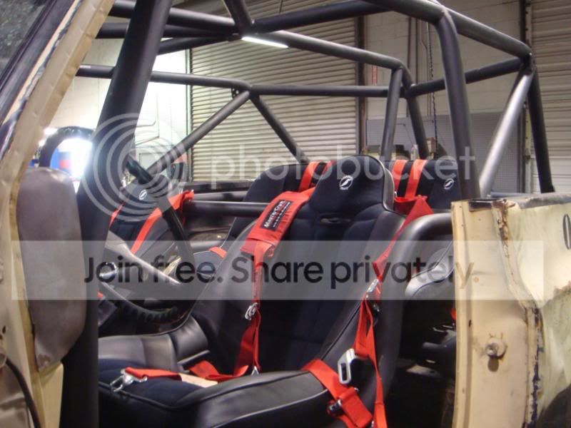

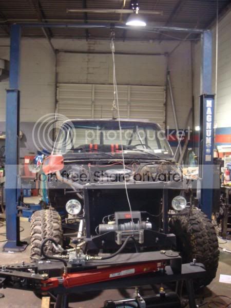

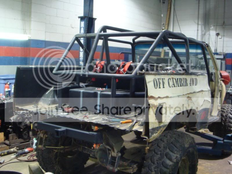

Well the cage is pretty much done. I have it in the truck and only have to tie the a and b pillars to the frame underneath. I also built some front shock hoops, I have not finished them yet but will post pics this week. here are some current shots.
wow looks really good.. and damn.. that truck went from MINT to smashed.. back to sweet... almost truggy time it seems
Thanks, Im not going to keep much more body than the skins. I have a big event to do on the 4th (Save Tellico Spring Fling) and have to get it ready by then... I still have an entire drivetrain to assemble and install, Then driveshafts and exhaust. After Tellico I am going to cut the rear fenders off and get some fresh front and rear fenders to skin and install with aircraft fasteners.

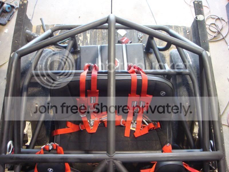

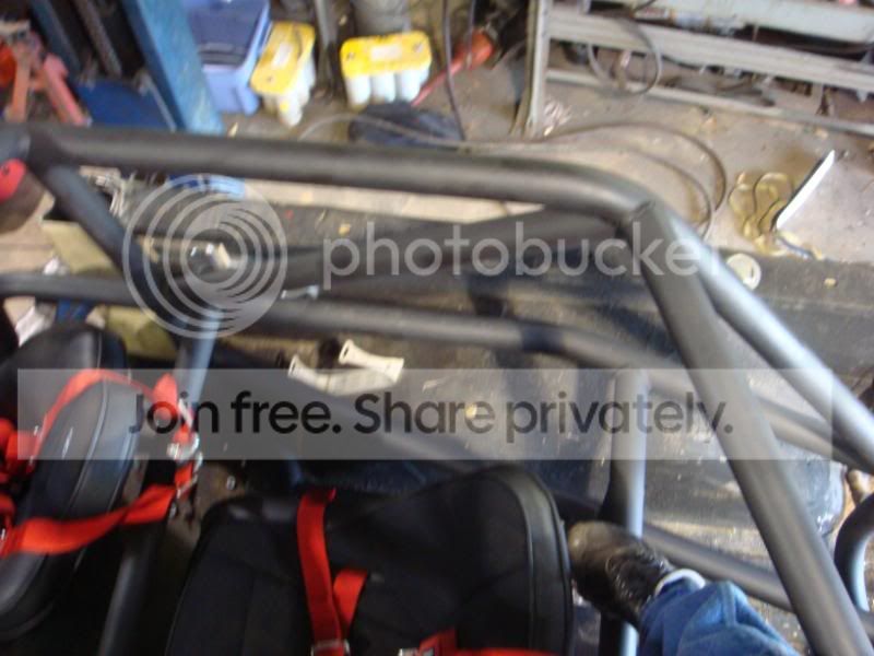

looking good tho, but i have a few questions...1st off:bow::bow:
next 4 pics, how come the center bar in the rear of the cage is so much higher than the sides?

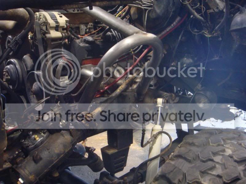

next 2 pics, the shock hoop connector is in the way if you have to pull the motor, whats your plans there, just cut the crossover out if the engine needs to be pulled?
in this next 2 pics could you have raised the bars coming from the rear corners of the cage, up on the center bar, so the middle doesn't look like it is so much higher than the sides w/o hurting the cage strength?
and i think this would make it look like they were close to the same height. i really like the cage and may copy alot of your design, but that rear middle bar looks to high from the rear to me and raising the bars from the side up to the top of the center bar would make it look more level....is there a reason the center is higher and needs to be like that?
i like how you did the diagonal door bars....

The center bar going to the back is taller to keep the rear passangers from hitting their heads. It is also level with the front section of the cage. The side bars are the level they are to match the a pillar where it comes back to meet the b pillar hoop. I wanted to keep the cage as head friendly as possible. I have hit my head on some other peoples cages. I also really like how the rear looks with the center bar raised. Too many K5 cages look like boxes. As to the engine crossmember I dont plan on pulling the engine any time soon. If I do have to pull it I will just cut the bar on either side and insert some of kerts staked flanges to put it back togeather. The Bender is a JD2, Justin (my service writer) bought the bender from them and added his own hydro unit and stand.

how did you run it through the dash? can you take some pics of your rad support. I want to lose my stock one and cage the front of my truck now that I have the cab done.
I havent gone through the dash yet. I am actually debating that right now. When i did the narrow job originally I made those two bars going back the the firewall to help support the radiator hoop. I will get some pics for you. It worked, but I might change it in the future. I have actually tied the two outer bars in the front coming off of the radiator support into the shock hoops right now. I am planning on doing some outer bars to connect the a pillar and the front like Bowties front.

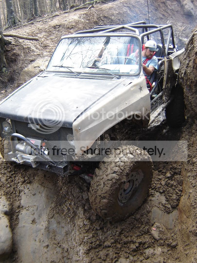

So I have been working alot of late nights to get the K5 ready for the save Tellico spring fling. I also killed my camera, so the only somewhat competed pic I currently have is this one. This was yesterday coming down the ledge on upper two. I will do some more updates later in the week when I get another camera.
gabe
