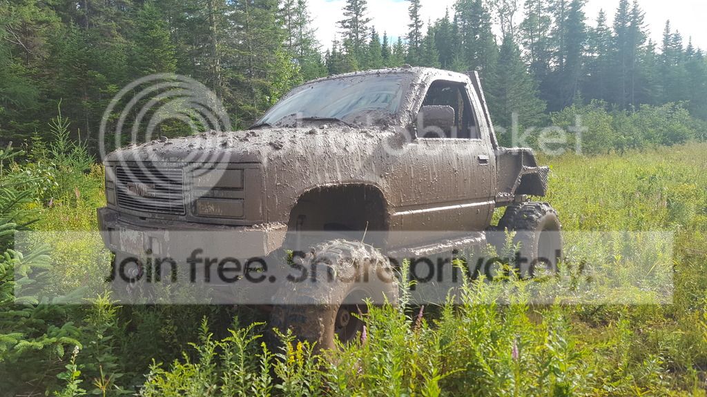

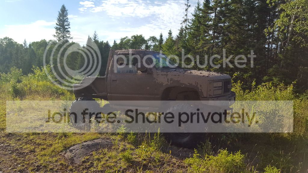

My SAS'd and hacked up 92 GMC

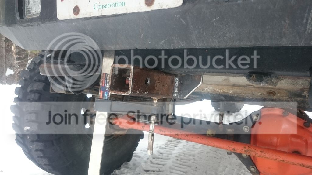

A quick front 2" receiver I made up and still need to weld onto the front SAS x-member

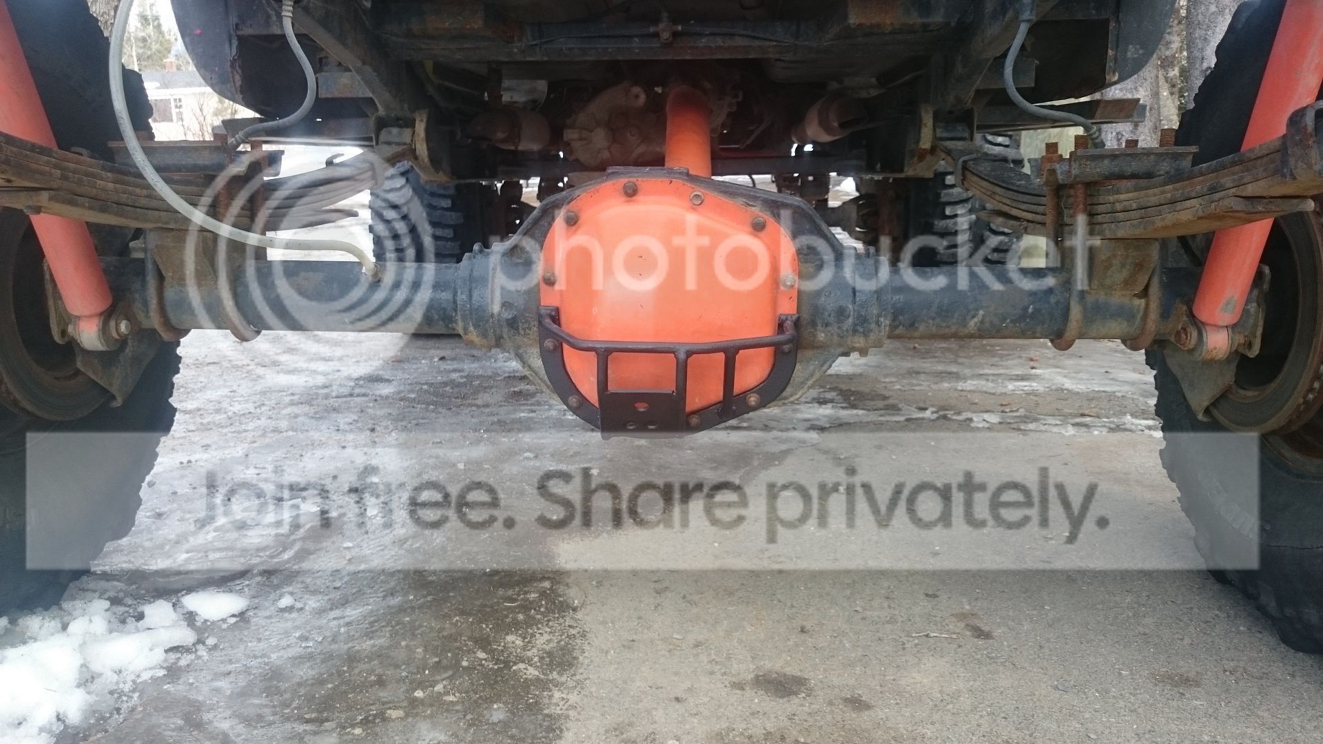

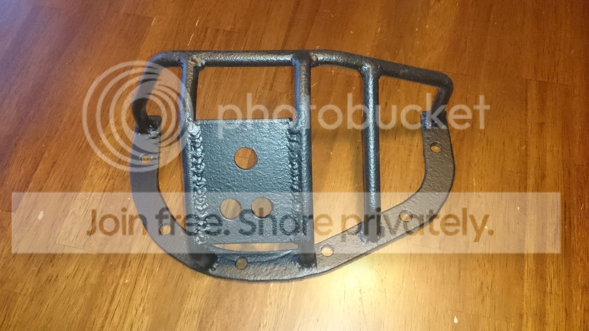

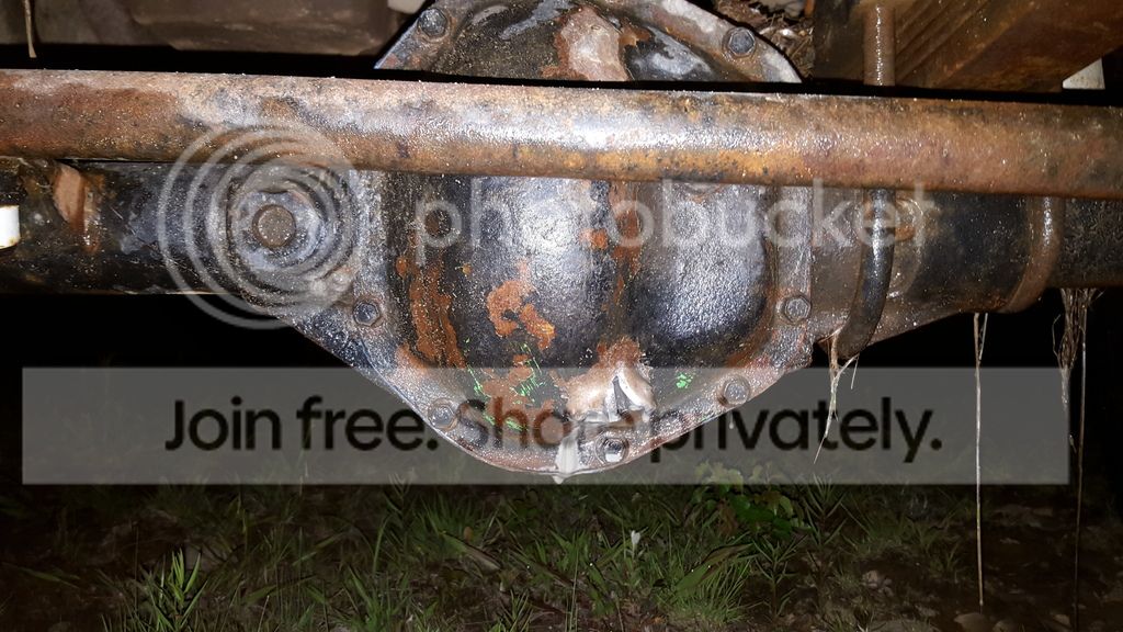

Rear diff guard

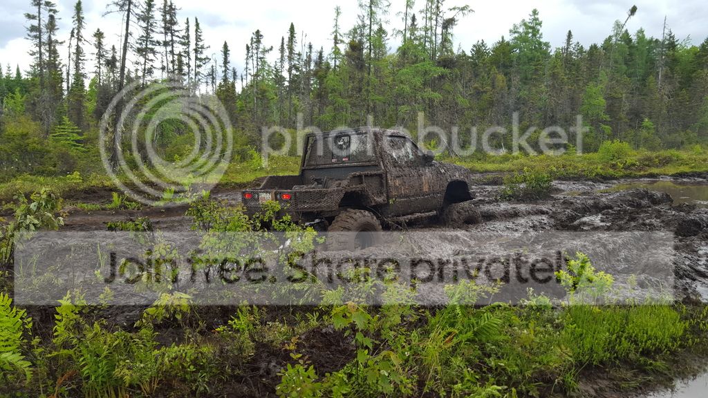

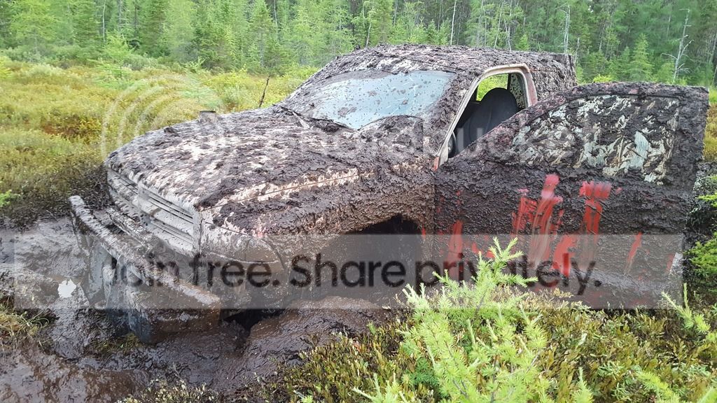

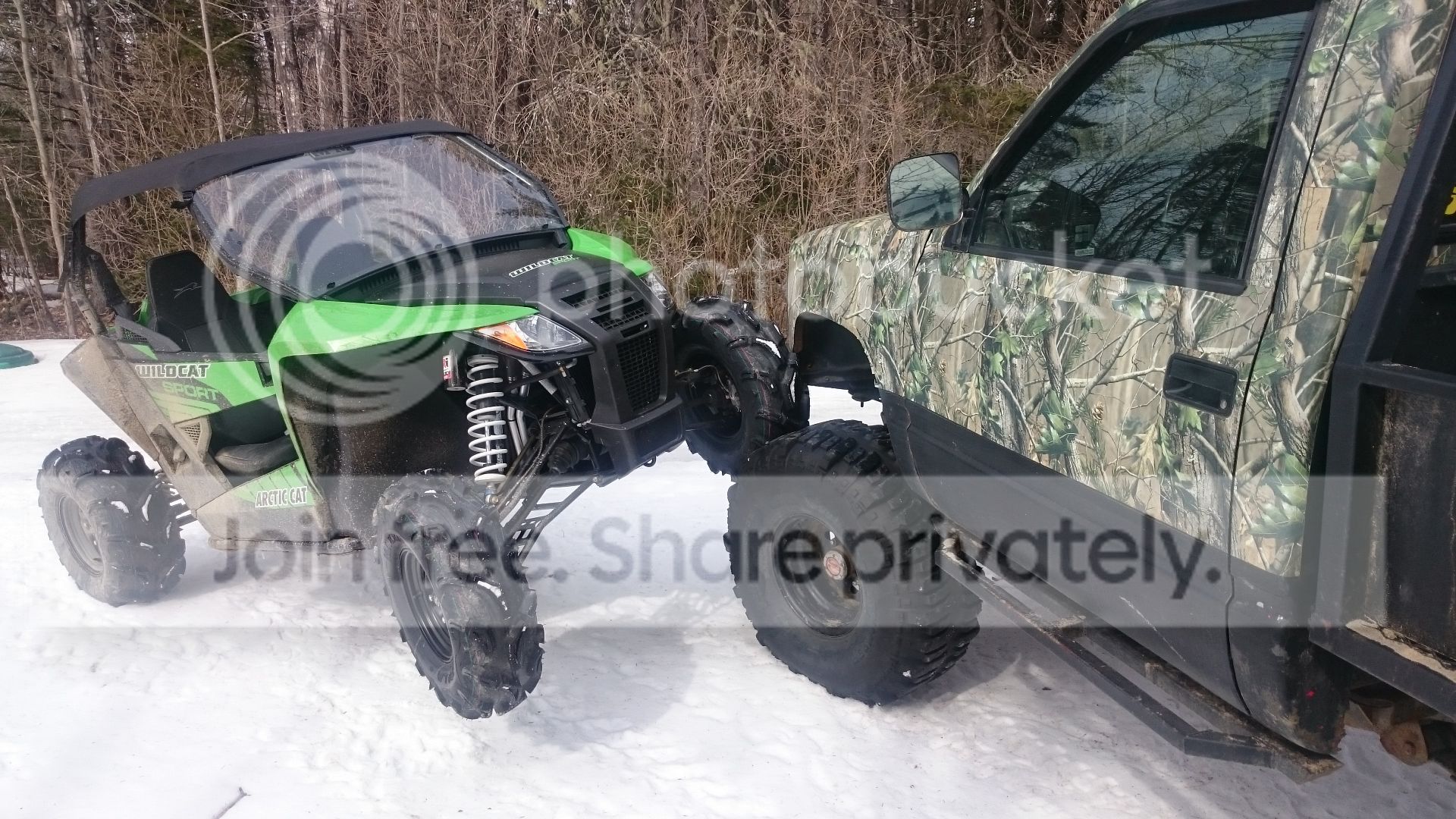

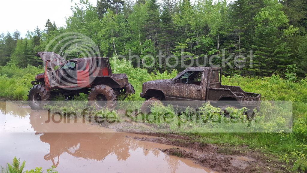

Everybody loves some carnage!!

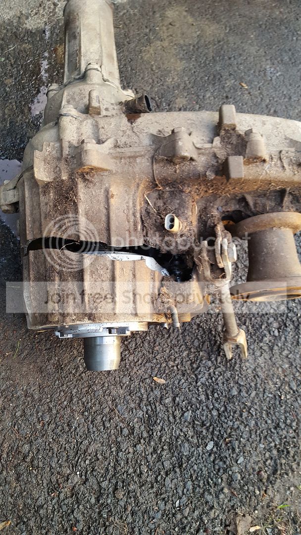

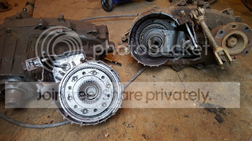

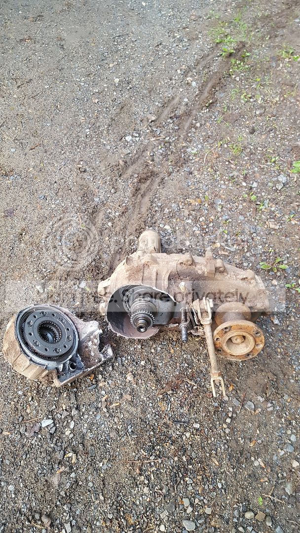

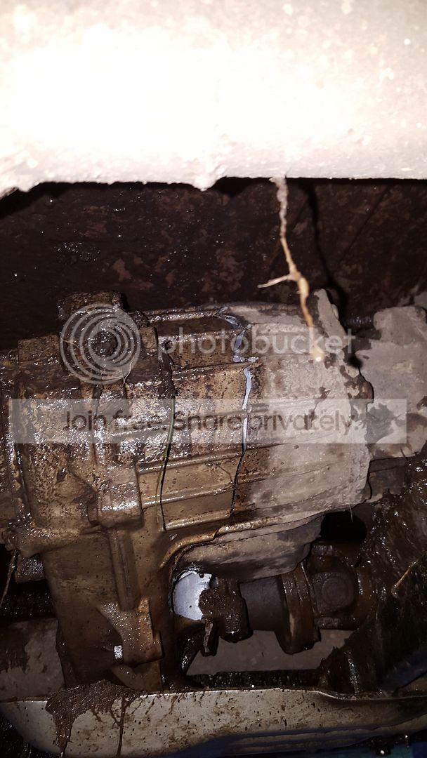

I haven't touched the truck or drove it since late winter besides welding the front receiver on. Ive been enjoying the side by side to much to bother with it but finally went on the first mud run yesterday and the truck was doing great for all the little issues with it until the last hole when the tcase blew apart. I really thought the front shaft would have failed first LOL

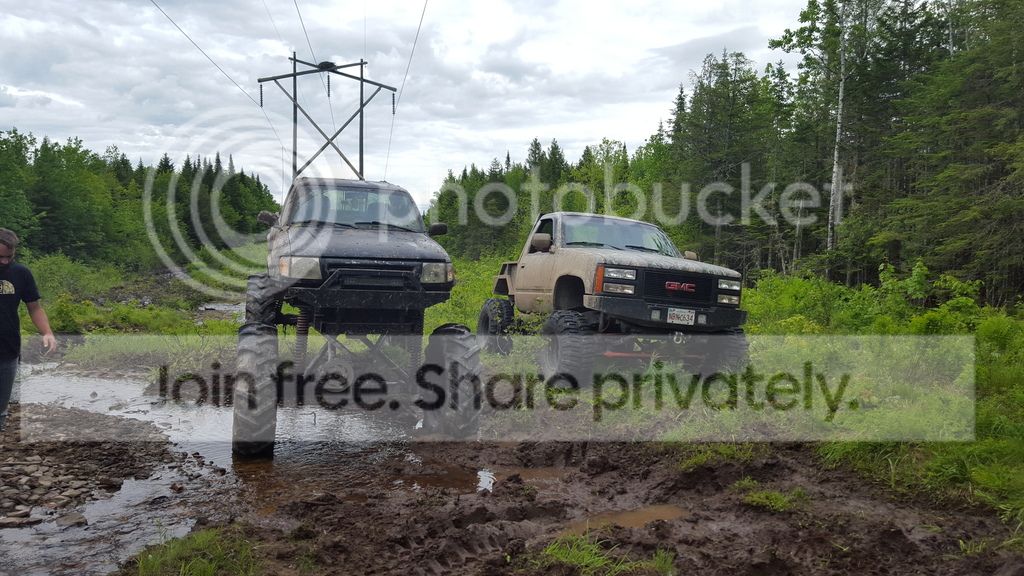

My old axles are still haunting me too. When my buddy was towing me out of the woods the old d44 decided to spit the spider gears out through the cover

Lol! play hard much!!
When your on "tiny" 38's and others are on 50" tractor tires going hard is the only option LOL

Thanks. I lucked out and my buddy had another np241 but it has a bent tailshaft. So its a free fix just some time in swapping parts
Im thinking I must have bottomed out the front shaft and busted the case as there didn't seem to be any amount of damage inside.

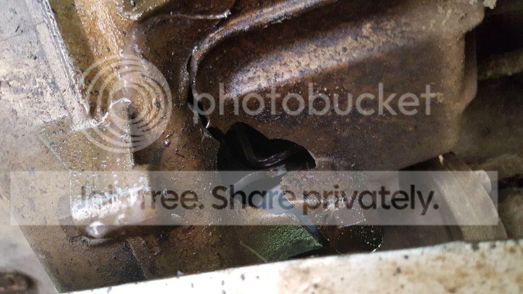

The tcase got reassembled and put in easy enough and then the truck sat as I slowly worked away fixing the rear brakes, plating the rusted out frame, changed the power steering pump AGAIN and pulled the hydro assist AGAIN. I took it for a test drive to find that the trans was slipping badly. When I busted the Tcase I also smashed the transmission pan in which must of blocked of some flow to the filter, once the pan was straightened and some fresh fluid it seemed fine and tested it over last weekend.

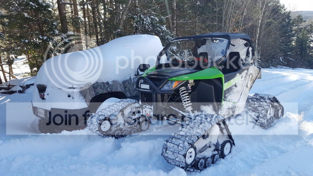

The truck sat all winter, tracks on the SxS rock!

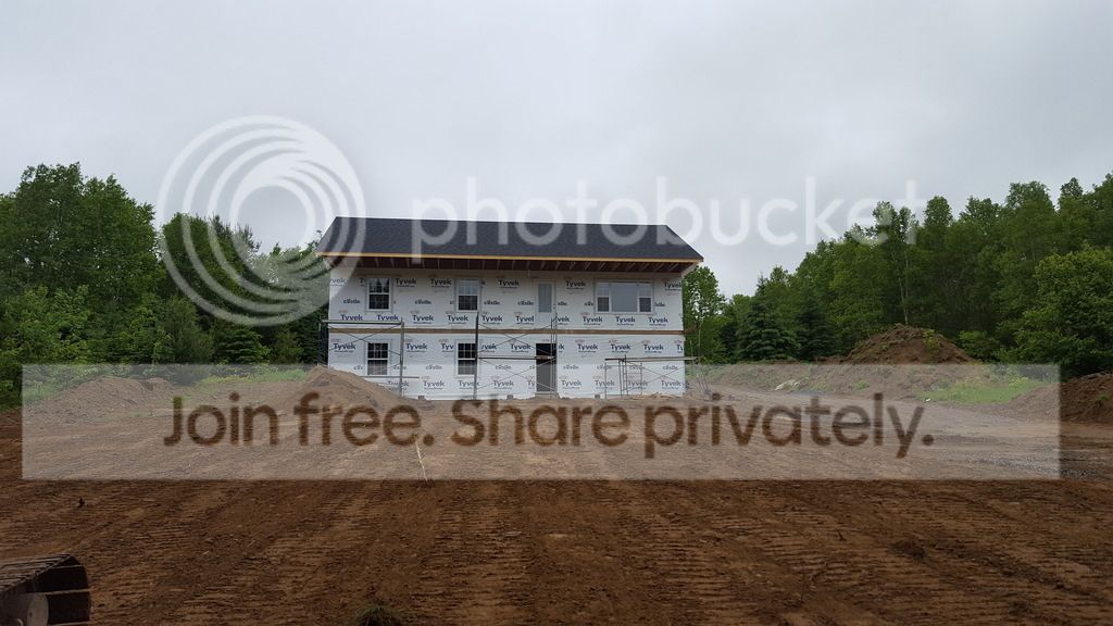

We are building a new house this summer so the extra money sure helps.
