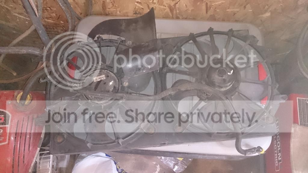

I did pull the electric fan setup from a 2000ish chevy Malibu that a buddy was junking a while back thinking I may have some use of them. Any chances on making one of the fans work for the trans cooler? Mounted on the front side to push the air through it better, as there is no room behind it.
Grabbed the electric fans today, I think I will only try to work with the low speed one. A quick test tonight showed that when wires switched around so that they push air vs pull, the output is not great, with most air flow going out sideways due to the shape of the blades. I'm not sure if a tight shroud would help or if they are a loss cause.

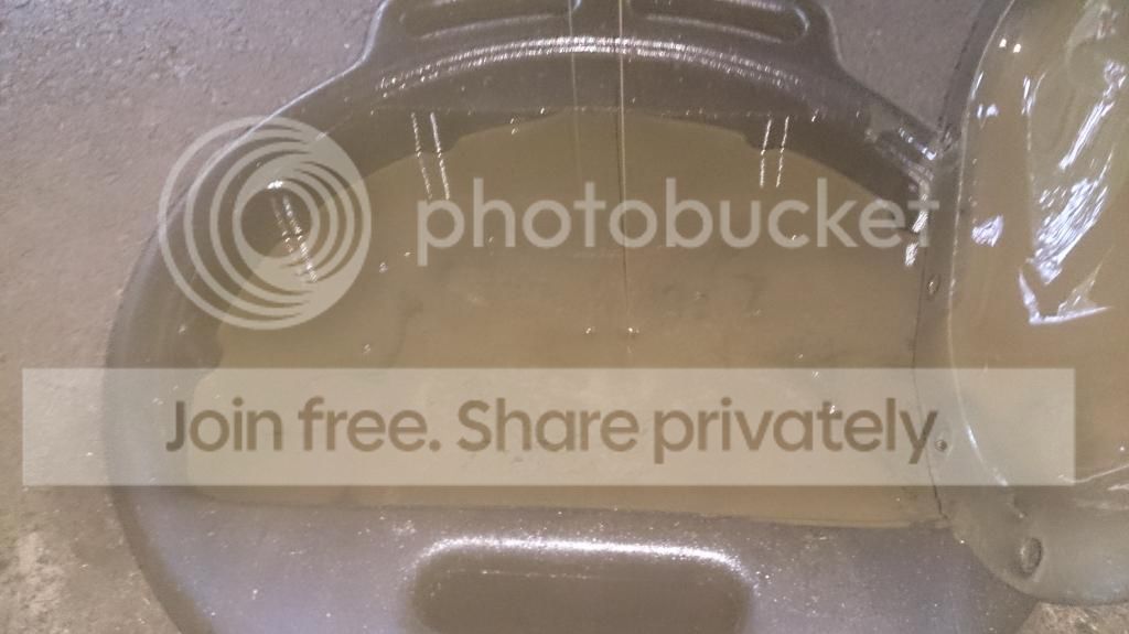

Last week I swapped out the milky diff fluid for some fresh stuff and painted the covers while they were off.

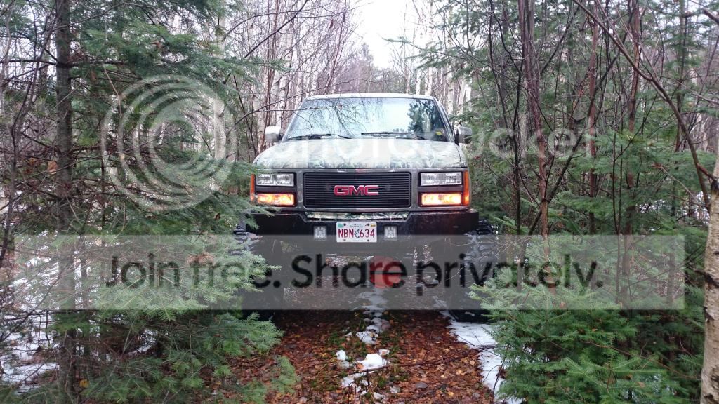

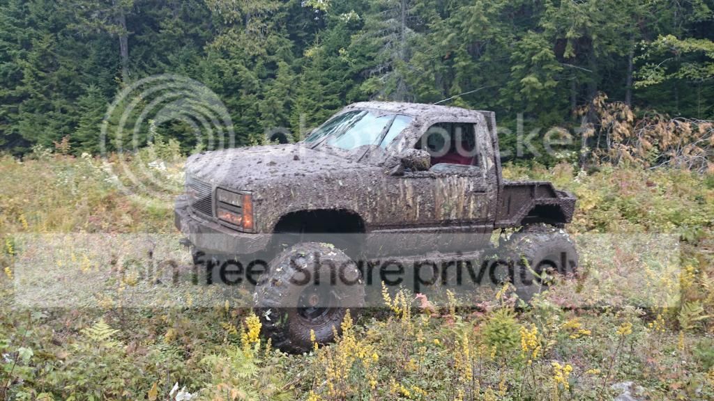

No big updates on the truck, got out one more time in the mud with it in late September
Then it was time to clean it up and get it ready for hunting season

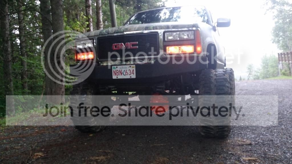

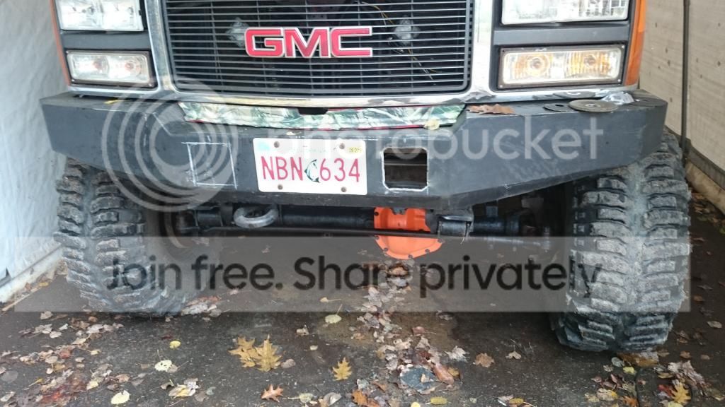

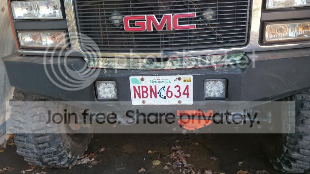

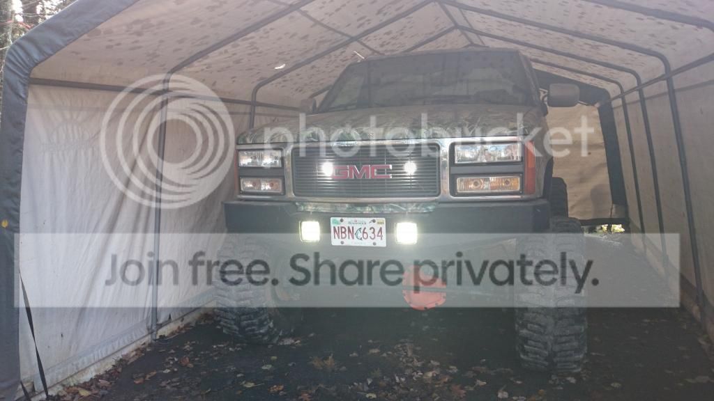

Added a couple of 4" LED lights in the front bumper

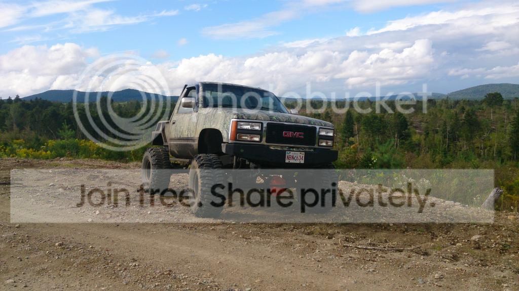

Some random pics
Awesome pictures! Looks like a fun rig! :waytogo:
I really like the one with your little girl hunting! :thumb:

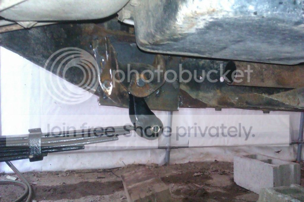

Hey if you get a chance can you snap some pics of your front shackle hanger setup for the SAS? Trying to get some ideas.
Here is one I had on my photobucket from when I first did the SAS. Hangers are just the front hangers off the rear suspension from a K5. They are not quite the right width and it causes some stress on the shackles bushings. The truck hangers are a better fit.
Hmmm that looks like a simple way to do it. I was thinking about running shackles up front to keep it lower. I want like 2" of lift.
My personal preference: but I woun't run a shackle in the front. Here is an article that goes over the pros and cons of the forward and rear shackles. It's jeep based, but relevant http://www.jeeptech.com/susp/elkcahs/

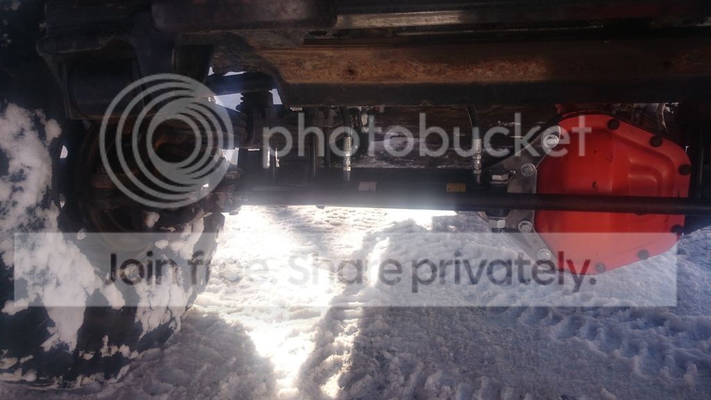

Before welding on any tabs for the ram I have been thinking I would like to drill out the knuckles and run 5/8" (or go 3/4"?) heim joints and DOM tubing for the tie rod. I then could mount it on top of the knuckles and gain a little bit of clearance under the tie rod.
Anyone have experience with using heims in the mud and a little bit of road driving, do they last? how about having the hydro assist ram pushing them, would a 5/8" heim joint be strong enough?
Last question is I have seen some people mount the ram to the diff cover. Would a stock cover hold up or tear apart? What about plating it in the mounting area to spread out the stress?

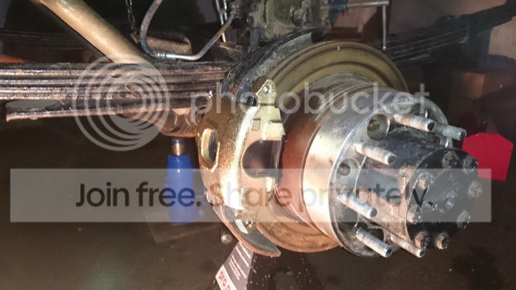

We've had some decent weather lately and I was able to get a little work done on the truck. Hydro Assist and all new wheel & spindle bearings are now done.

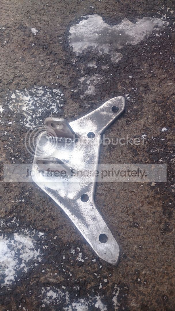

New ram mount.

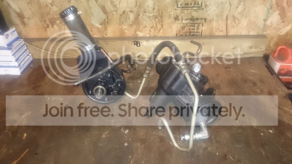

New pump and steering box with the top cap and end capped drilled and tapped
All done. Feels great going down the road, nice and light steering. There is still to much snow to get out on the trails.

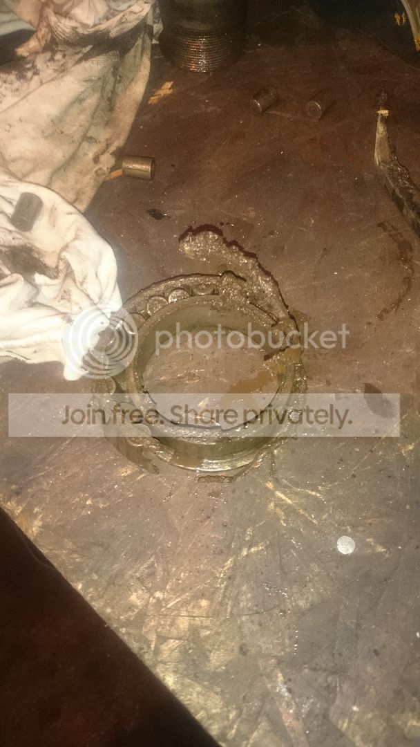

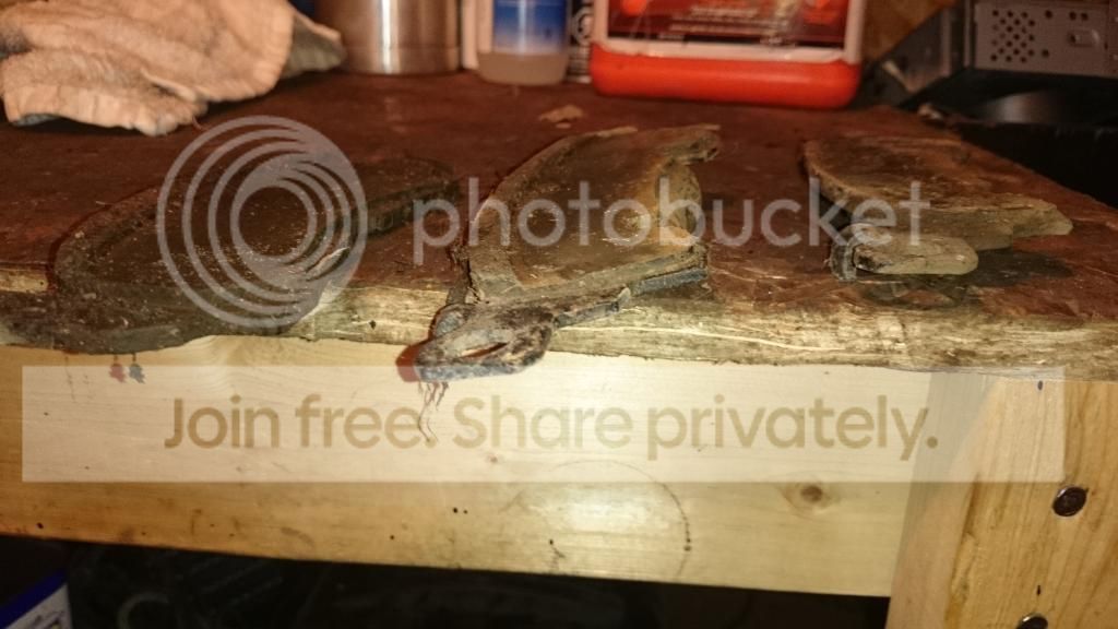

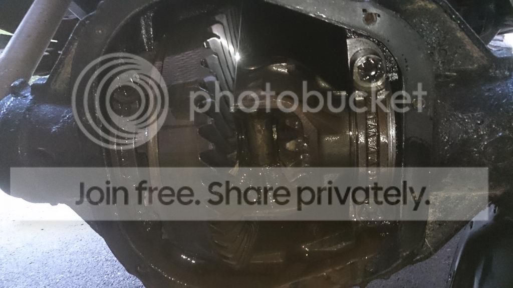

This is how the inner bearing on the drivers side looked when I tore it apart.

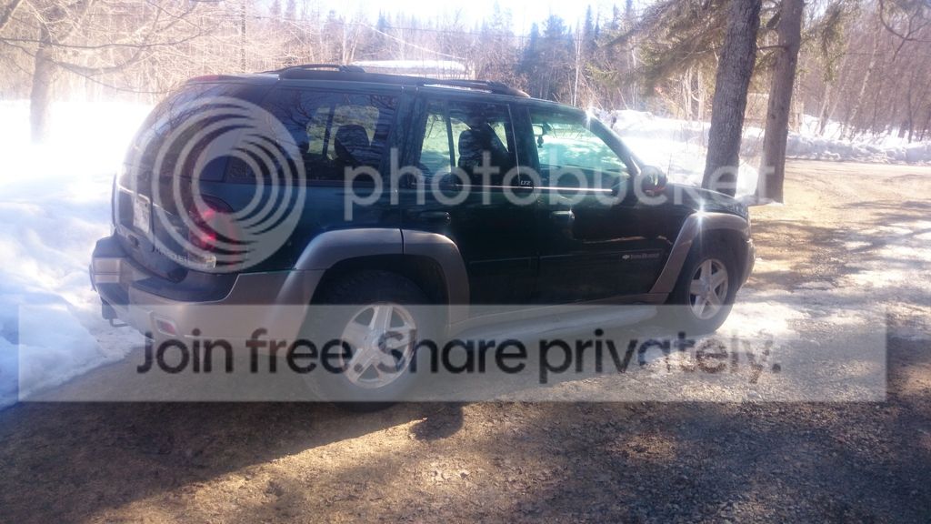

Last week I bought a 03 TrailBlazer LTZ (4.2L, loaded, heated leather seats) for $1000 and the plan is to swap the axles, springs, tires and tcase from the 92 into it next winter if I can get it running up to par.
