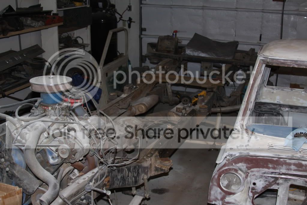

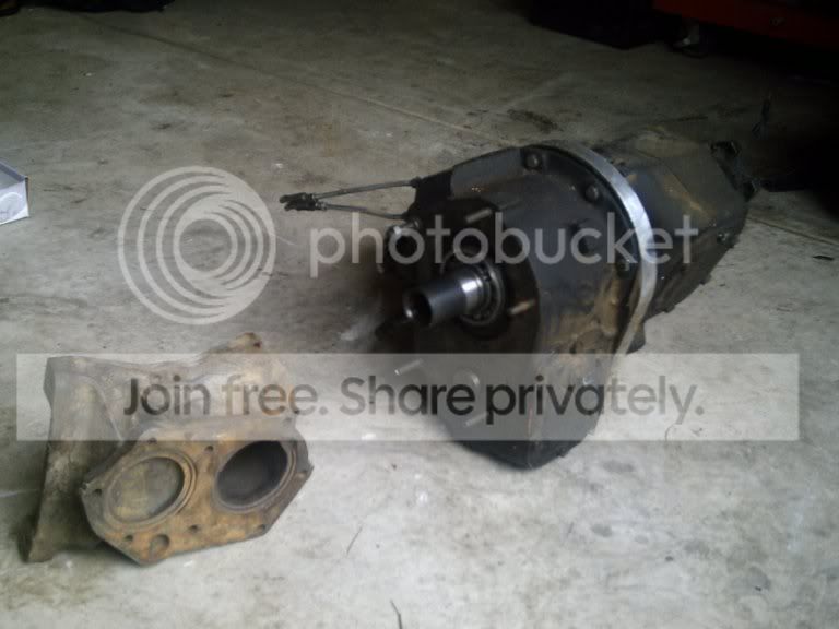

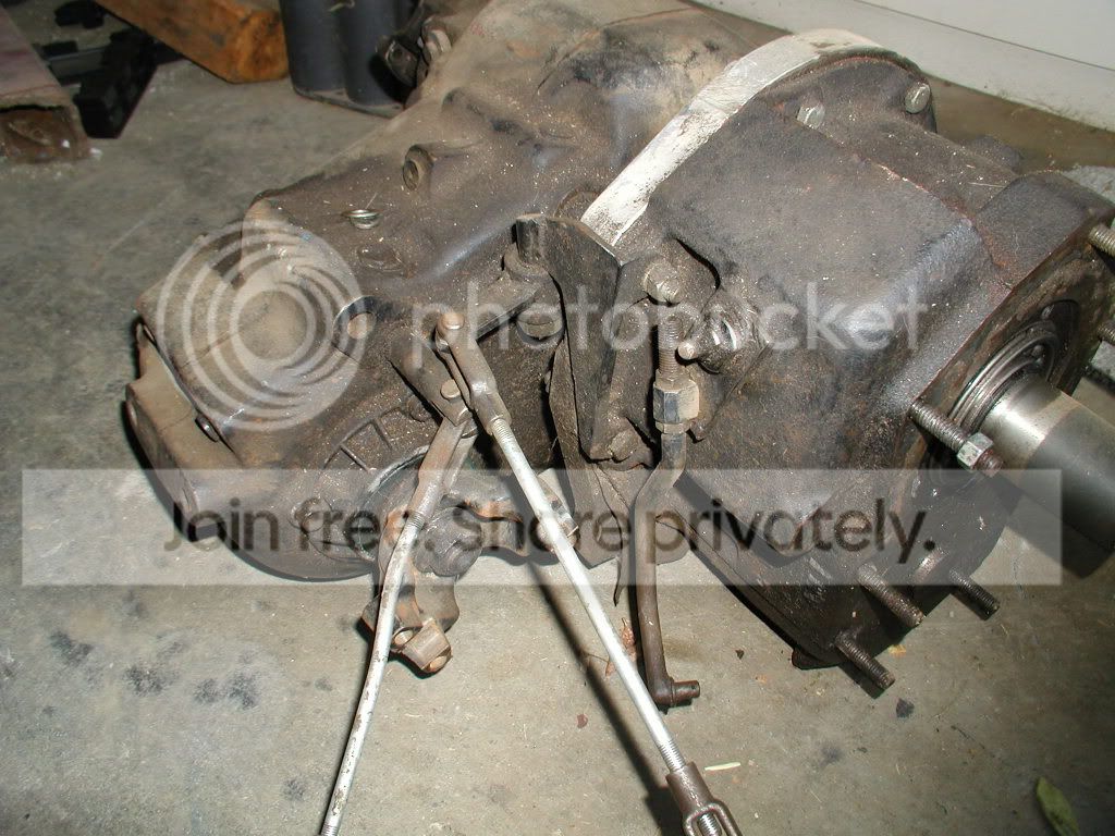

Here are some old photos I found. I bought this doubler from Pirate a few years back. Any guesses as to what type of doubler it is? Maybe ORD Gen I?

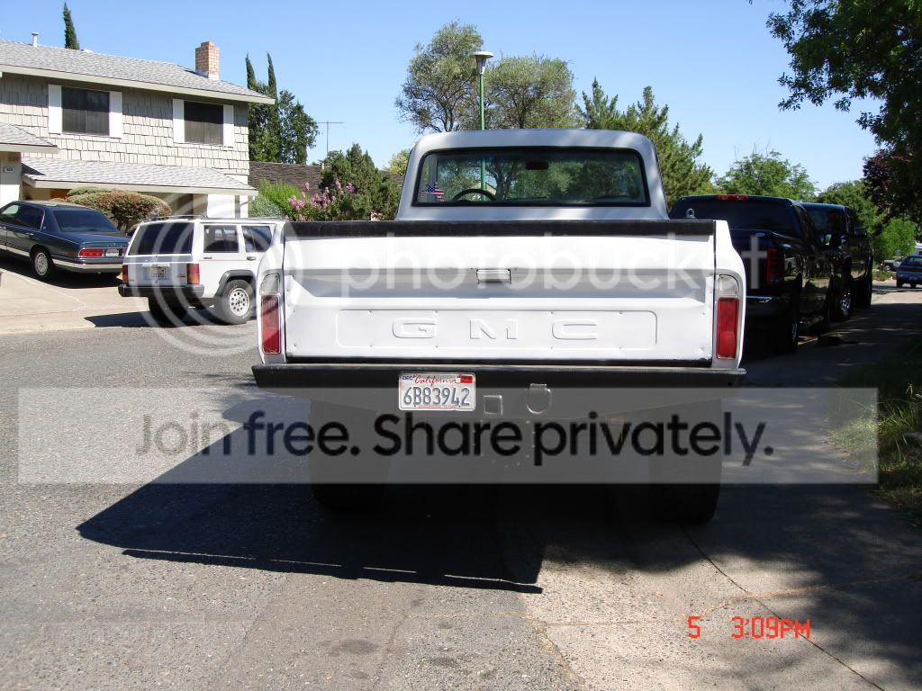

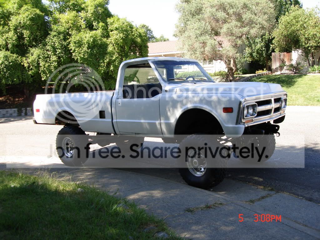

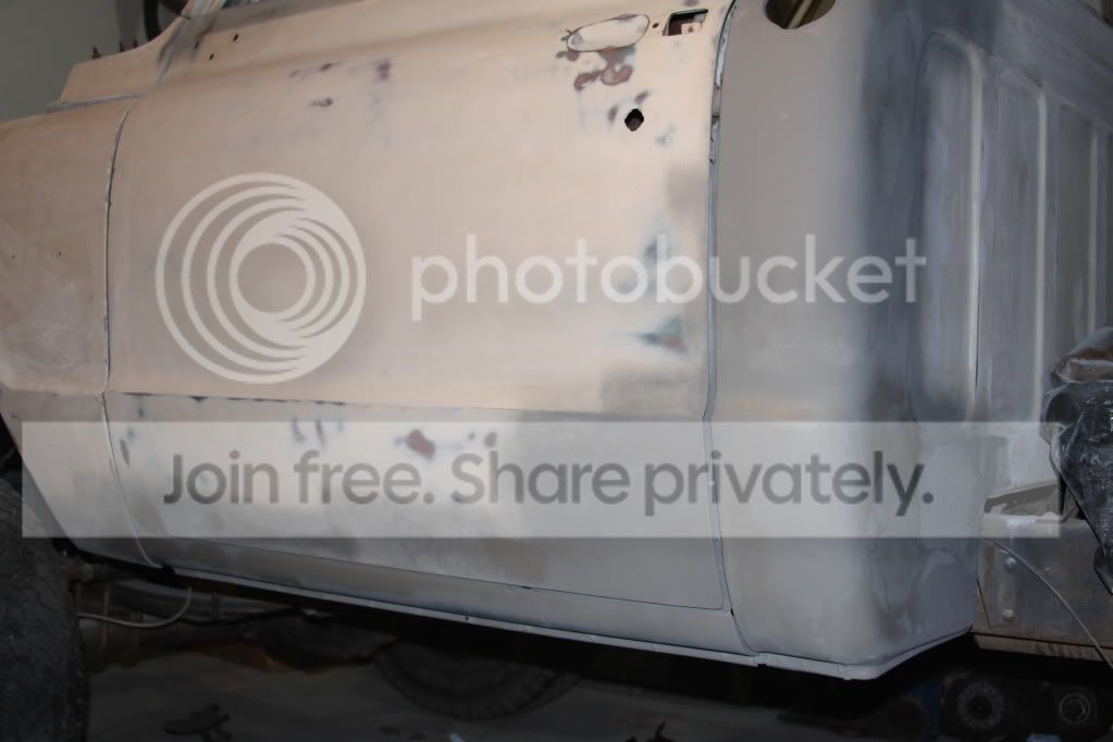

Another. This was the day that I spray painted it white. I looks way better in this picture than it did in person, trust me! The white hid dents, scraps, rust, etc. Notice the overspray on the top of the window.

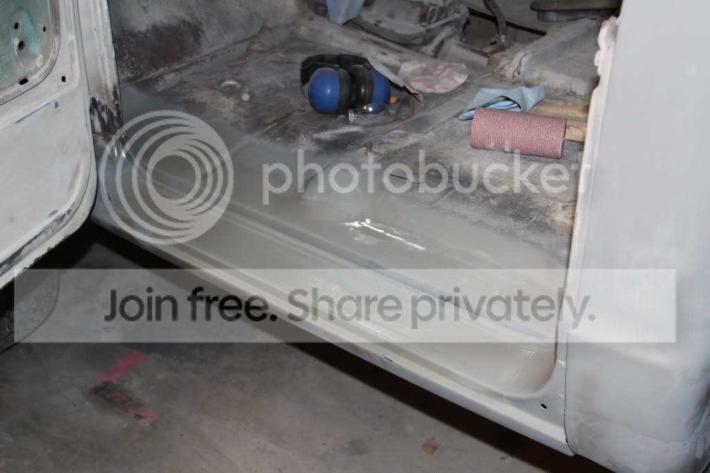

I did finish the sheet metal repair. I used Zink Chormate to cover the bare metal. I will confess that I used a glazing putty to finish off the exterior. My welding/grinding is not that good. I think the floor came out good enough. I've covering it with a Rhino type liner.

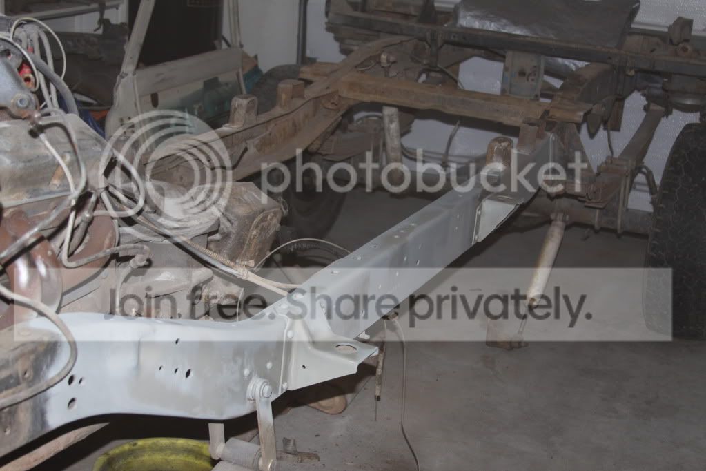

I started cleaning the frame and removing the rivets and bracket that I no longer need. If anyone needs front/rear shock brackets, e-brake brackets, bump stops...maybe more; you pay shipping and they are yours.
I am still waiting on brackets from Ballistic before I start linking the rear. I did get an e-mail that they are shipped. Once that is done, I'll finish removing the rest of the brackets. I will sell my ORD shackle flips. I'll be sure to post pics when I get there.
Its -5 F outside here, so this all is getting done in the garage. The sandblaster is WAY TOO messy to use inside. For now I am using a wire wheel on the frame. It is a long process doing it this way. Its gong to be a PITA to get inside the frame rails and under brackets. The primer is blotchy because its not dry yet.

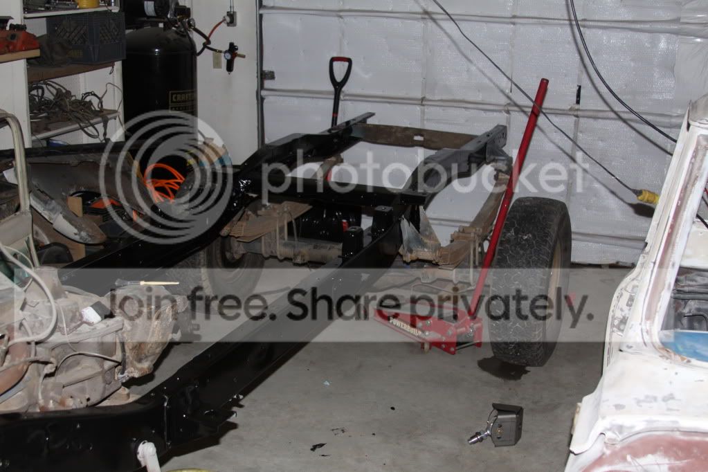

I got the back half of the frame coated. POR 15 baby!!! That stuff is awesome. Less than one half of one quart did all that. I purposely didn't coat several parts, as they'll be removed. I need to do some touch-up. Now I am ready to start welding brackets on.
I'm going to pull the motor this weekend and finish the front. First person to show up with $500 takes it, turn key. I'll change my price in the for sale section.

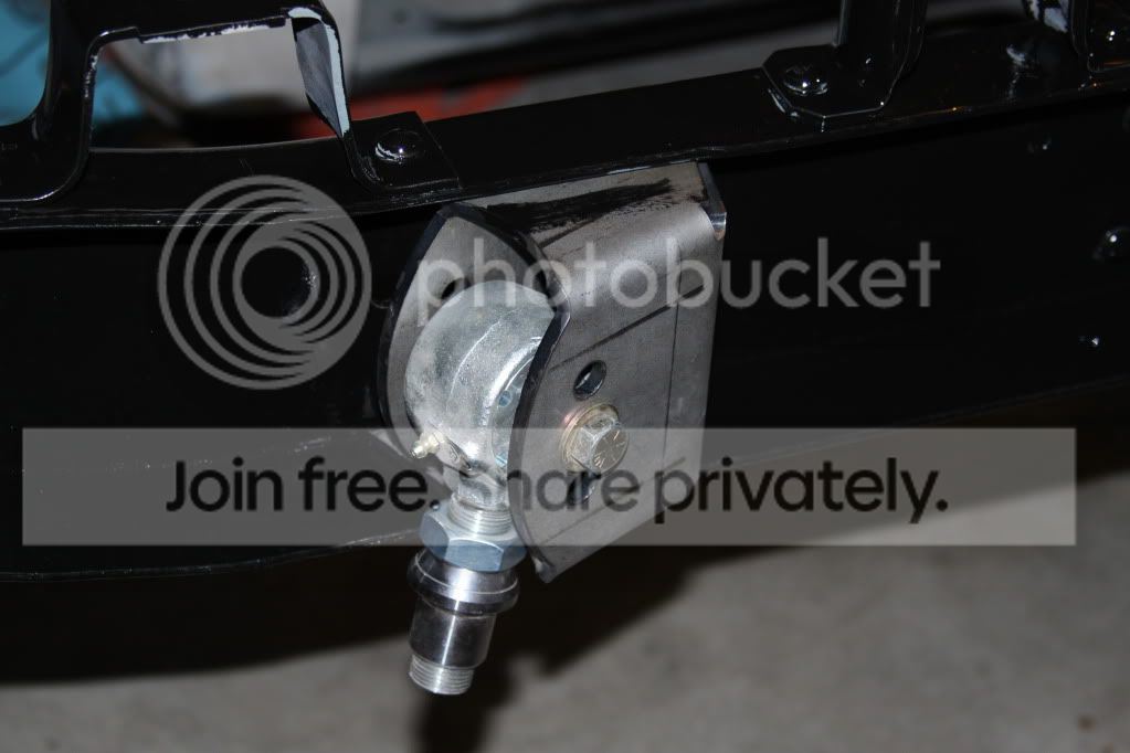

The second picture is a Ballistic Fab 22.5 degree bracket. It fits perfectly between the frame rails exactly where I need to mount my upper links. I don't think that I'll get that lucky again. I am going to plate the frame from that bracket forward.
