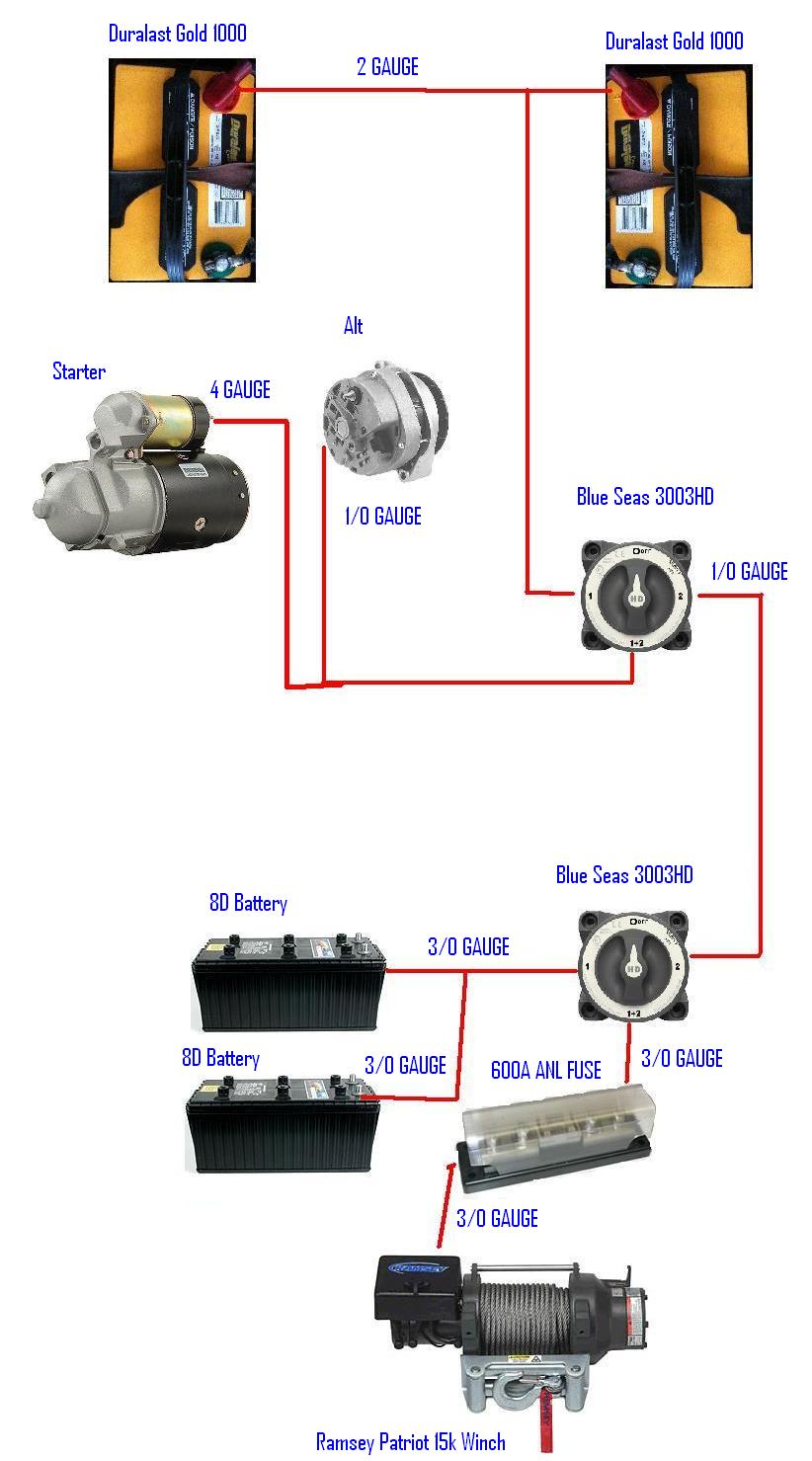

ordered my eyelets for my wires... i will have everything but the wire to relocate the relay packs.. going to pick that up soon.. trying to find cable locally first....
so since i was bored.. thought id draw it up with devices..
let me know if i did something wrong....
Ryoken -
I appreciate your wiring diagram... did i do it right from this point?
i only ask as you have 4 wires going to the blue seas switch on top.. with C as im guessing common... that is 1+2 right? pretty sure as i think when i looked at the back it said C 1 2 ... so will have to look tonight...

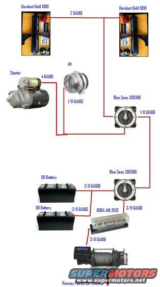

well here was my fun...
and a bigger one that you can most likely read better...
http://www.supermotors.net/getfile/891689/original/wiring.jpg
