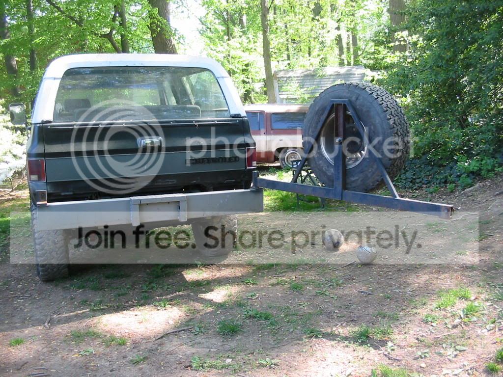

When it broke off I didn't even know what happened. I thought it was the cargo in the back shifting around. Somebody behind me was honking and trying to get my attention. I thought maybe the clunk had been his car hitting me. So I got out and looked at his car - I wasn't even afraid for my bumper. "Hey your tire fell off and it's laying in the road". I turned to look and...:eek1::eek1::eek1:
BTW, it's hard to retrace your steps on one-way streets.
The welds on the wheel mounting plate broke and it's still mounted to the wheel. A couple things on the carrier are bent, but all the tubing is fine. There is a stop pin on top of the bumper that keeps the carrier from opening too far. It worked with a 35, but it lets a 37 touch the sheet metal. That pin is really tweaked, but there isn't a mark on the truck, so I don't know what trajectory it took. I'm just glad it didn't go through a window or get lodged underneath a dump truck or kill somebody.

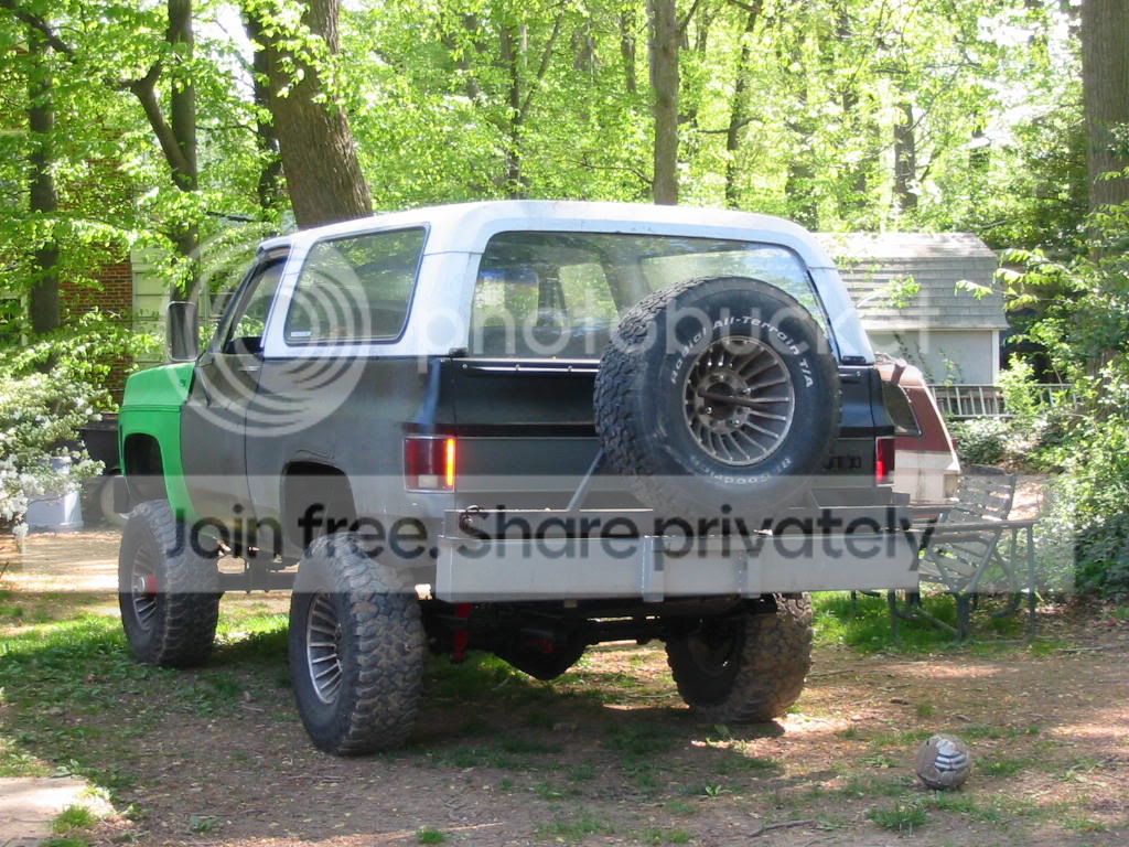

Her's my swing away,pics are a couple years old,

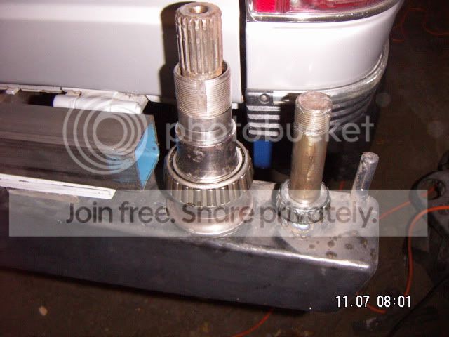

Here is a sneak peek of my new solution.

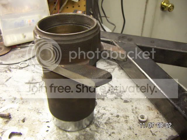

Here you can see the machining I did to the hub. I thought leaving those little ears on would make for a stronger weld.
Here you can compare the trailer spindle to the 10-bolt spindle:
