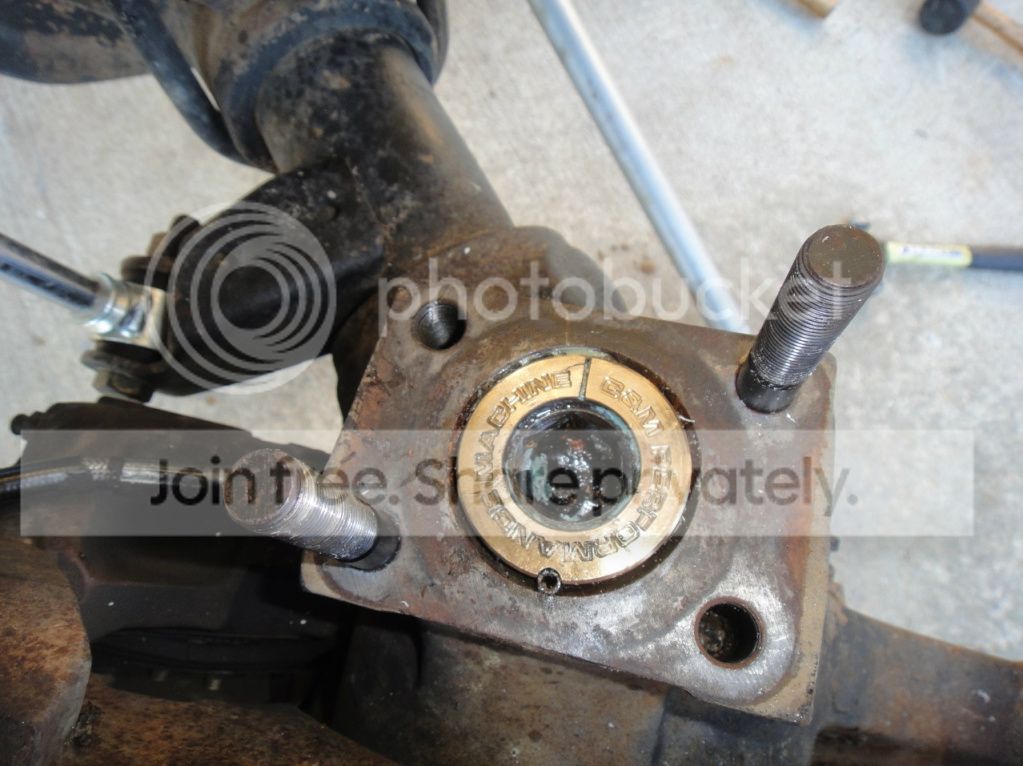

The death wobble has been rearing it's ugly head again lately, so I figured it was time to re-set the king pin preload on the ballistic fab springless arms. I haven't touched it since the initial install a year or so ago. Headed over to a buddies place to use his driveway. Should be a pretty simple job right? Of course not. :doah:
And just for shiits, the bronze bushing-
I broke it with a 3/8" allen socket on a 3/8" ratchet. Almost zero torque was required to snap it. So little that I sat there lookin at it like a retard for a few seconds wondering wtf had just happened. That's a 3/4" diameter, fine thread set screw. :eek1: It looks like it's been broken/cracked for awhile though...but still...wtf?:confused:

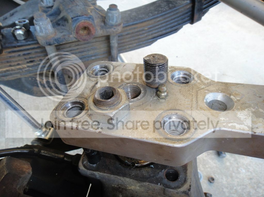

Fastenal didn't have a 3/4" fine thread set screw on the shelf, but they did have some grade 8 bolts. It looks kinda goofy with a big ass bolt sticking out of the steering arm, but in the long run a lot stronger I think. No more death wobble either. :pimp: Maybe one of these days I'll order an actual set screw...maybe not. :whistle:

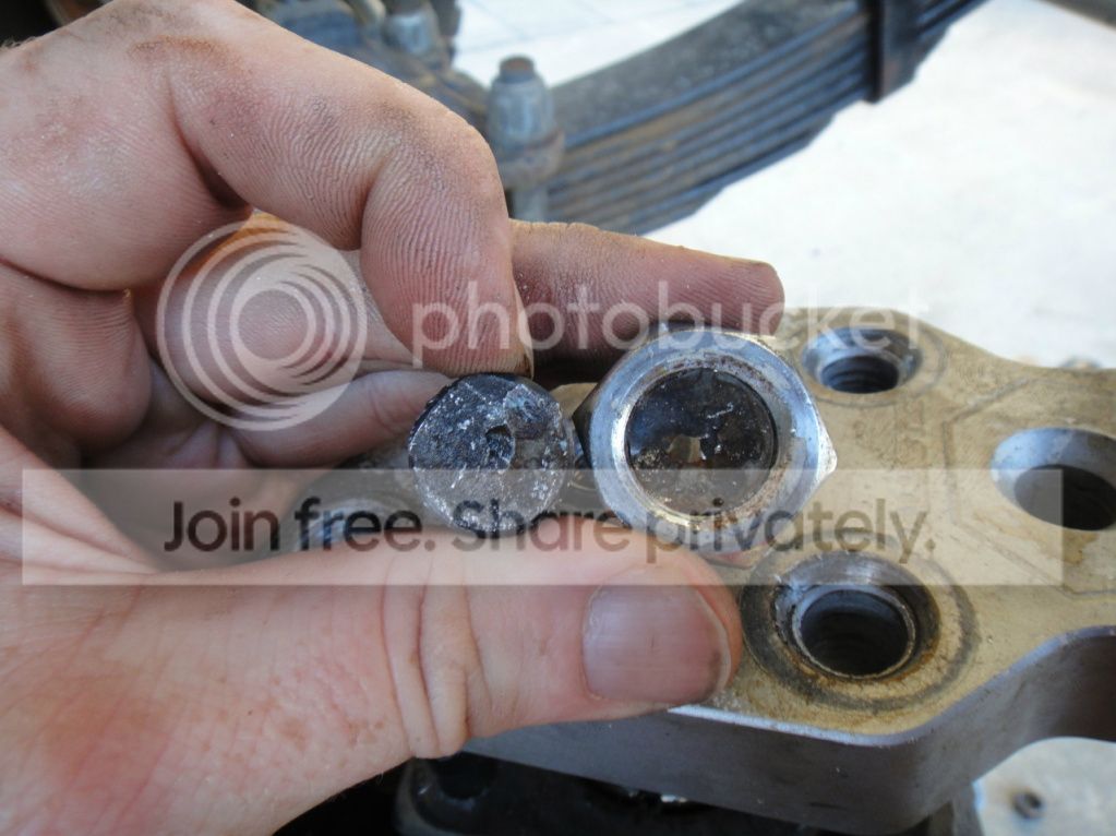

I was looking at it closer with the Fastenal guy this morning, judging by the hole in the bottom of the smaller piece, I'm starting to think a bit of water/mud/whatever got in there and just sat there, and rusted...and rusted...you get the idea. You can see a "ring" of rust around the hole. Fastenal guy pointed it out. Interesting theory. I'll post up some pictures of it later tonight.

I got a PM over on Pirate asking for some high res pictures of the set screw, so here they are. Click for full size. Click again for full, full size. :eek1::haha:

judging by the rust and clean metal area that screw was defective for a bit.
i have seen a lot of breaks in my time and thats a clasic widow maker that missed you.

You're definitely right about it being cracked for an extended period of time.
The clean, black spot in the middle of the first picture is part of the bottom of the hole for the allen wrench. The shiny part is just from me dicking with it after the fact. And even if the top part of the set screw and jamb nut had actually popped off, there wouldn't have been any kind of catastrophic failure due to just that. The bottom half of the set screw was still in there and the steering arm itself was still securely held on by the studs and nuts. I just wasn't getting any preload on the king pin. Made for the worst death wobble I've ever experienced...started at ~20mph and continued all the way down to less then 5mph. :eek1:
